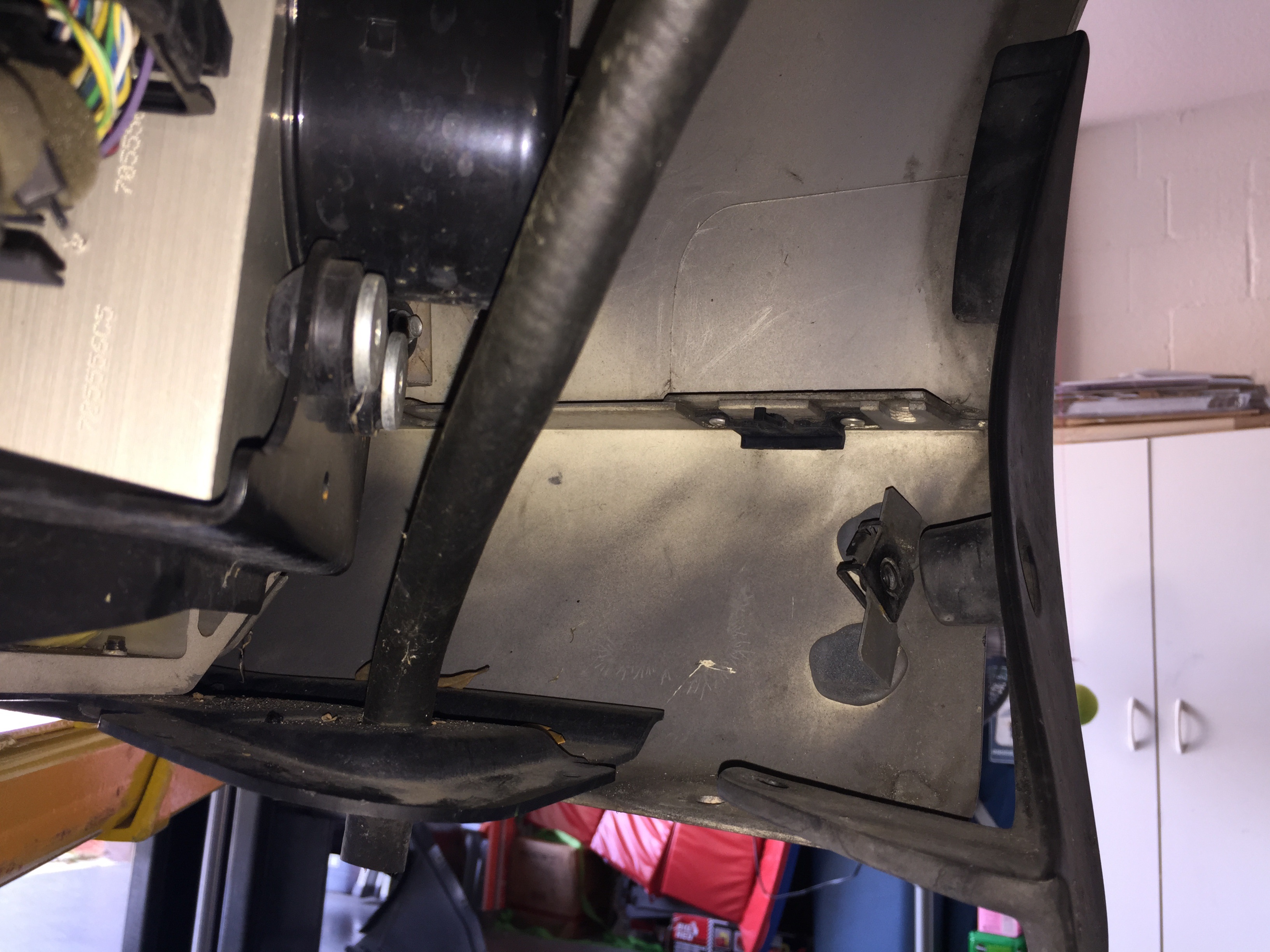

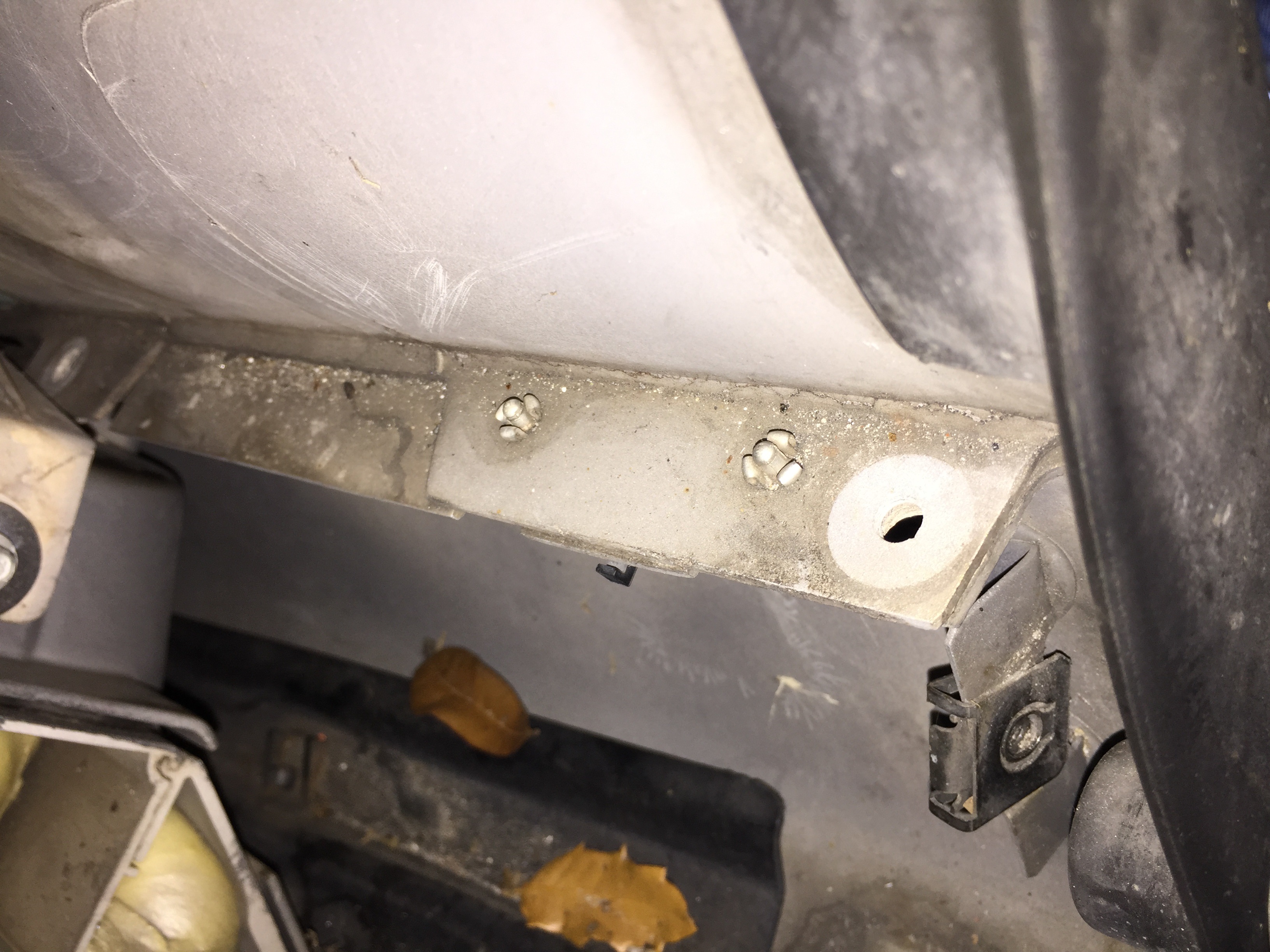

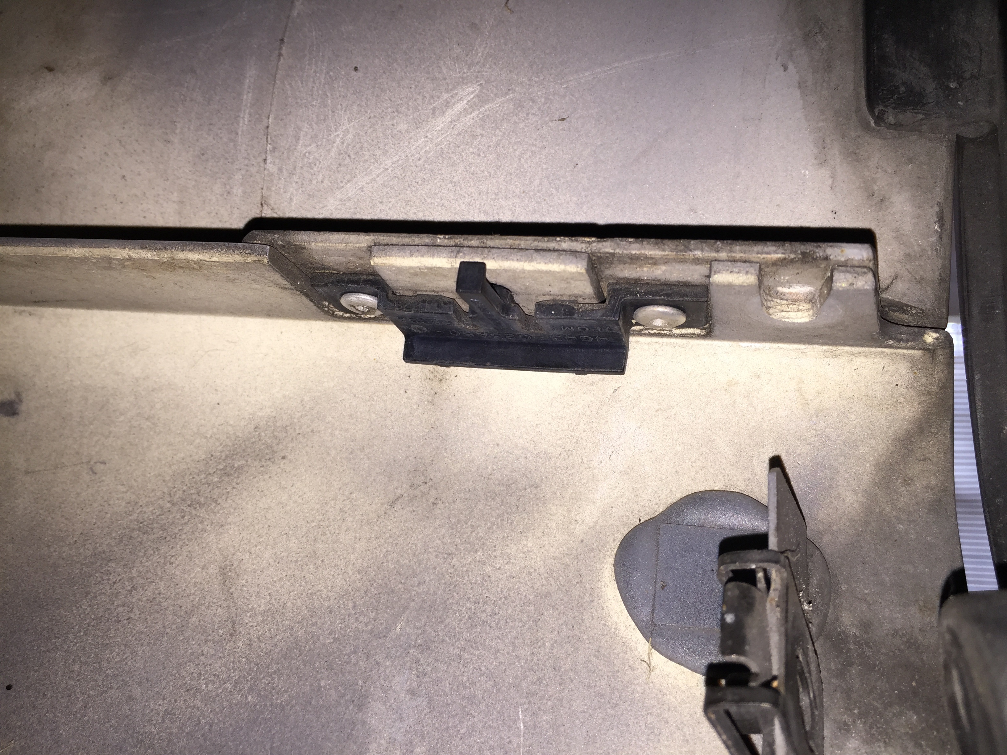

Part in question is item number 7 in parts diagram and I have attached few photos of problematic area as well

this are the pics of problematic area

The rivets in the middle picture are called "pop" rivets. They are very easy to remove and install. I just replaced my door air struts a few days ago, so I'm familiar with that part of the procedure. I'd suggest just removing the air struts as part of the work needed to get the doors off which is a two man job to safely lift them. I'd further suggest replacing the door air struts as long as they are off. The new ones on my car made an amazing difference.
If you look at my thread about replacing the front grille frame that I started yesterday, you'll see that I'm quite concerned about how to get the ends of the frame out from behind the fender. Since we live close by, I've got a pop rivet tool and a selection of pop rivets I can give you. I've also got a special long screwdriver that makes easy work of the strut removal and I can help you lift the doors off. In turn, i'd like to get a better look at what I'll need to do to get my grille frame out from the fender area before I start tearing the bumper off my car.

Nooooo. No need to remove rivets. Simply pull down on the black clip and the other half should slide out with a small tug. The rivets just attach the bracket that hold the clip in place. The clips usually have a small "pin" that secures into a hole on the tab on the other panel.

Yup I have spent like 30-45 min and was able go get it loose but I think I will have to remove whole bumper to get this front fender out.
