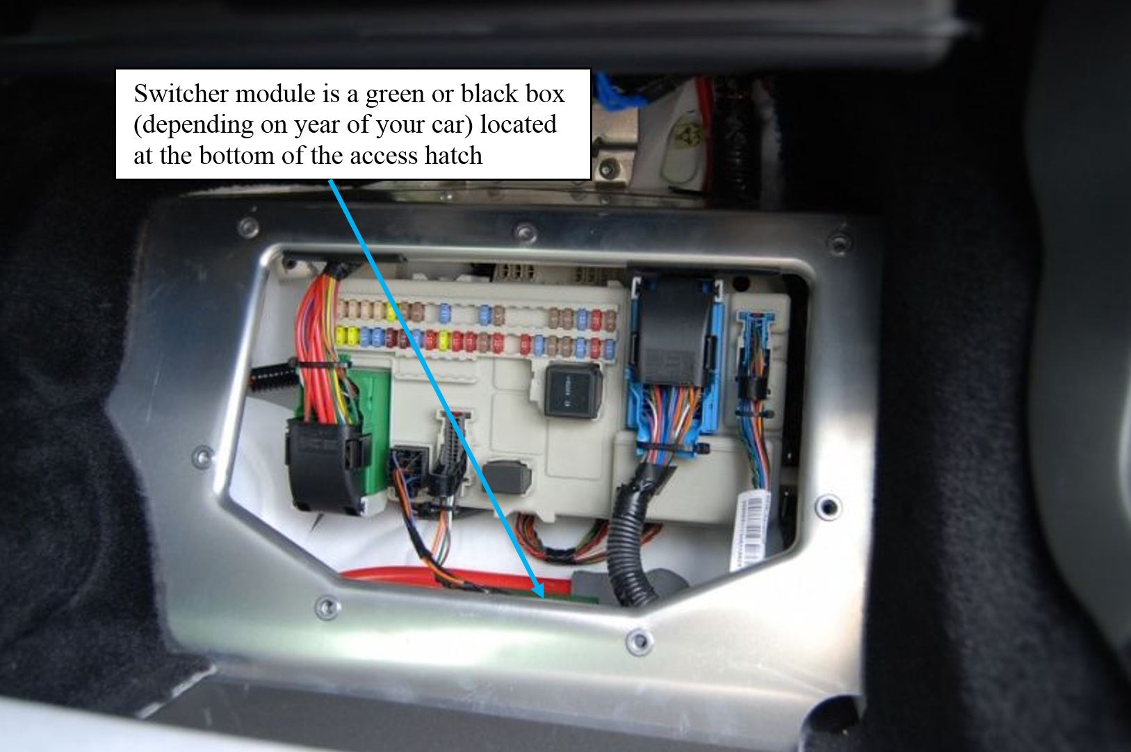

The switcher kit is behind a panel underneath the carpet on the passenger-side floor, pull back the carpet from the top of the floor under the dash and the panel is held on with about 8 torx screws. Easy to get to. I replaced mine last week because my stereo quit working due to a failed BT switcher.

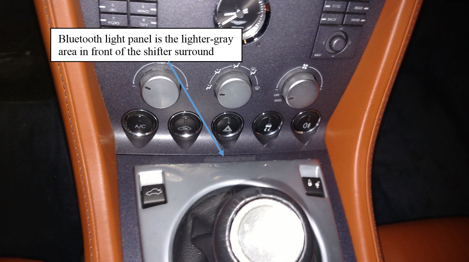

The light module is located in front of the shifter surround on the center console.

@Jeff where is exactly the switcher kit in the fuse box :
And where is the light module on the center console :

Hope this helps
