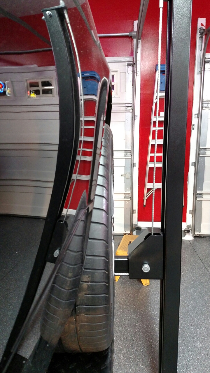

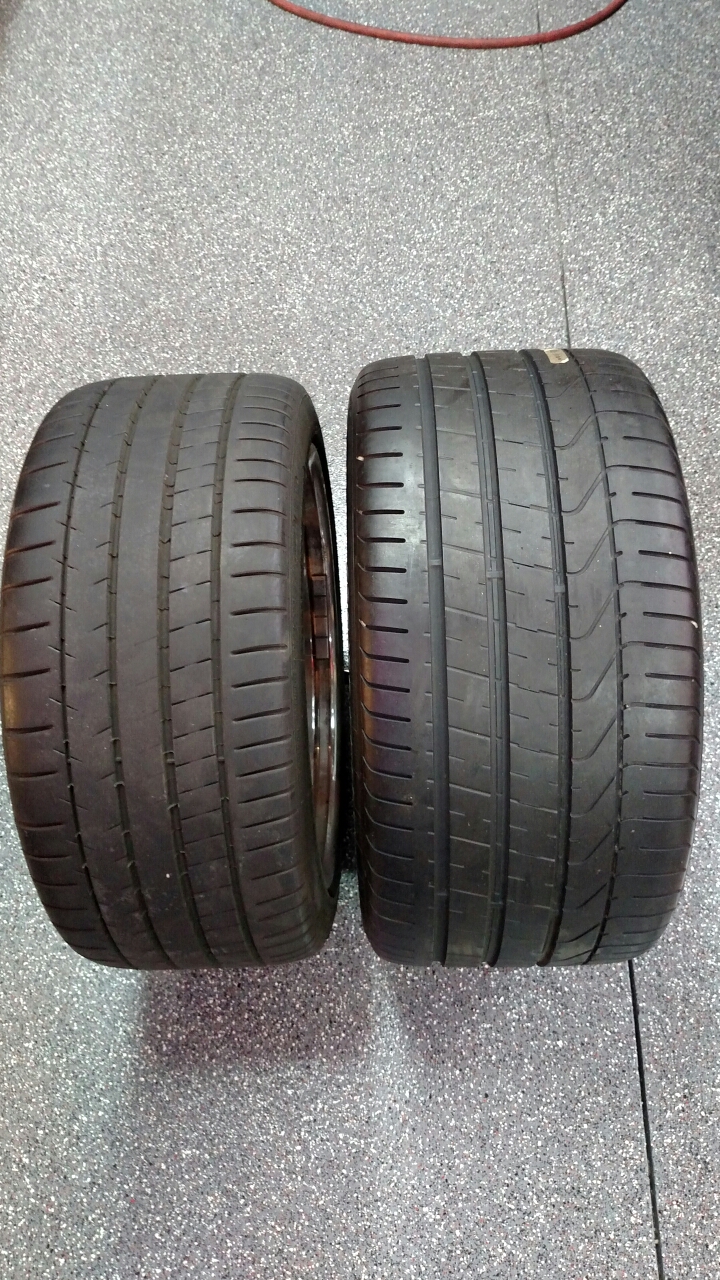

The DBS wheels will physically fit. I bought a set to try on my 05 DB9 but they look pretty ridiculous IMO. I think I have a picture of them on a DB9 somewhere.. I'll see if I can find it.
Otherwise any 19" V8 Vantage or DB9 (through 2012) will fit like your oem wheels.

Here are a couple shots of the DBS wheels. You can really see how much bigger the rear tire is compared to the DB9 stock size tire.. Also notice how far it sticks out of the wheel opening. I know it's been done before but I hated the way it looked.. Just way too big.
