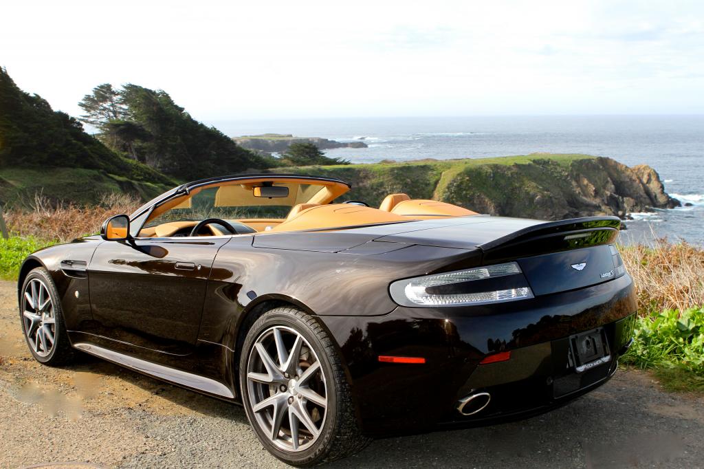

Originally Posted by Zettinger
How is the ride now?
Your picture is the first VAP spring I see with Sport Pack wheels what seem to change the fender gap.
From google pictures, I like the H&R drop but what I read here the ride is terrible with Sport pack suspension.
what is this Pogo effect?
What I understand it bounces but when a shock doesn't do it's job, It's a bad shock?!
I really like it. No pogo effect at all. I'd like to see more '09 w/sport suspension on VAP springs as my car seems to be lower than any other Vantage I've seen with the same springs.
Thank you for the feedback!
Could you share some updated picture with closer capture of the fender/ tire gap please.

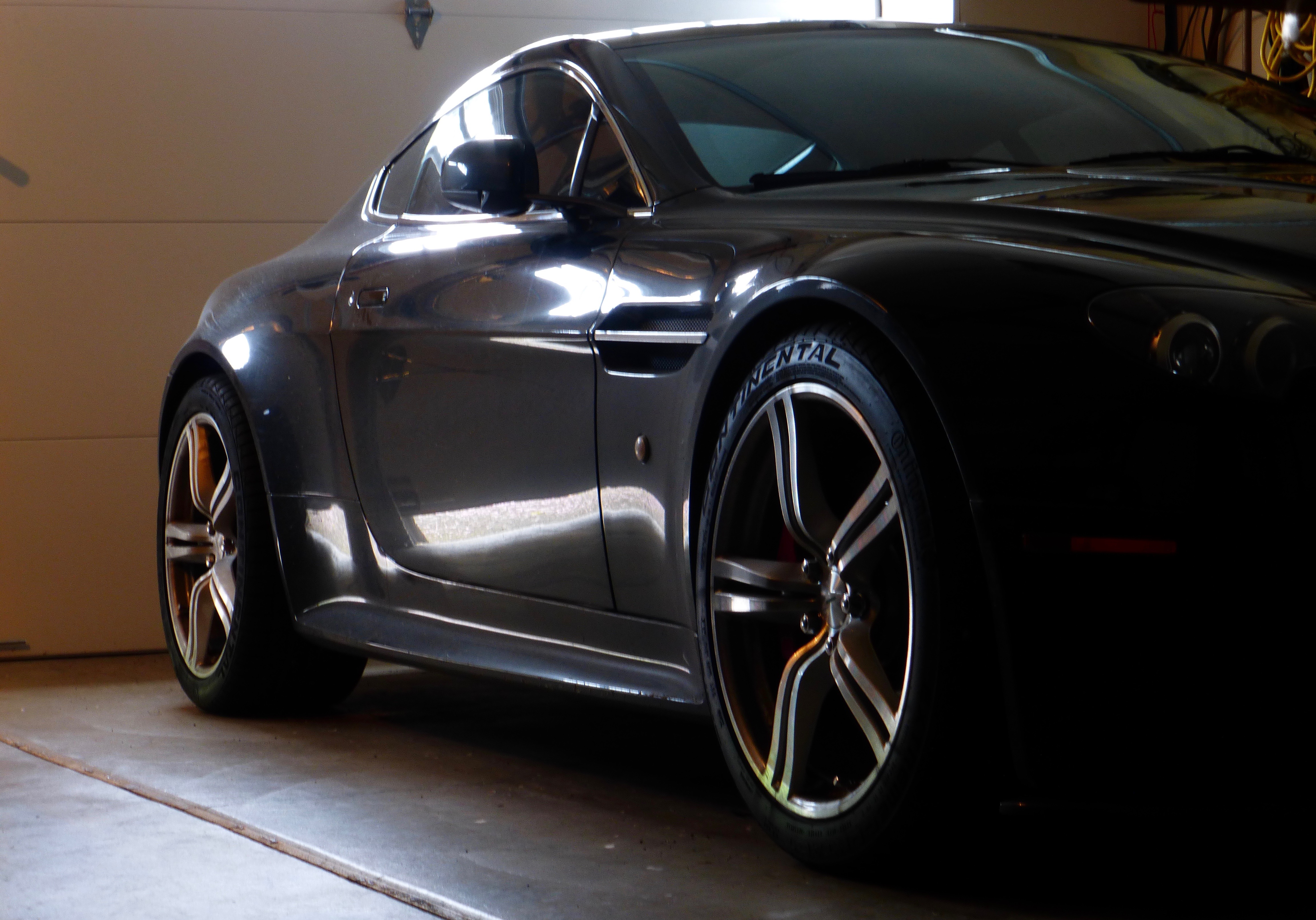

Here is a couple pictures with the new springs. Before and after. Also changing from stock 19" wheels to 20" wheels with a better offset.
Before
After
Before
After
Thanks for sharing.
Beautiful car!!
Did your Vanatge come with Sport package suspension?
Do you have a picture with the 19" and VAP springs?

Because mine is the S model I believe it comes with the sport suspension. I had the wheels and springs done at the same time so no pictures with only the AP springs.

I'm on the fence.
From the pictures above, my stock Sport pack Vantage sits pretty much at the same height.
I met my car buddies last night and 2 out of 5 thought my Vanatge sits lower than this:
Do we have other lowering springs options besides H&R (don't work with Sport pack) and VAP (not lower than stock)?
