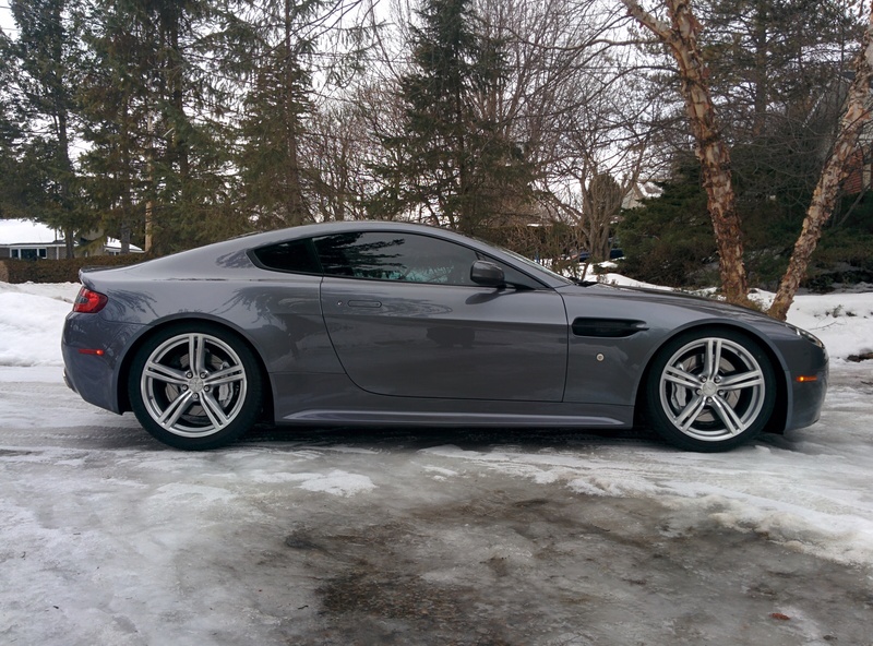

VAP springs on sport suspension, 2009 V8V:
Can't tell for the ride, I have not driven it since installation...
Old Mar 12, 2016 | 01:31 AM
mantonkroh's Avatar
Joined: Dec 2013
Posts: 76
From: San Francisco
Rep Power: 16
mantonkroh is infamous around these parts
Beautiful stance! Thank you for posting and info.
How is the ride now?
Your picture is the first VAP spring I see with Sport Pack wheels what seem to change the fender gap.
