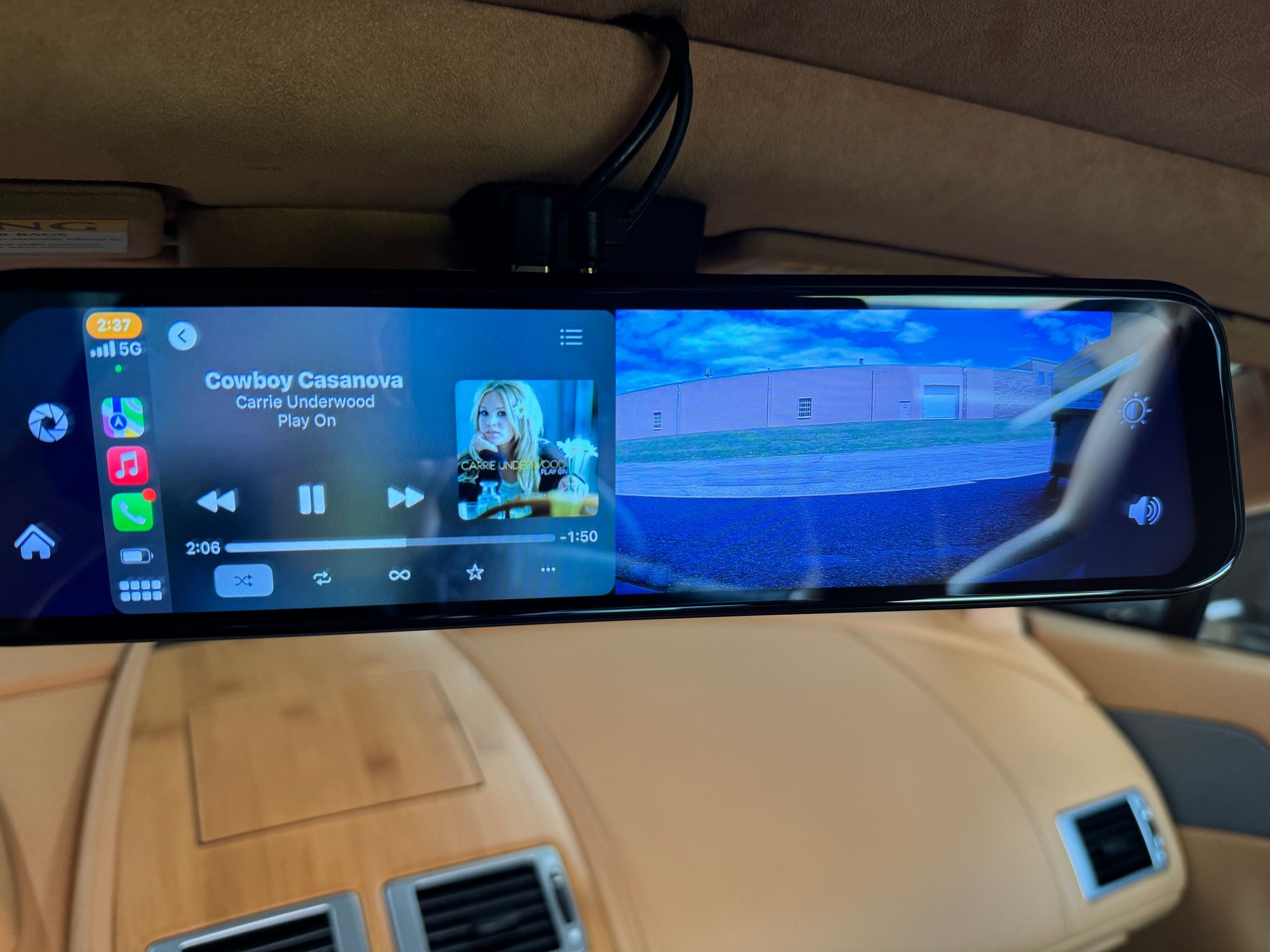

I use a smart mirror with Apple Car Play instead of the cars map
I have a 2011 V8 Vantage and instead of the pop-up screen, for $150 (and $500 install of the wiring and reverse cam) I use my CarPlay maps - these mirrors include the dash ca and other features. I use Google Maps and Waze

Prefurbia..what model is that if you remember,..cheers

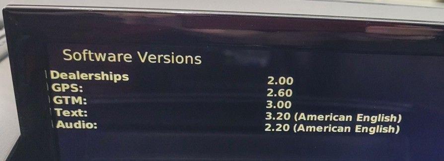

I bought the 010-11551-01 maps. My SD card slot was empty. I installed it, went to the maps/info screen and it is not listed. Tried it with the key in position 2 and also running.
If you don't mind me asking... What versions of software do you have?
* Software Version 3.20
* Dealerships 2.00
* GPS: 2.60
* GTM: 3.00
* Text: 3.20
* Audio: 2.20
