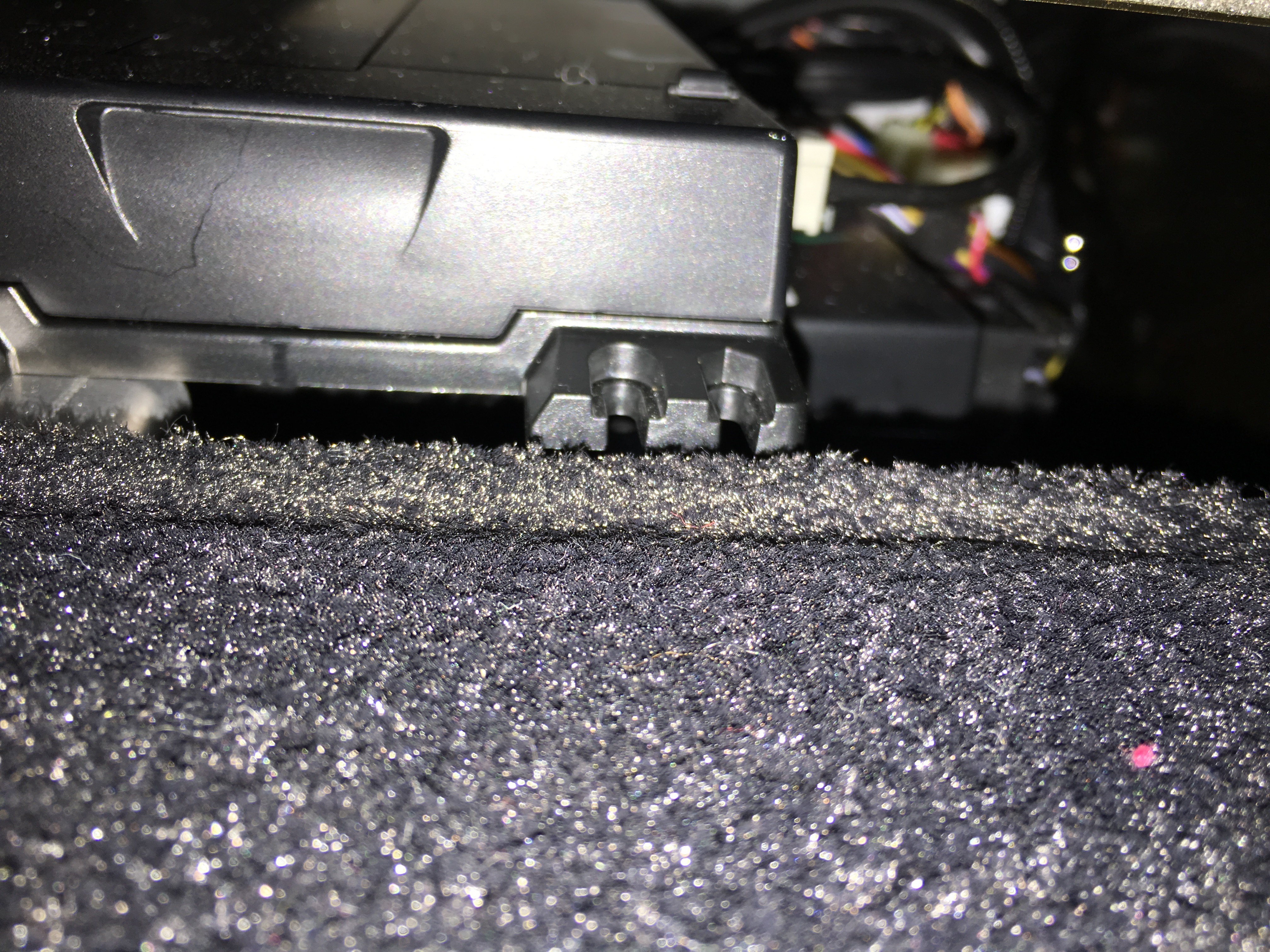

I am looking for the location of the slot in the 2015 DB9. Can you post location of the slot in your car ? Maybe a zoom out pic .. Thanks !

Your navigation unit in under the sub woofer under the left rear seat. The lower carpet at the kick board pulls off easily.

You mean the heel board behind the driver seat ? I pulled off that board and saw this.Couldn't take a clearer pic. Where is the SD Card Slot ?
I am asking this so I could get latest SD Card from Garmin (as posted in this thread) and stick it in there. The last time I let the dealer do it, I paid $200+.

That's the unit, the front panel pulls out and the SD card slot is in the middle.

Got it ! Thank you very much !
