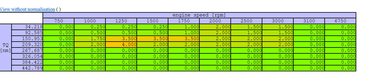

Here is the base EGR table in a US '07 AMV8. Gives %cylinder mass from exhaust based on RPM and driver TQ request. There are table mods for variable cam, coolant temp, intake temp, outside temp, startup delay etc. The PCM has a flow model based on the Differential Pressure Feedback EGR (DPFE) sensor so it can accurately control % combusted via Electronic Vacuum Regulator (EVR) which controls the vacuum driven EGR valve
