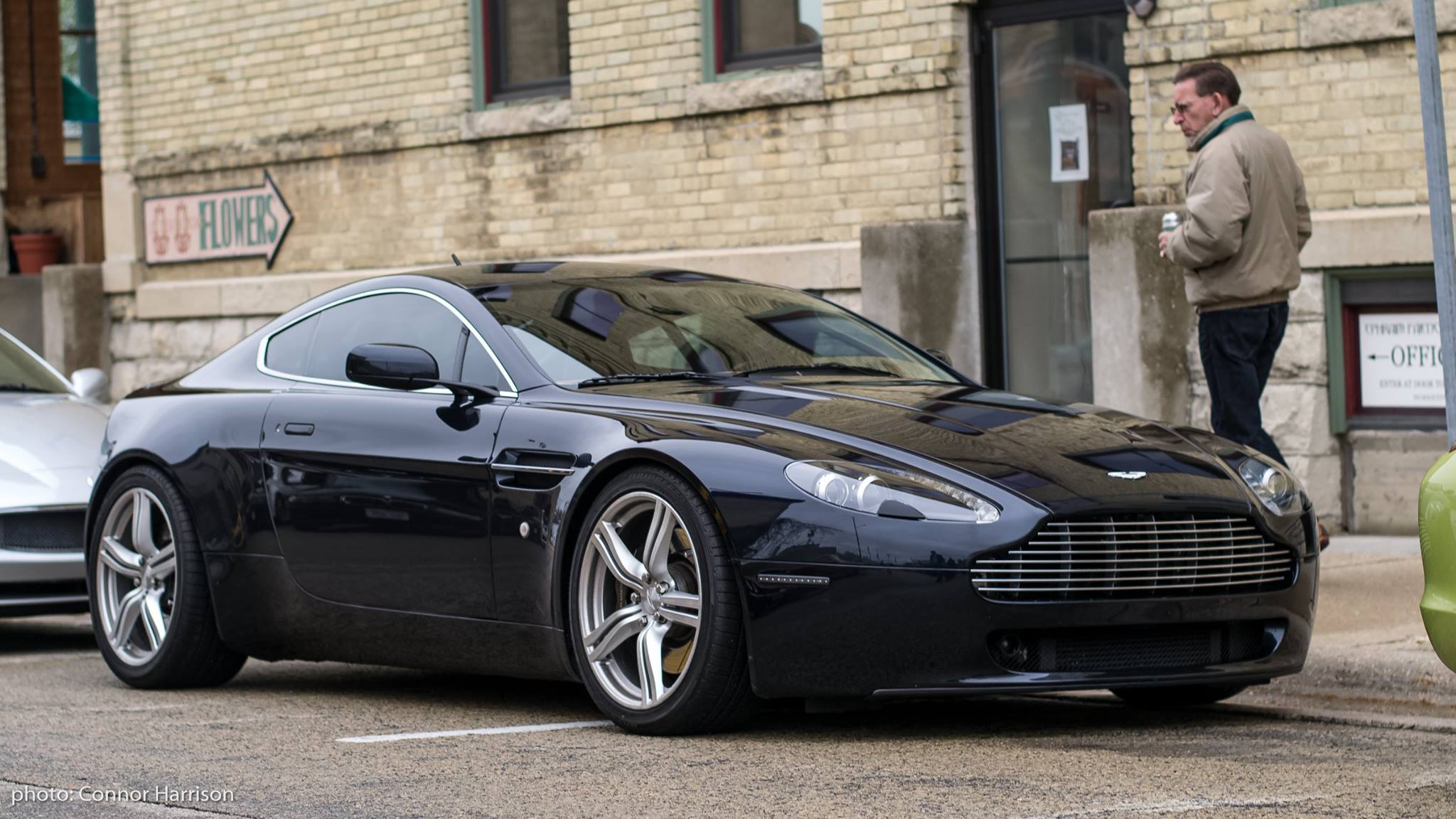

My 2007 Vantage is lowered on H&R springs and has the RSC spacers and studs, 15mm in front and 20mm in back. They were on my car when I bought it so I don't know how difficult they are to install.
That is perfect! Your car looks amazing.
