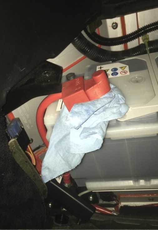

I DID find a useful nugget to this masochistic process should you choose to punish yourself for good sport. In the picture attached, there is a panel screw above the + marking on the battery sticker (upper pict middle) Remove this and it will allow you (with great effort) to pry the lower part of the panel out far enough to slide off lower clips. (use a star drive wrench to loosen the screws). Its still a mother of a job. Note the clamps sliding off lower left of the picture.
You also have a very exposed positive battery lead right in this area... suggest concentrating on the order of operations... disconnect battery first.
BTW I bought the Duracell SLI49AGM locally in stock from the Batteries Plus store. $200. Fit perfect.... once you get the old one out!

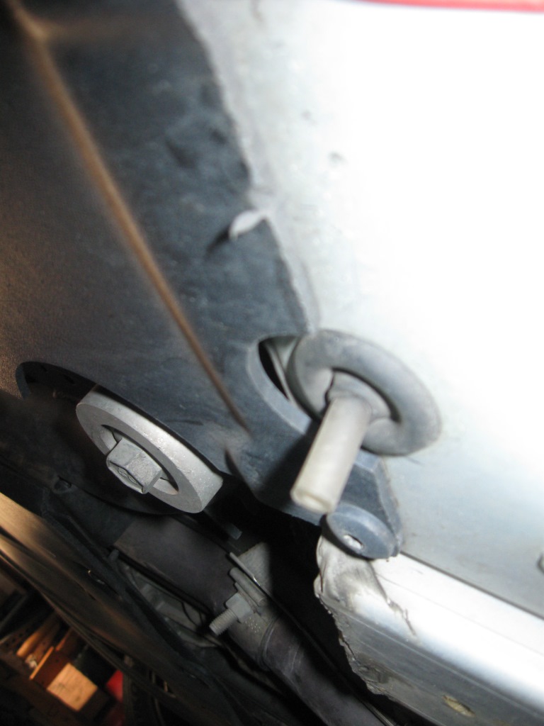

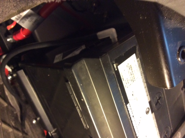

Hi - midst changing out my battery. As you can see the vent tube is connected at the battery positive side. Can't figure out where the end of the vent tube was connected at the other end from the battery - It seemed connected when I was lifting out the old one. Can someone tell me where the hose end connects.

The other end of the vent hose goes through a grommet, and exits the cabin through the floor to the outside of the car just in front of the rear wheel. I replaced my hose when I replaced my battery.

Sorry I'm no help - I left the other end of the tube wherever it was and didn't pay any attention to that end of the plumbing. Presumably, the tube passes through a grommet to the outside of the car, of course, so that any acid would drain outside.

DonL - thank you so much. Once you posted that photo I could see the outlet grommet under the car and knew where it was meant to exit. I found it easier to feed the hose up from the outside to the vent than try to get at it from above.

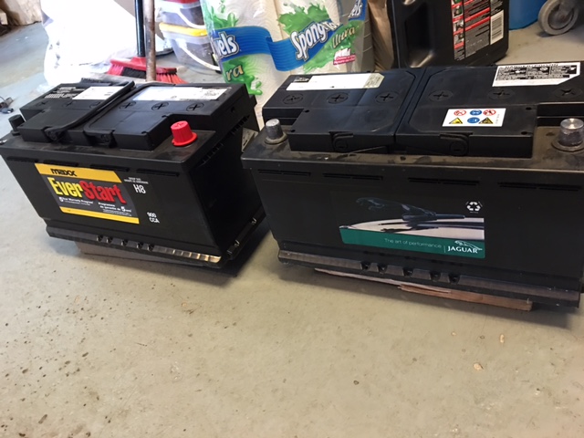

What a job to change a battery. Died overnight without warning. Anyway done now. Just thought I'd add - I live north of Toronto in a small suburb town - not a lot of choice for auto parts on a Saturday afternoon of a long weekend. The battery I was replacing in my AM had the Jaguar logos on it and fit pretty tight. 13.9" x 7.5" x 6.9" (LxHxW) I recall from my BMW days though that batteries just get labeled and the same factories make them for many different clients, so I took a chance and tried the two big box stores near my town (Canadian Tire and Wal-Mart).
Cut long short - no luck at the first one but the exact same battery that was in my AM was to be had at the local Wal-Mart. When I say exact - I mean exact. The only thing different are the labels. It is the exact spec. cast from the same mold.
Cost was $152 CDN (about $112 USD)
