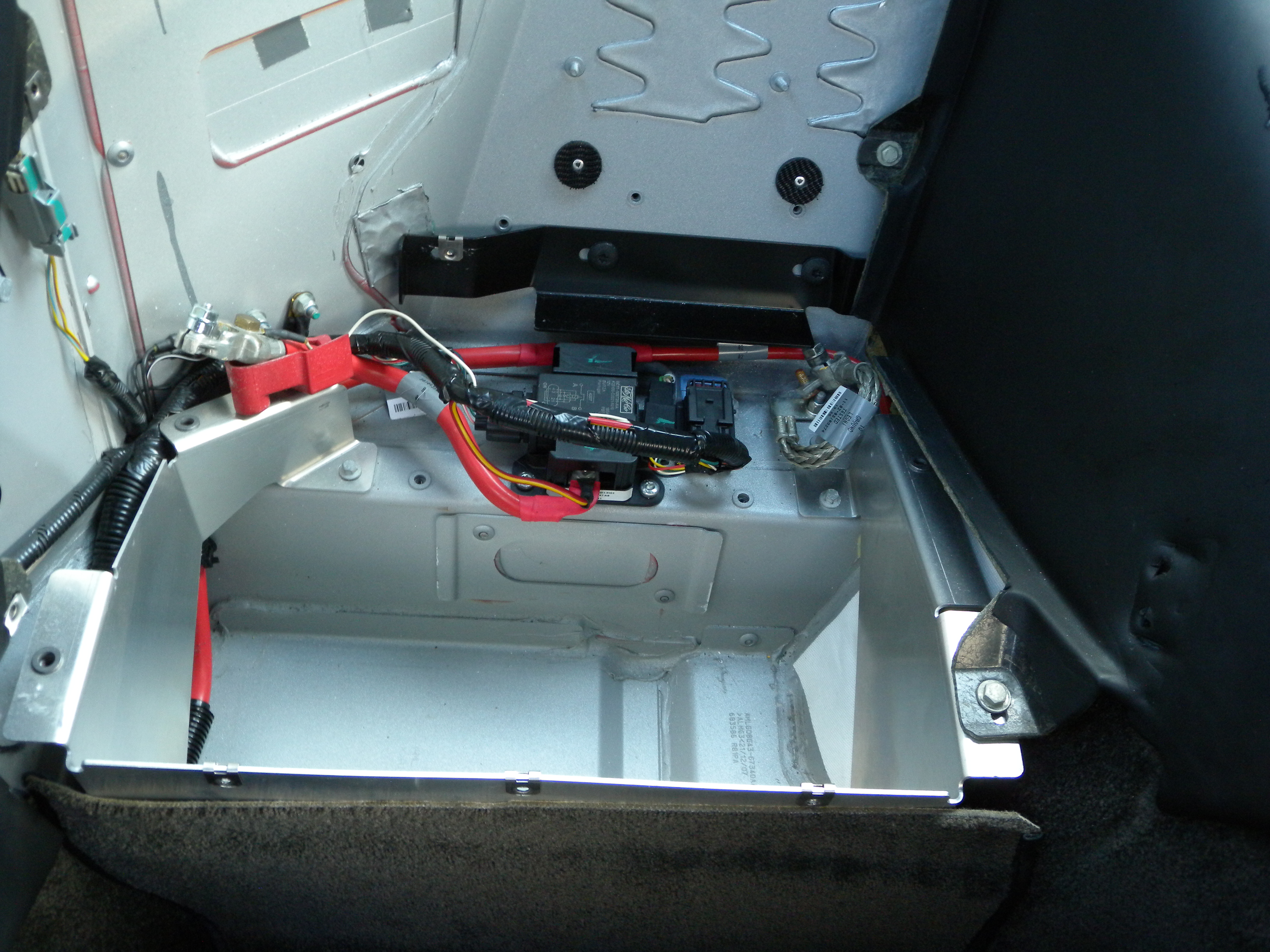

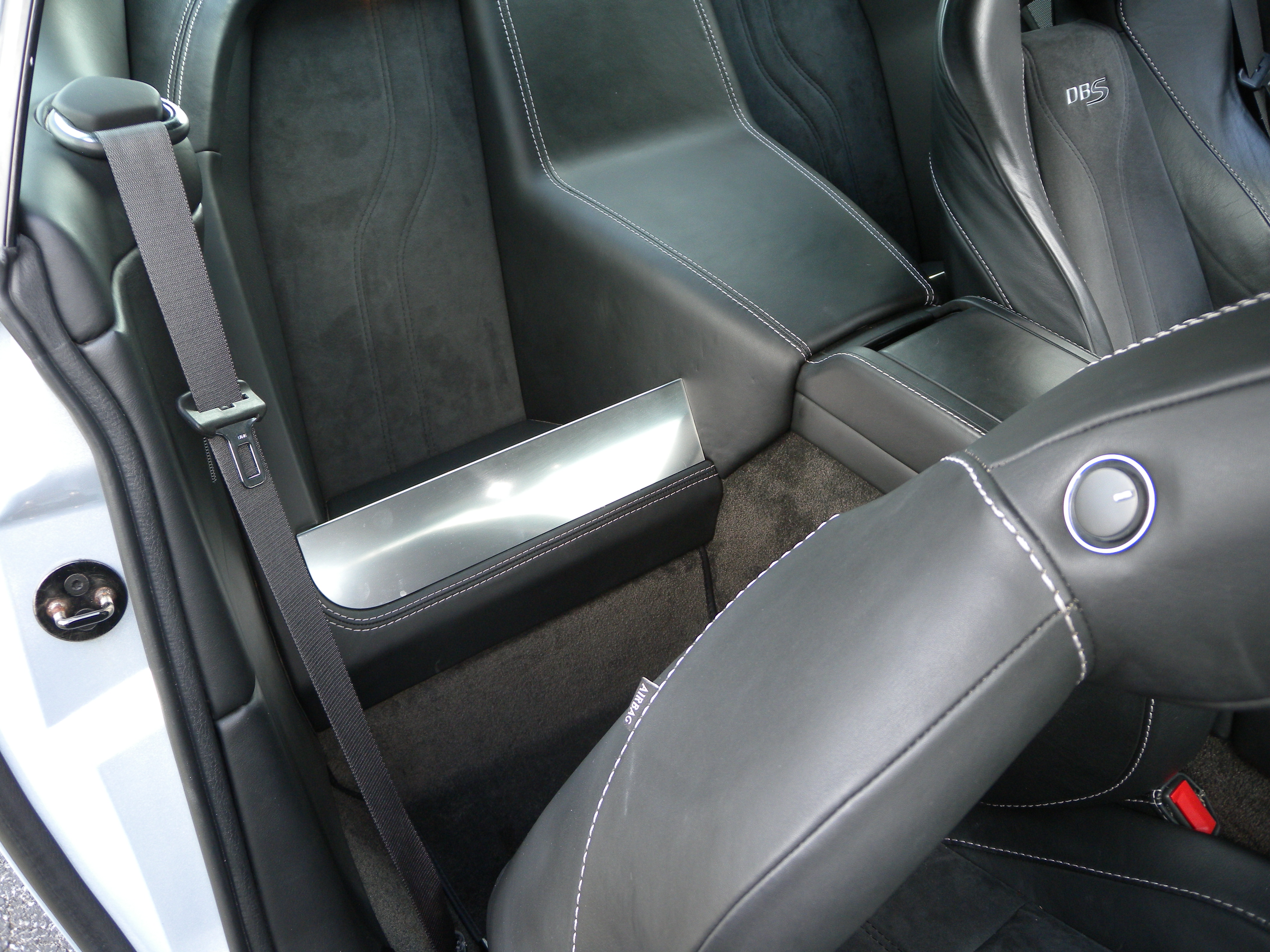

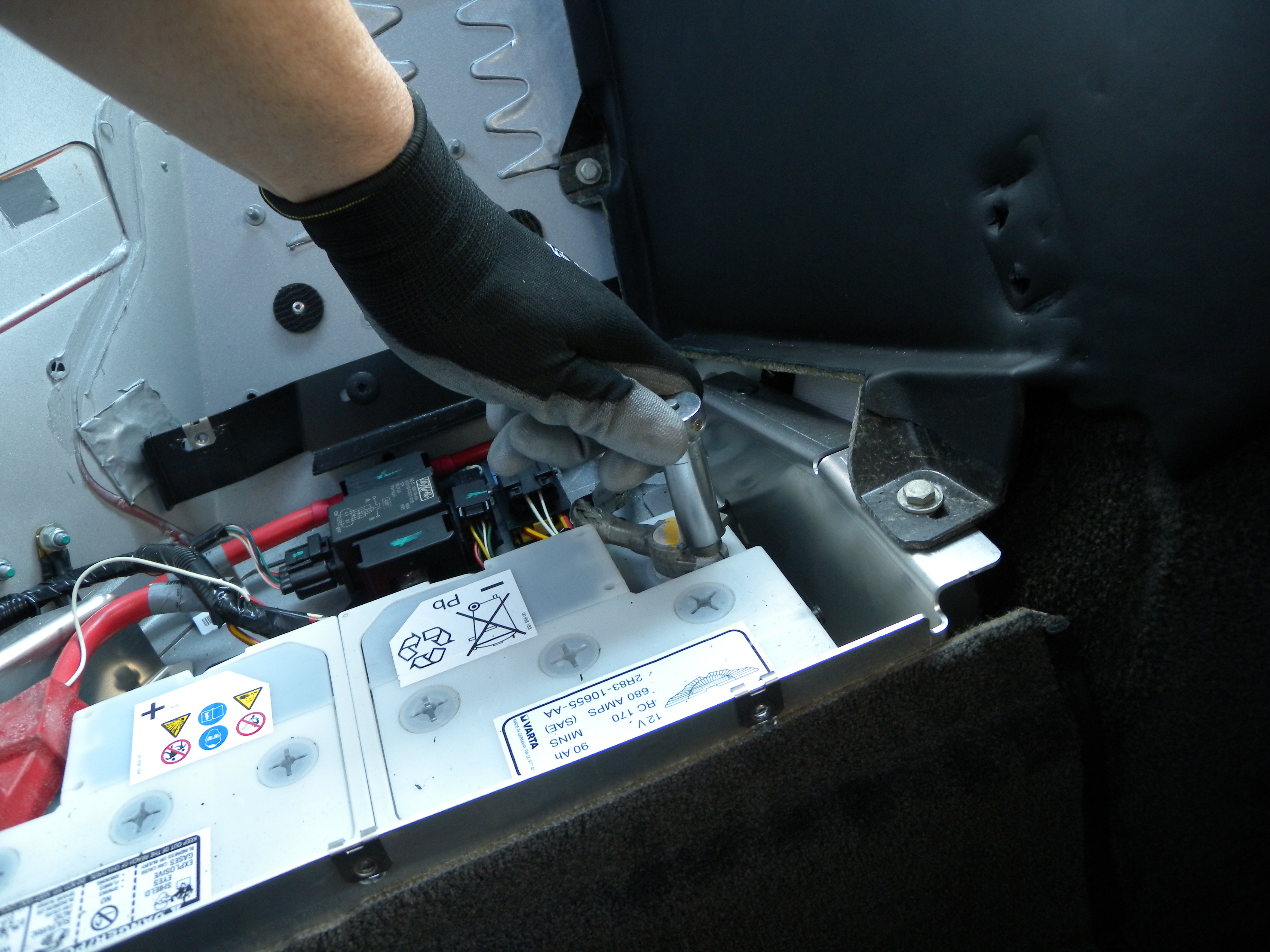

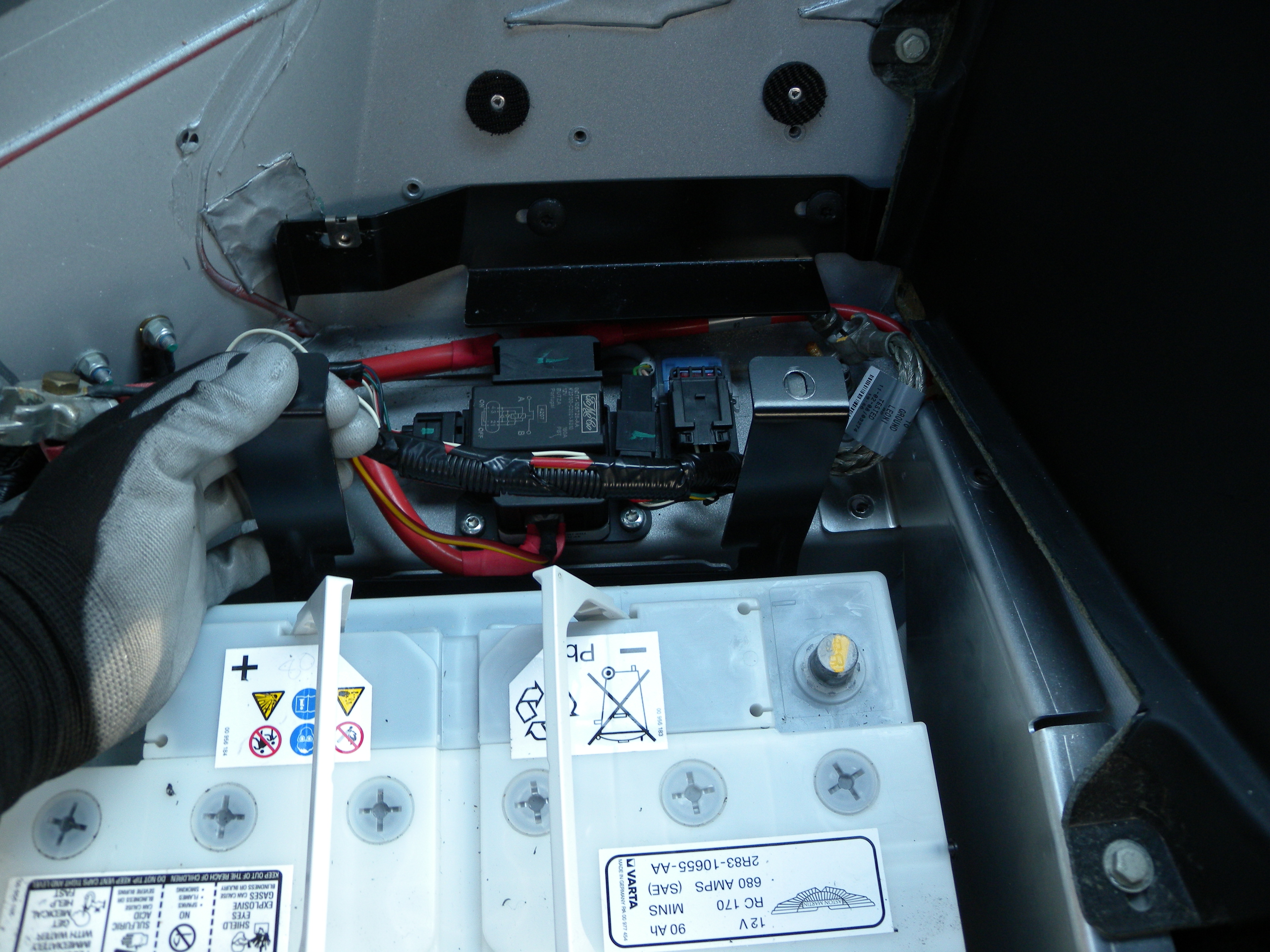

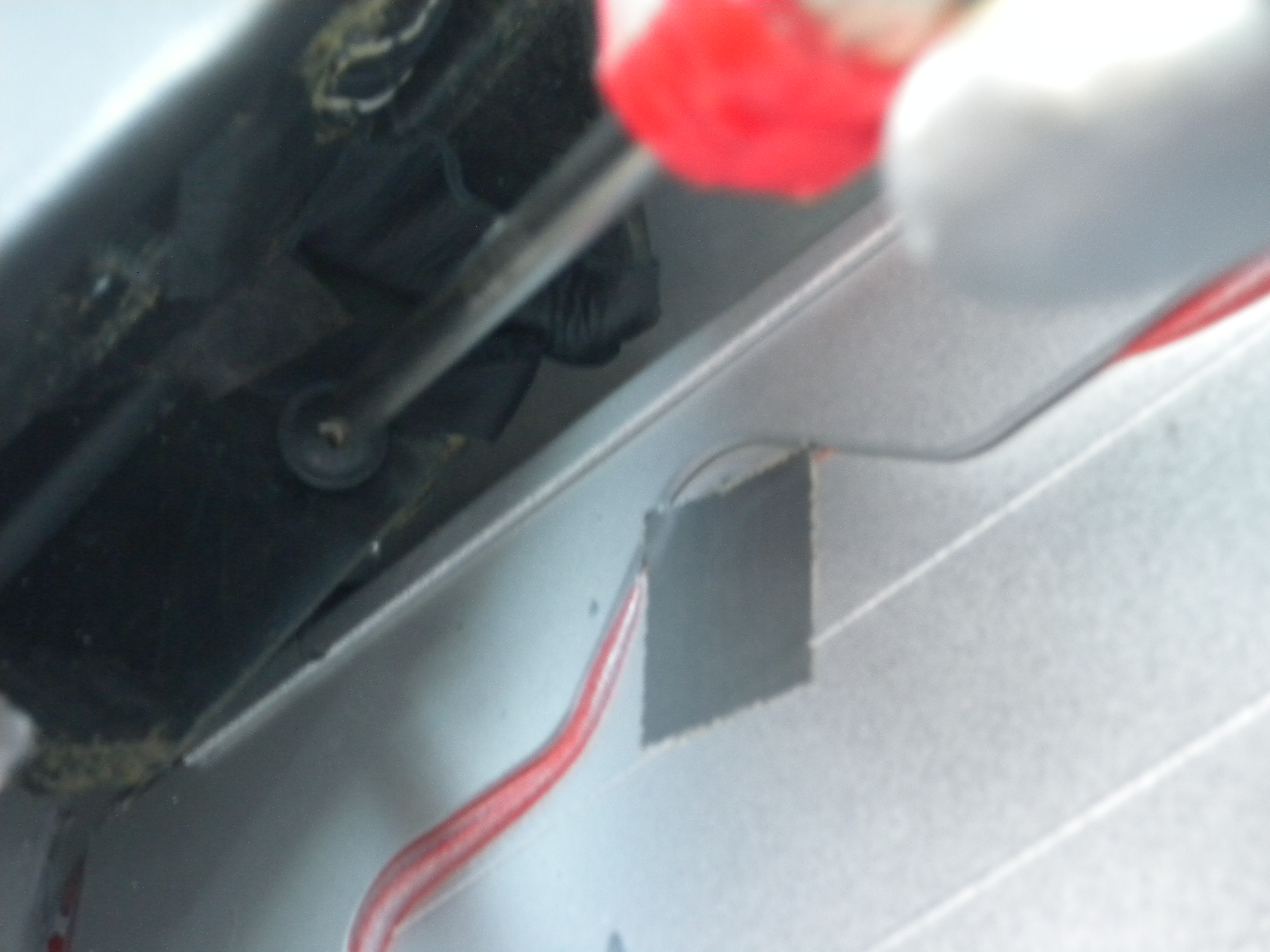

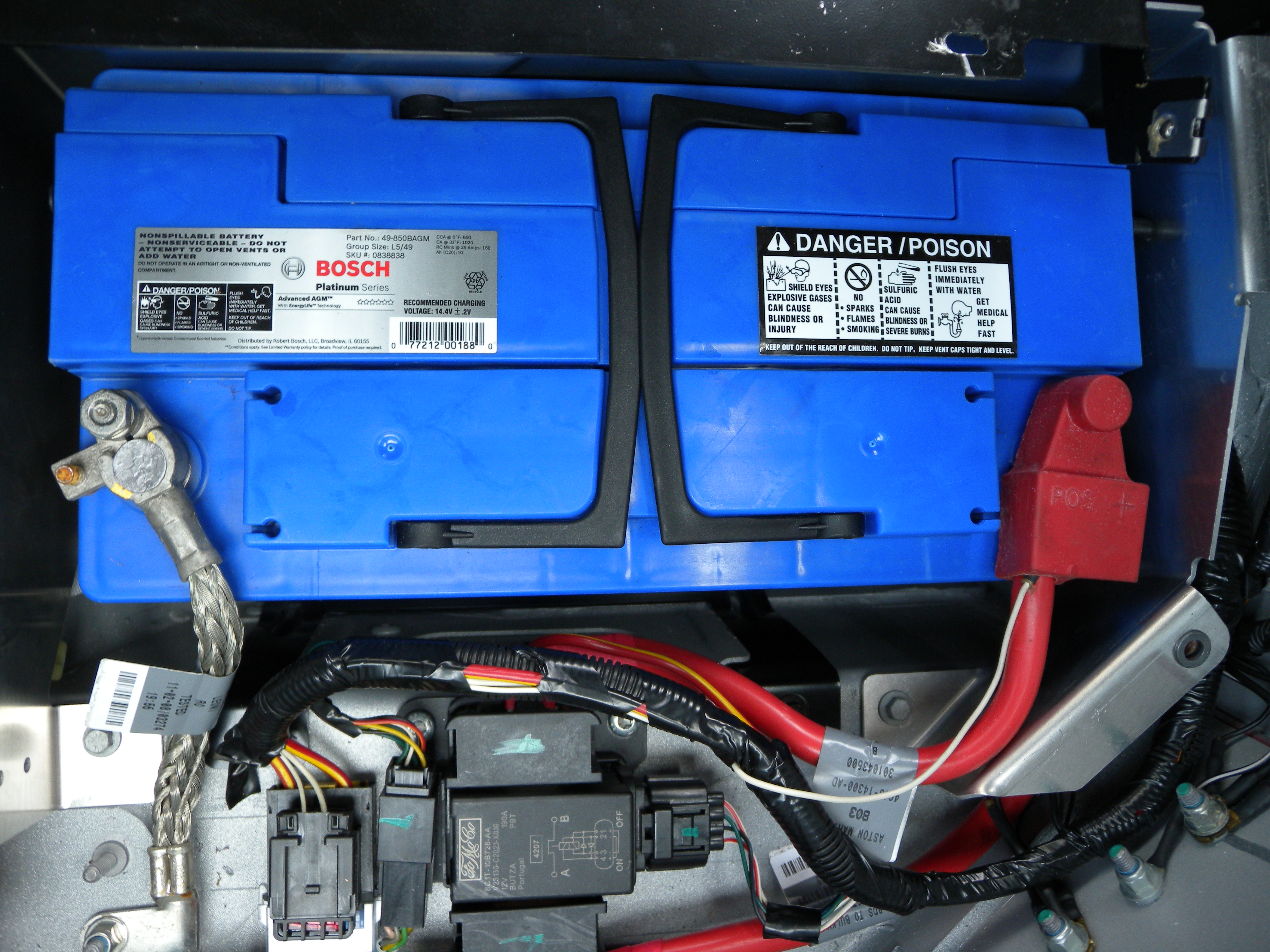

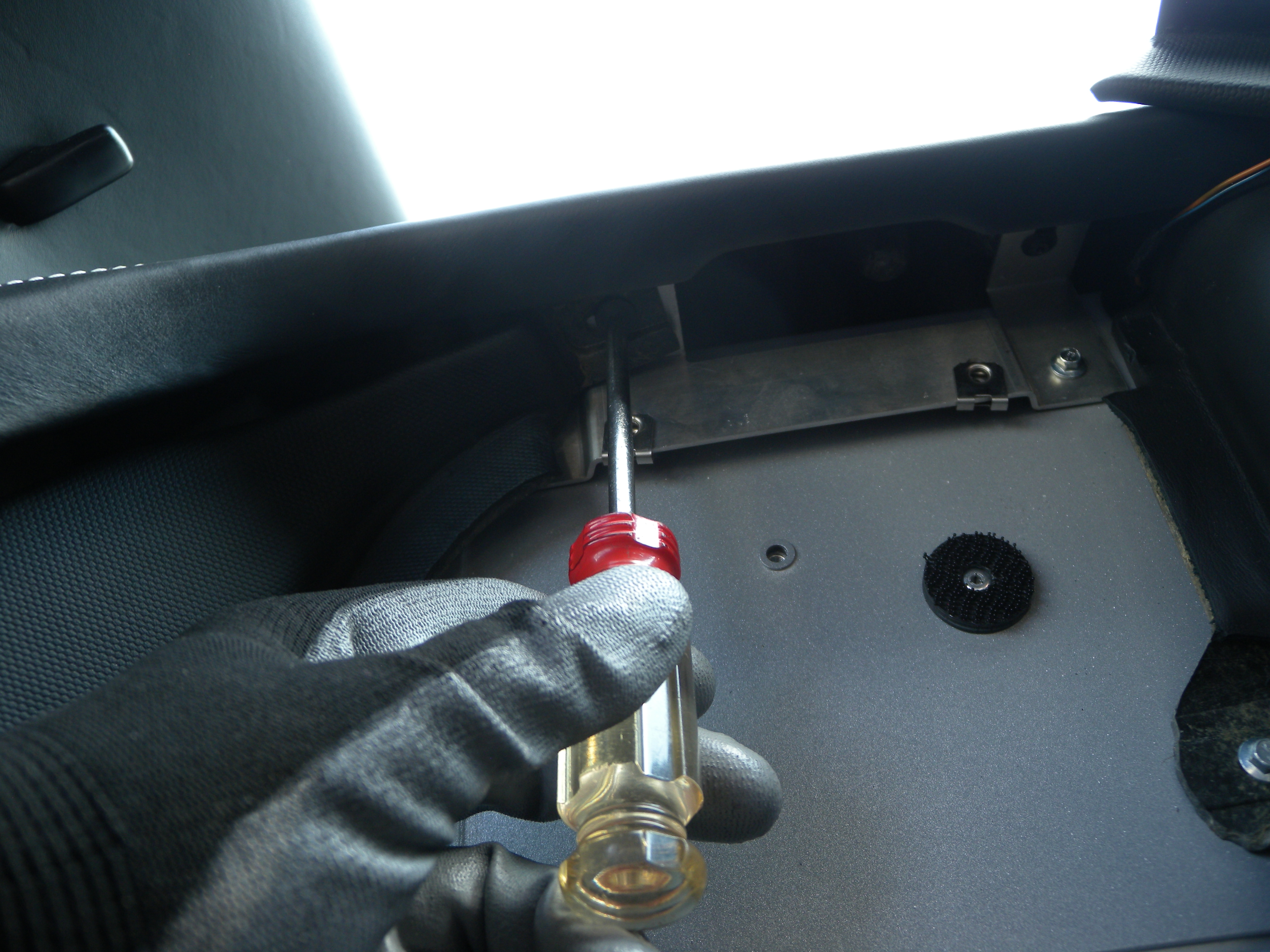

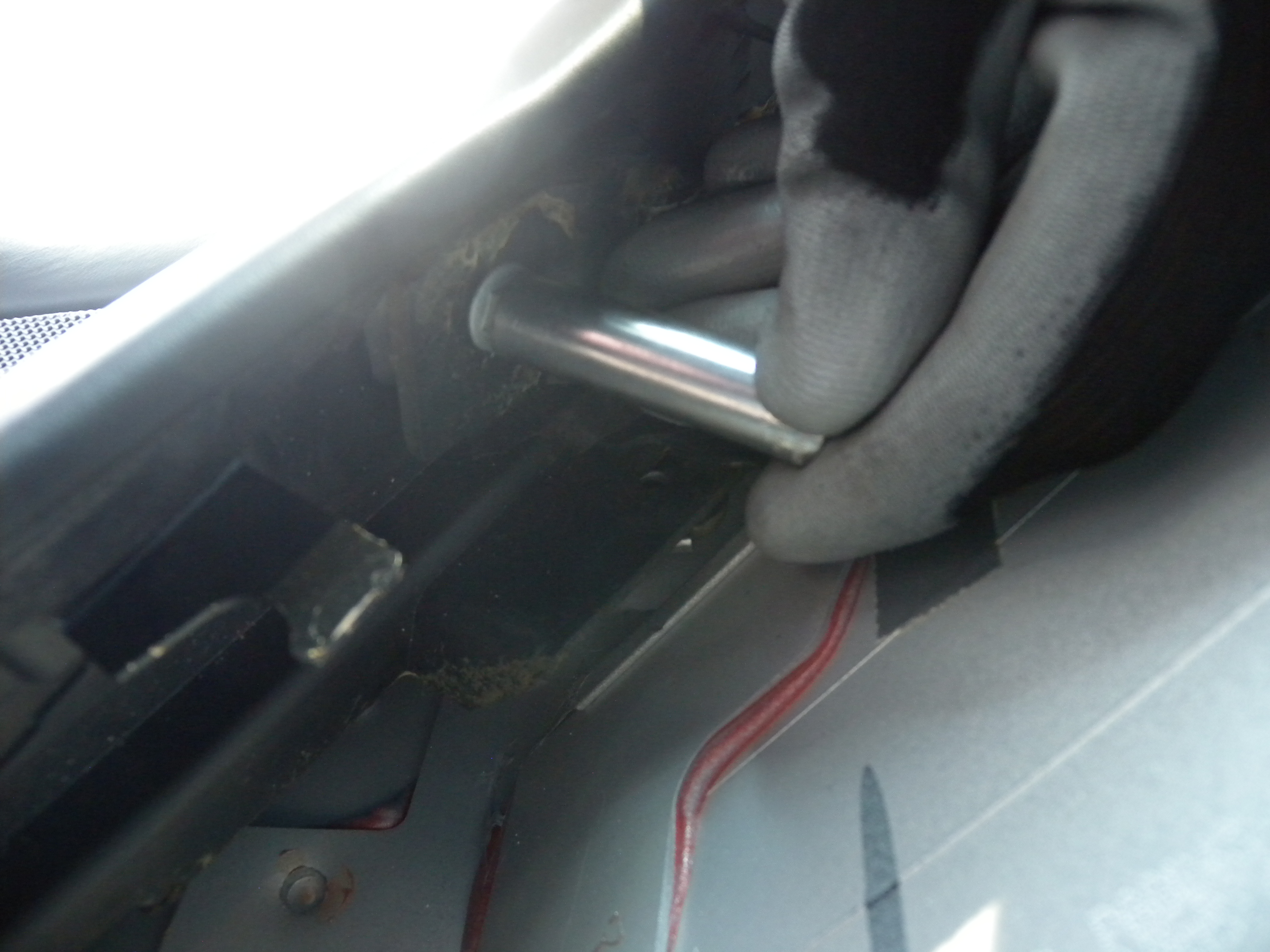

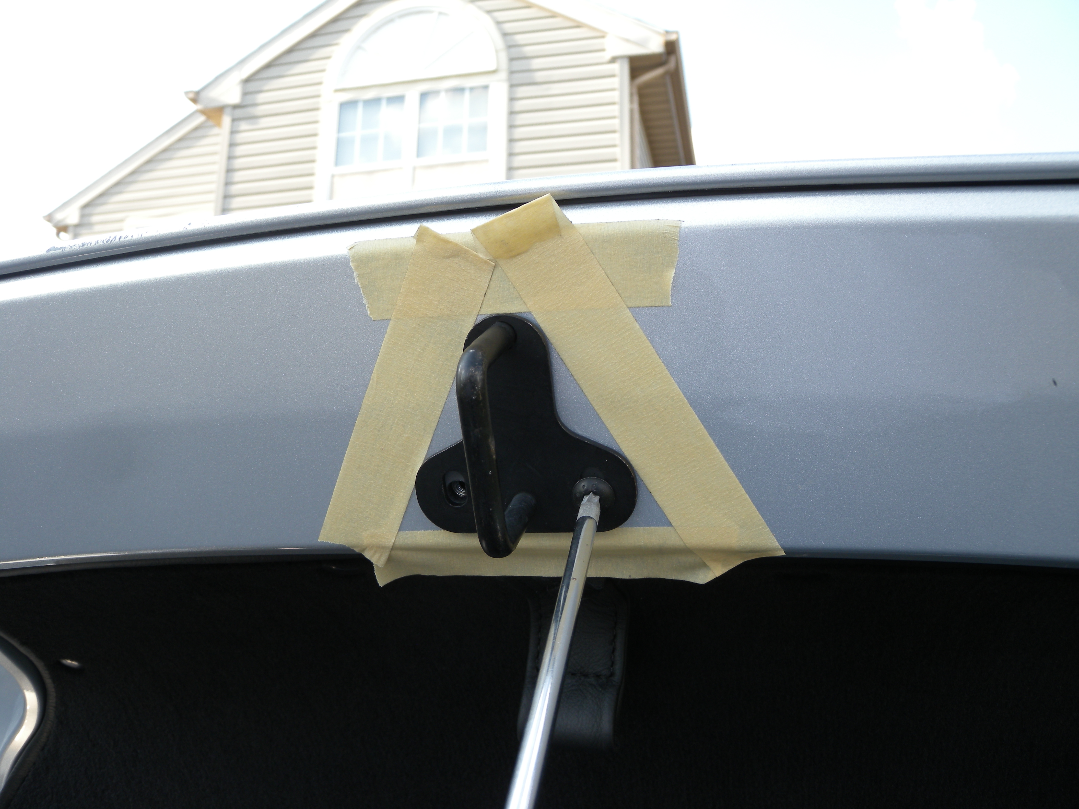

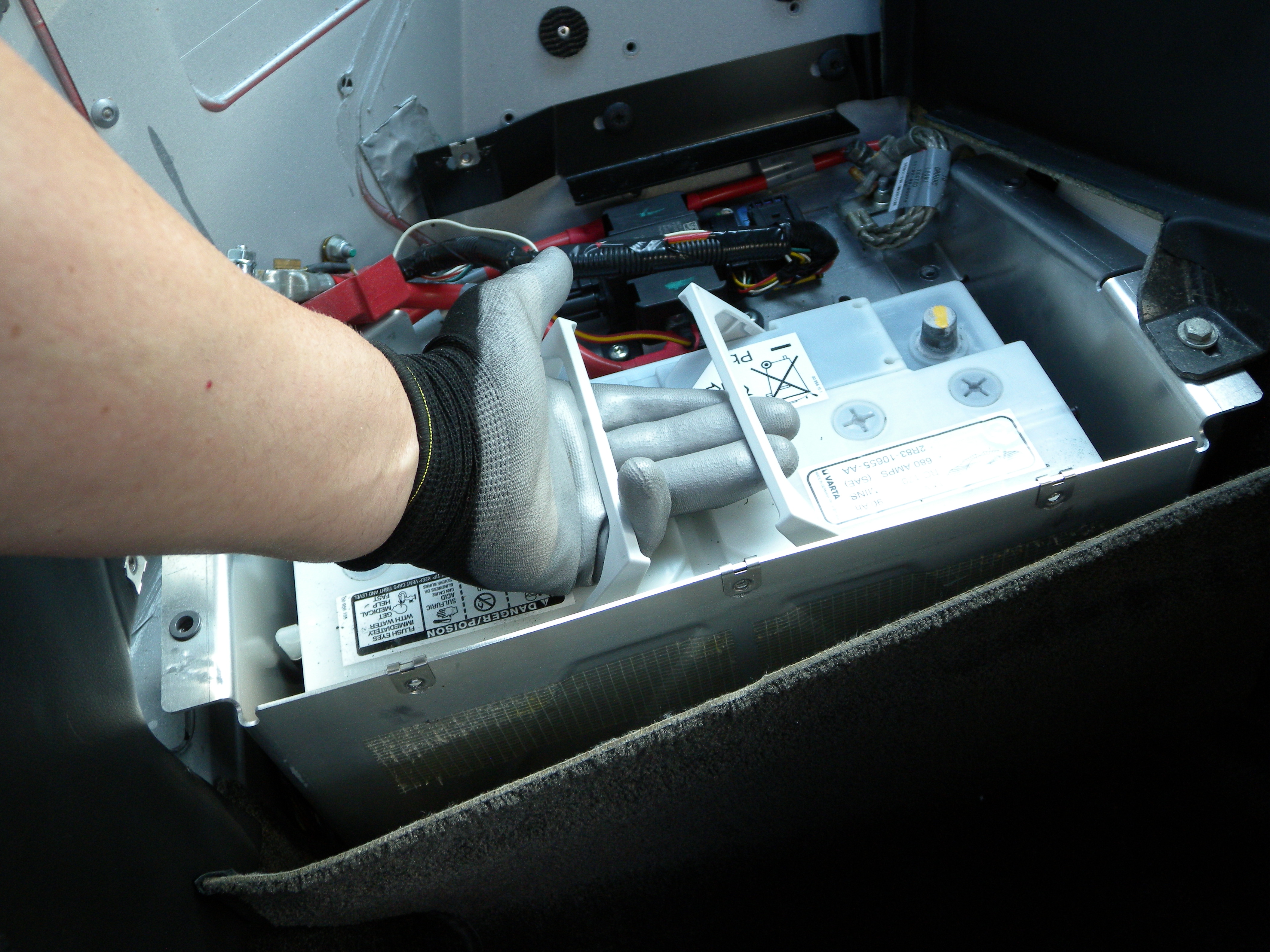

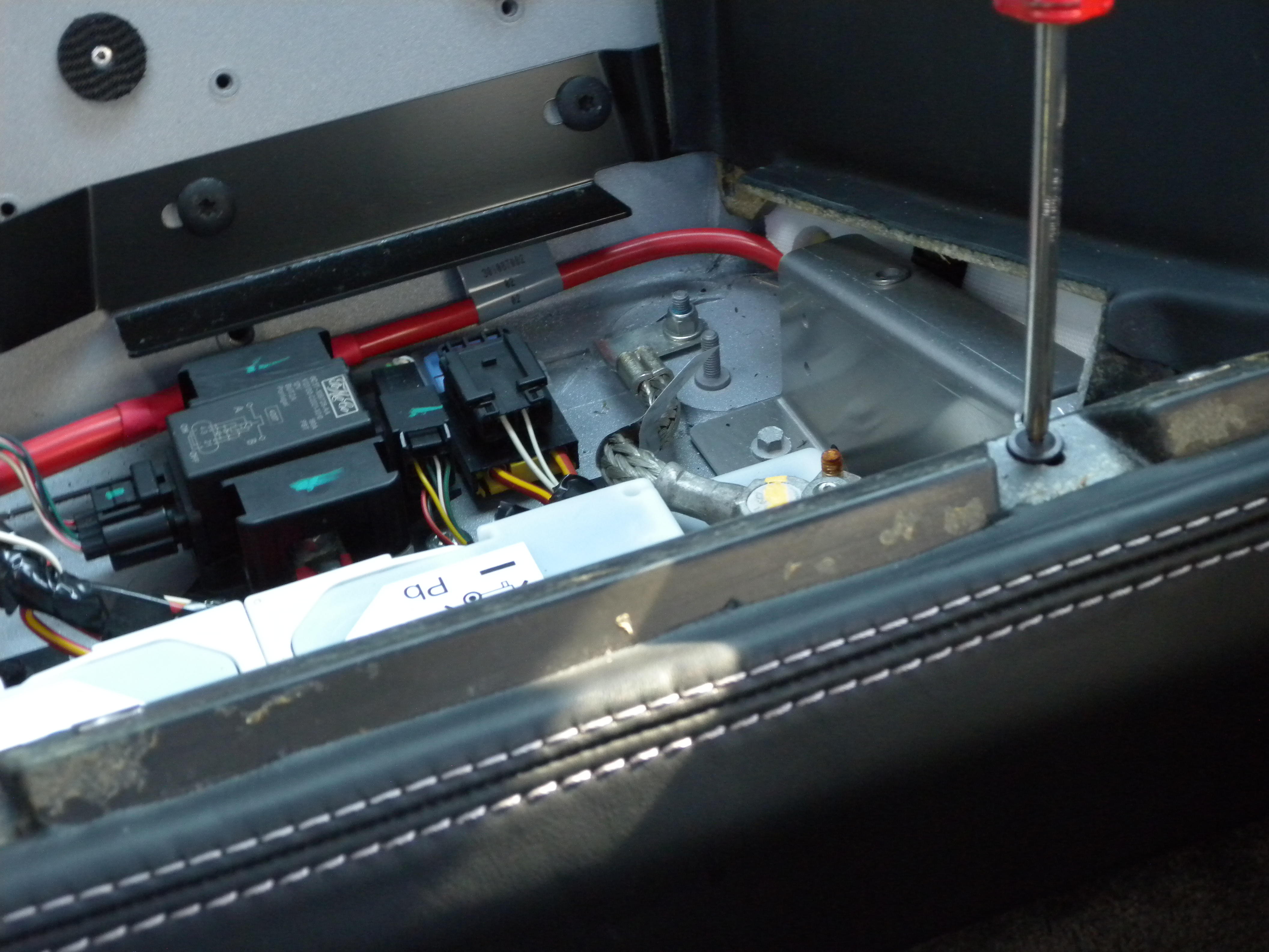

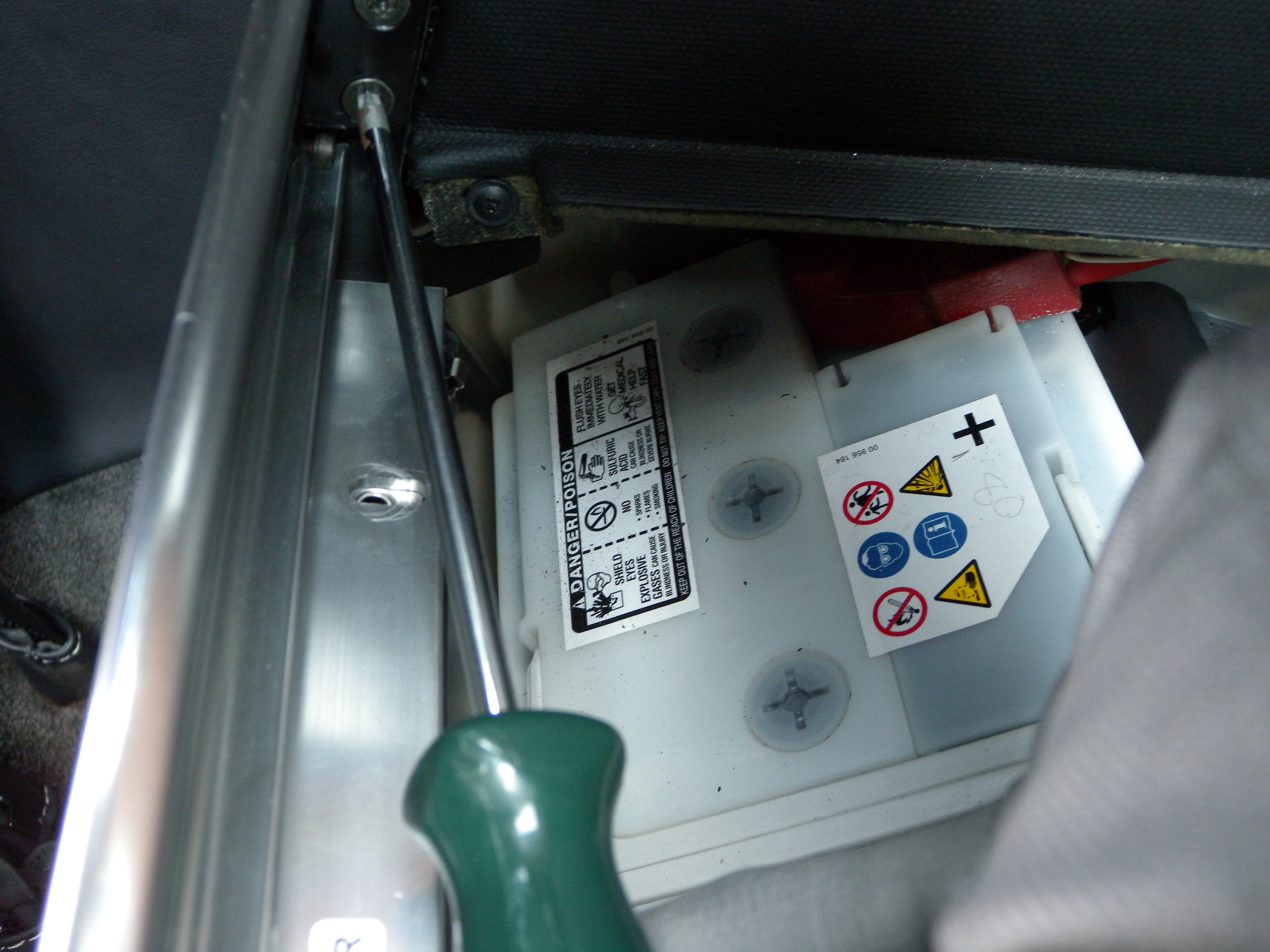

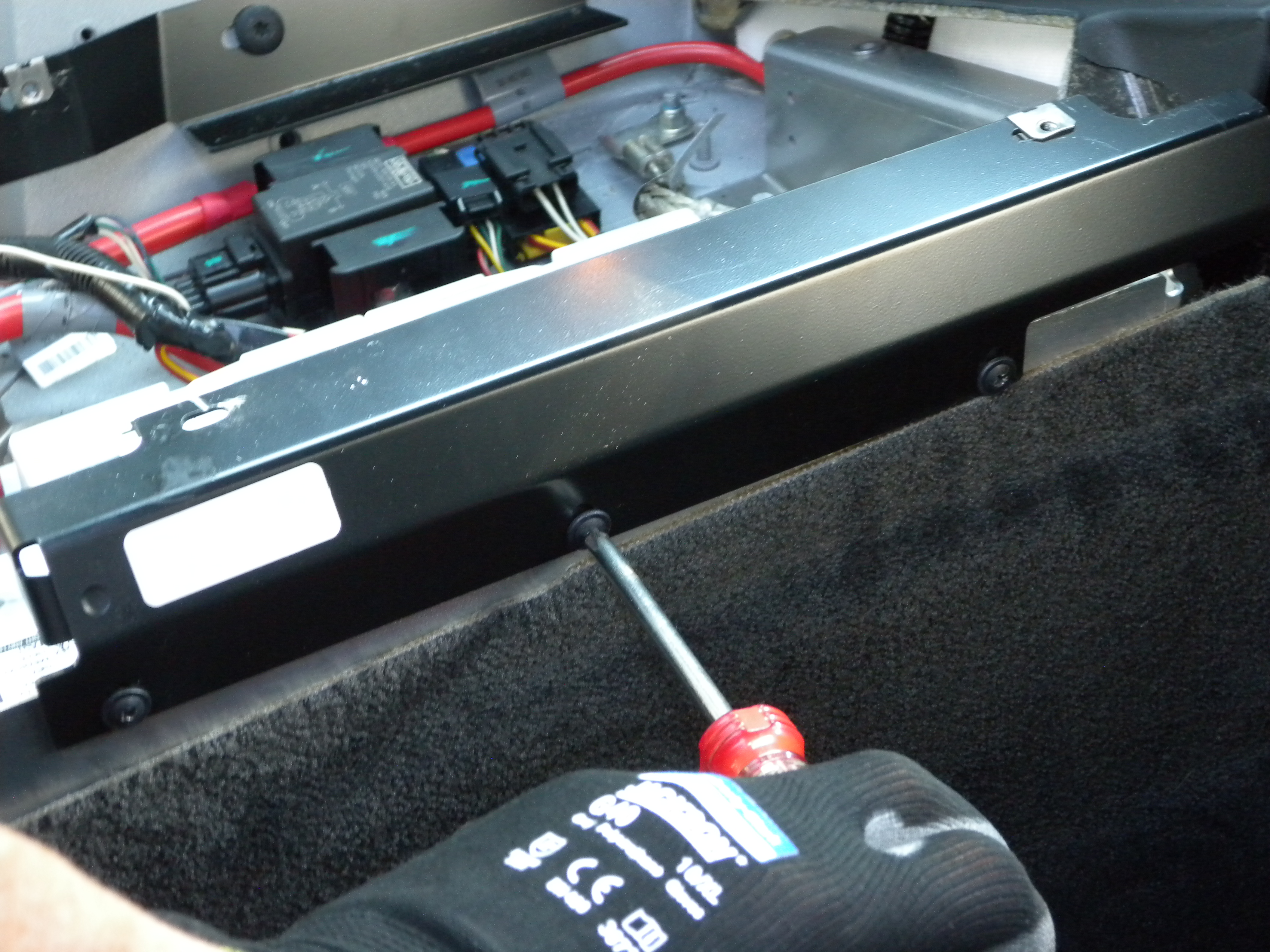

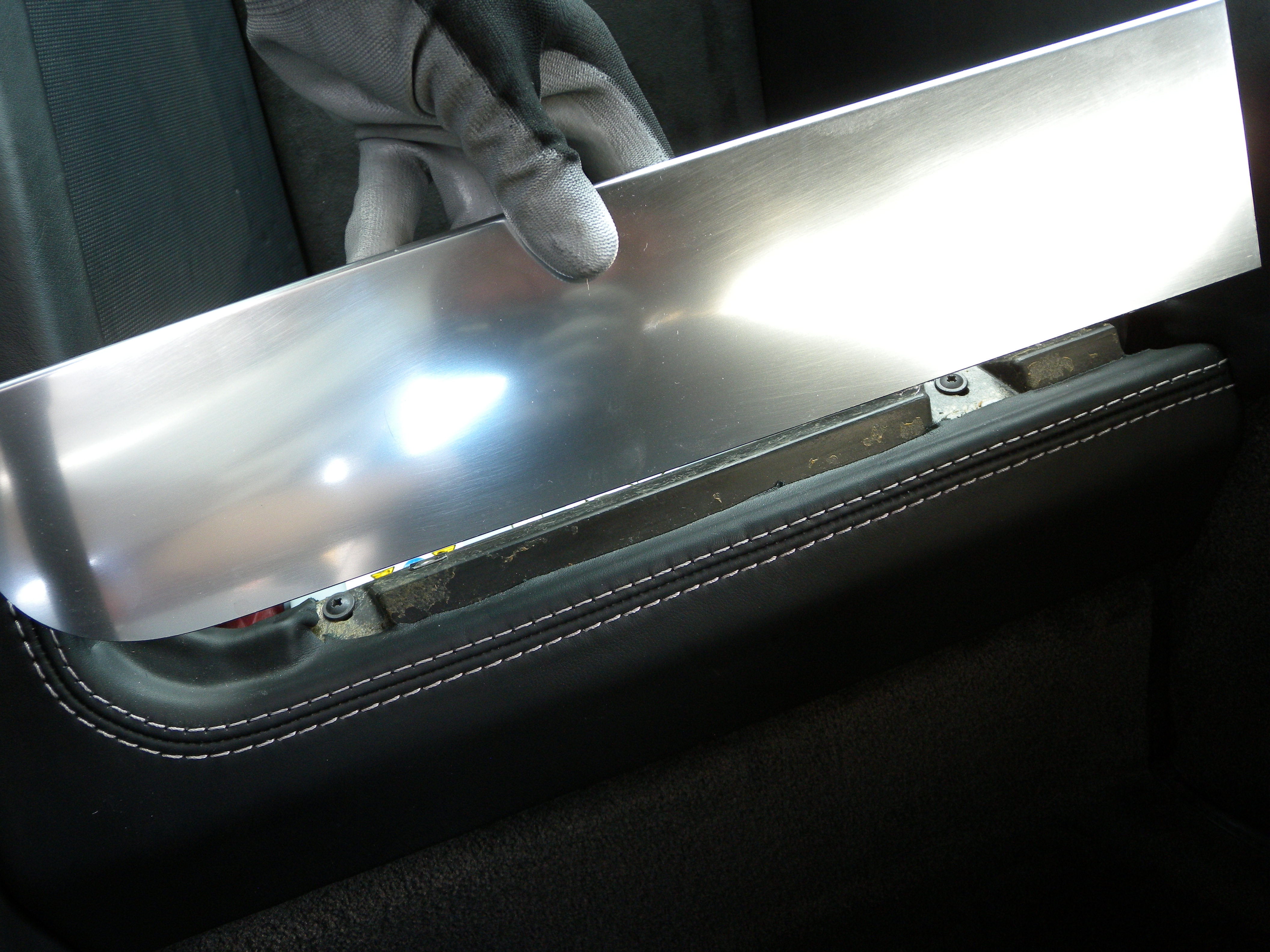

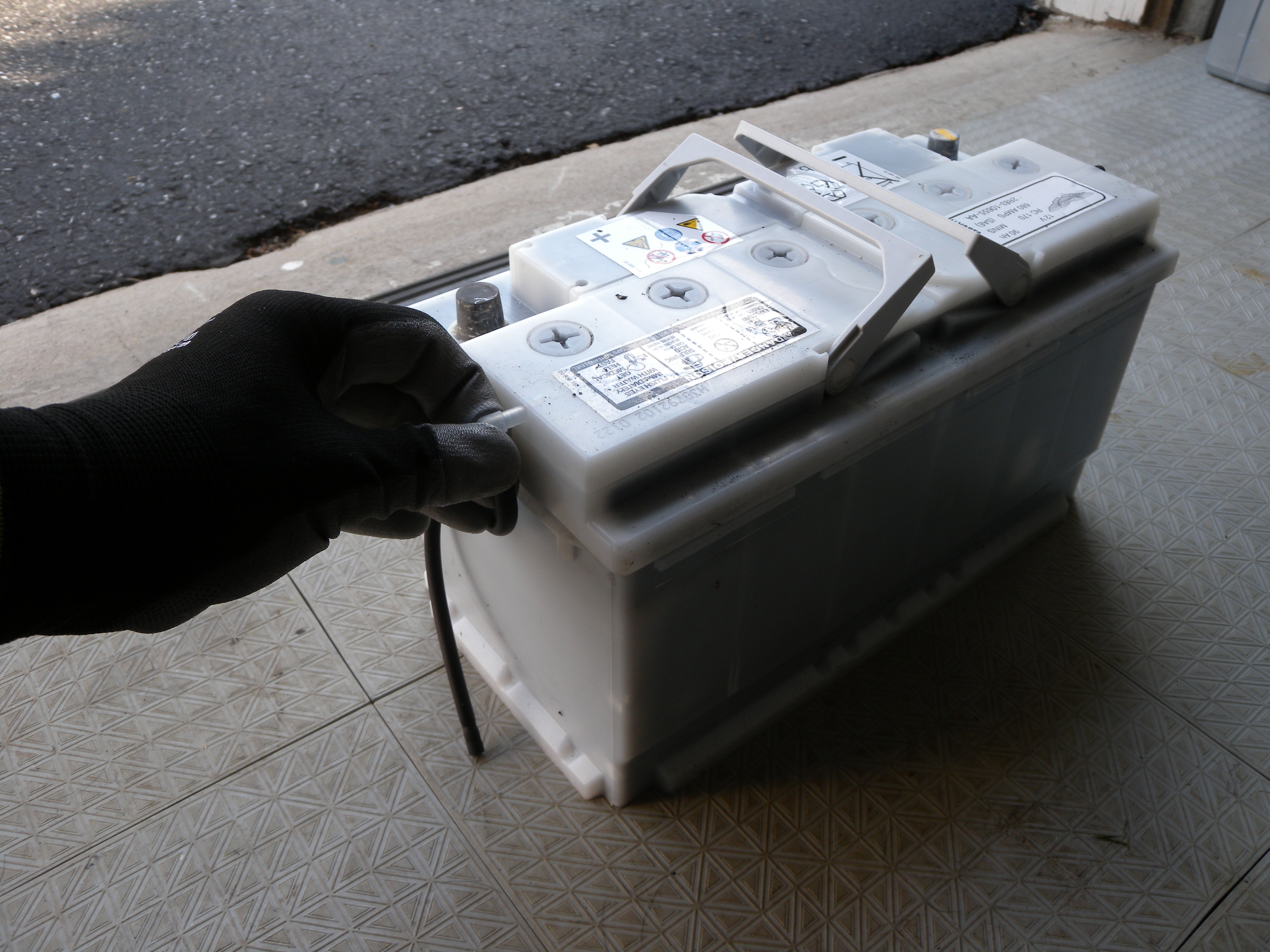

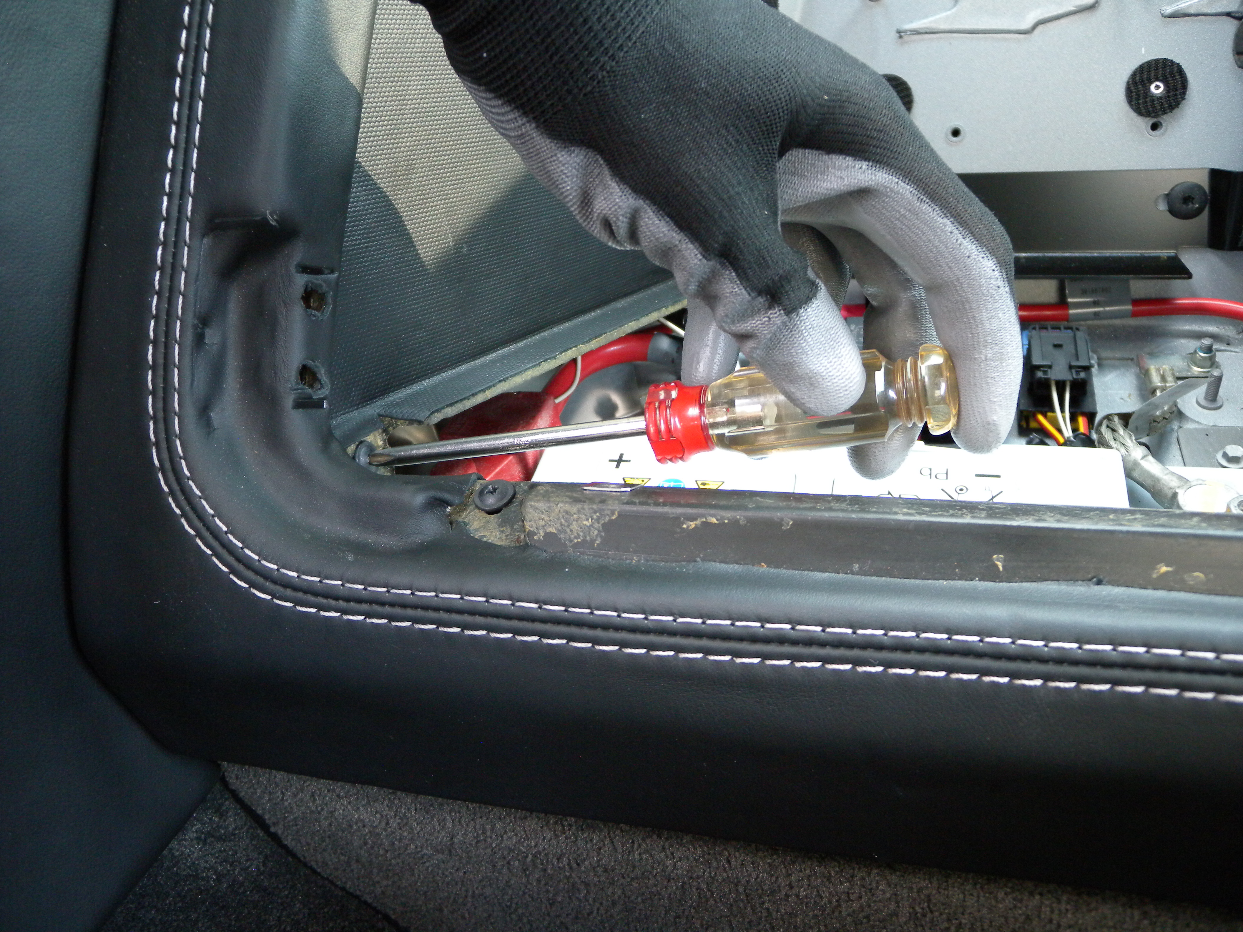

I've been experiencing some Gremlins recently. You know, the usual suspects.
For example:
The window dip works three out of four times
AM Receiver is inoperative
Occasional stumble at idle
Starts fine when cold but slow to crank when restarting at operating temperature
So I decided to begin at the source since the battery was the originally equipped Varta 2R83-10655-AA which was now seven years old.
The vehicle is used regularly (but not daily) so I selected the Bosch Platinum AGM 49-850BAGM as an upgrade due to it's increased CCA and extended life.
ID:	458470   Click image for larger version

Great pics. Did you loose any engine or mirror settings when the battery was disconnected from the car.
Old Sep 9, 2016 | 01:59 PM
drivergmx's Avatar
Joined: Oct 2014
Posts: 137
From: Northeastern Pennsylvania, USA
drivergmx is a jewel in the roughdrivergmx is a jewel in the roughdrivergmx is a jewel in the rough
So far the clock and window dip required a reset however the seat memory function was fine. I plan on taking it out this evening and seeing what else I can find...
