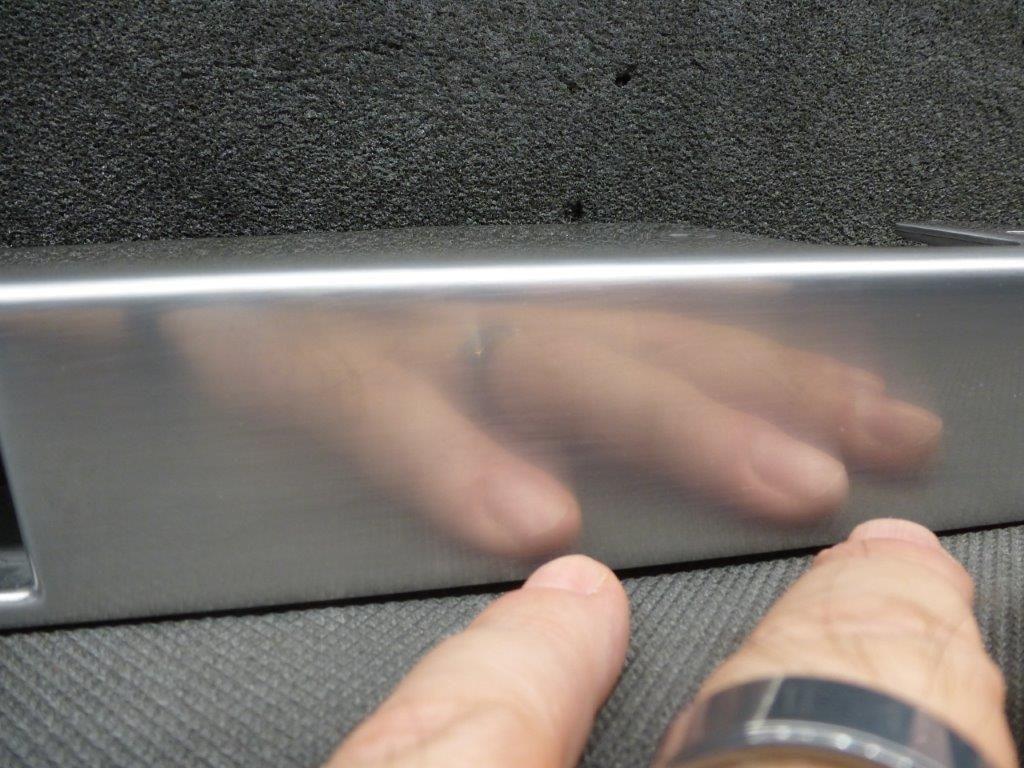

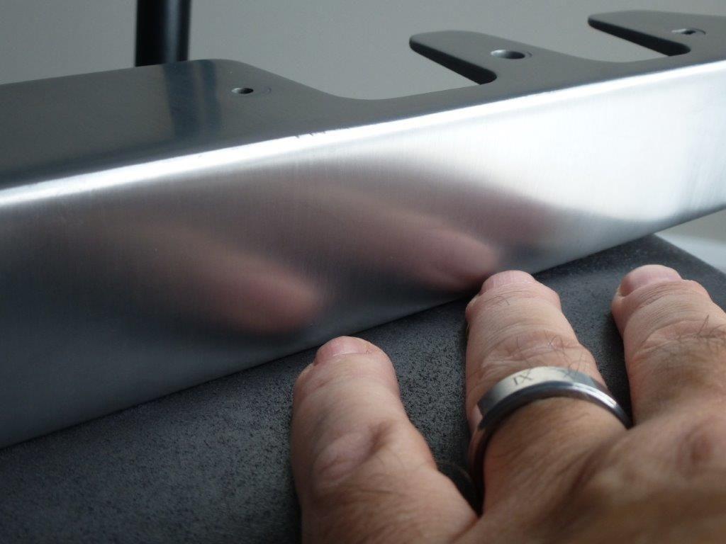

Well had some time this weekend and was able to get both 800 and 1000 done, it's hard to show how well it's coming but here are a few pictures to show the change in reflection from 800 to 1000... only two more to go... 1500 and 2000
800 grit wet sanded
1000 grit wet sanded

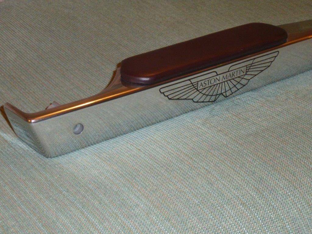

Got some logo made today, need to finish to polish everything then put those on and see how it turns out... :-)
7 x 1.5 inches logo

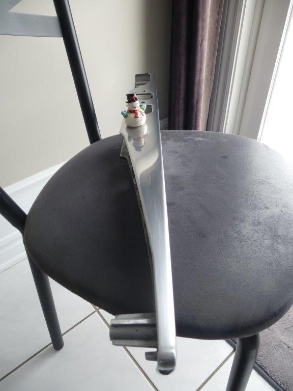

Just finished the final wet sanding at 2000 grit, forgot to take a picture of the 1500 grit but... it is hard to show the reflection but I think I got a good angle. Next is start polishing...
Final sanding 2000 grit
Reflection after 2000 grit

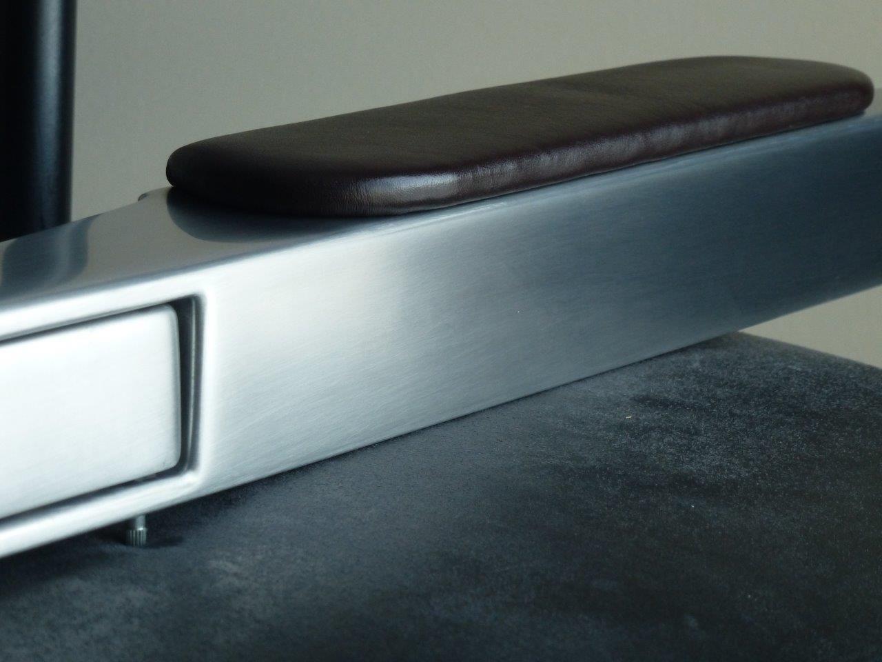

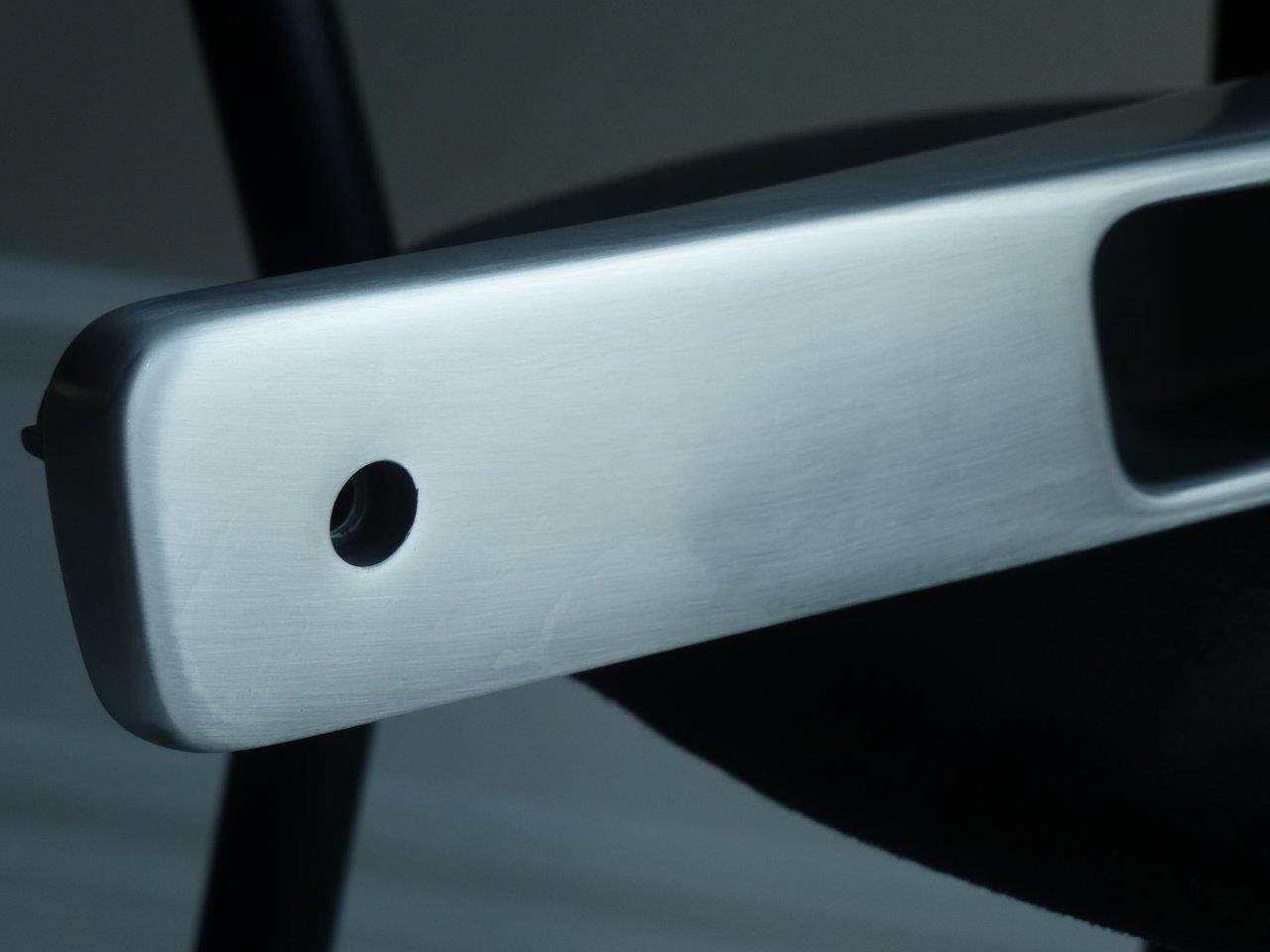

Finished to polished one of them this afternoon, re-assembled it and applied the AM logo. I spend about 50hrs to do both of them and less then $100 in materials... I know I named it Winter Project and the official winter hasn't even started yet, oh well maybe I will do the same to my door sills as they are scratch also...
Let me know what you guys think, my wife and I are very happy with the end results but I will probably get them clear coated to keep them nice.
Polished using Autosol metal polish
