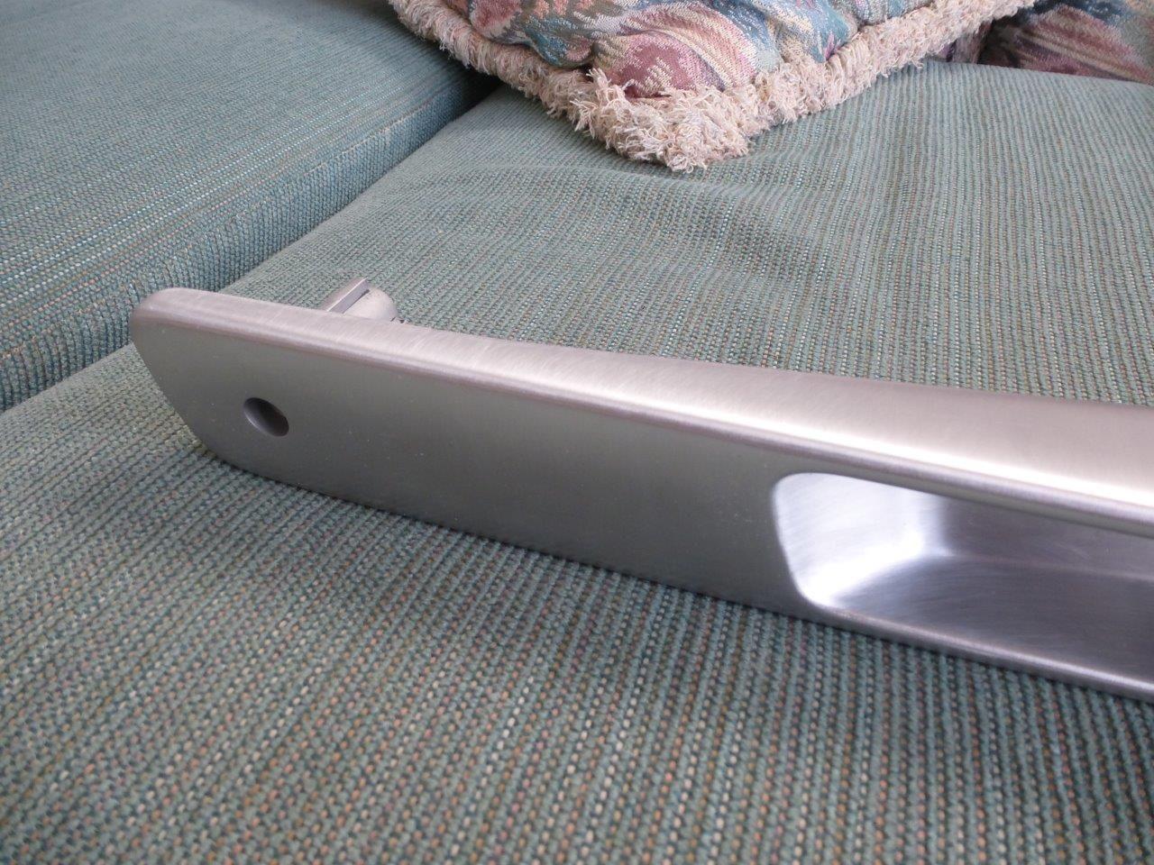

Well I'm not sure if anyone else tried this before but here goes...
My Door Armrest (specially the driver side) was all scratch and didn't show very well. I could have gone the way of getting it re-sprayed but I though that I would try something different and see if I like it.
Top Sand blasted, bottom 220 grit to level and remove cast imperfections
Sand blasted and 220 grit
Still some imperfection showing
I first tried to remove the paint with Aceton, that was a No Go, after 48hrs in that stuff nothing nada, second tried the Aircraft stripper it did not affect the paint except getting it a little dull. So I was left with Sandblasting the parts just like Jimshadow did on his DBS Shifter, that did work but took about 7hrs to complete blasting everything off (inside and out).
I use my palm sander with 220 grit to level the parts as they are far from perfect casting and the primer they use filled in all those imperfections. I still have a long way to go before they are close to what I want them to be but the winter here in Canada has just started
Let me know what you think, I also have a DBS Shifter and polished shifter base so I think it will look ok... I was also debating if I was going to get laser engraved after it was all polished...

Thanks guys, I really like the clear vinyl sticker option as I didn't like the idea of laser etch aluminum as it turns white... Lots of work in the upcoming months but I think it will be worth it, I will also need to find a top coat to protect the finish so if someone have ideas please let me know... I was thinking of getting it clear coated (paint shop and baked) but that will probably be prone to chipping again... the other idea was getting it anodized... As soon as I have more to show I will post them.

I started wet sanding at 400 next is 600/800/1000/1500/2000/3000 and I change direction at every level so that it is easier to see when I am done.

Thanks... I was talking to an Anodizing shop and they also recommended after anodizing to Clear Coat it... might just skip the anodizing part but we'll see.

Clear bra material would be hard to get in and around the door pull... maybe a spay clear bra like 3M might do it.
I finish the 400 grit sanding yesterday afternoon, here is some results, it will be easier to do the 600 in the other direction...
400 grit wet sanded... long way to go to 3000
400 grit Wet Sanded
more 400 grit Wet Sanded
