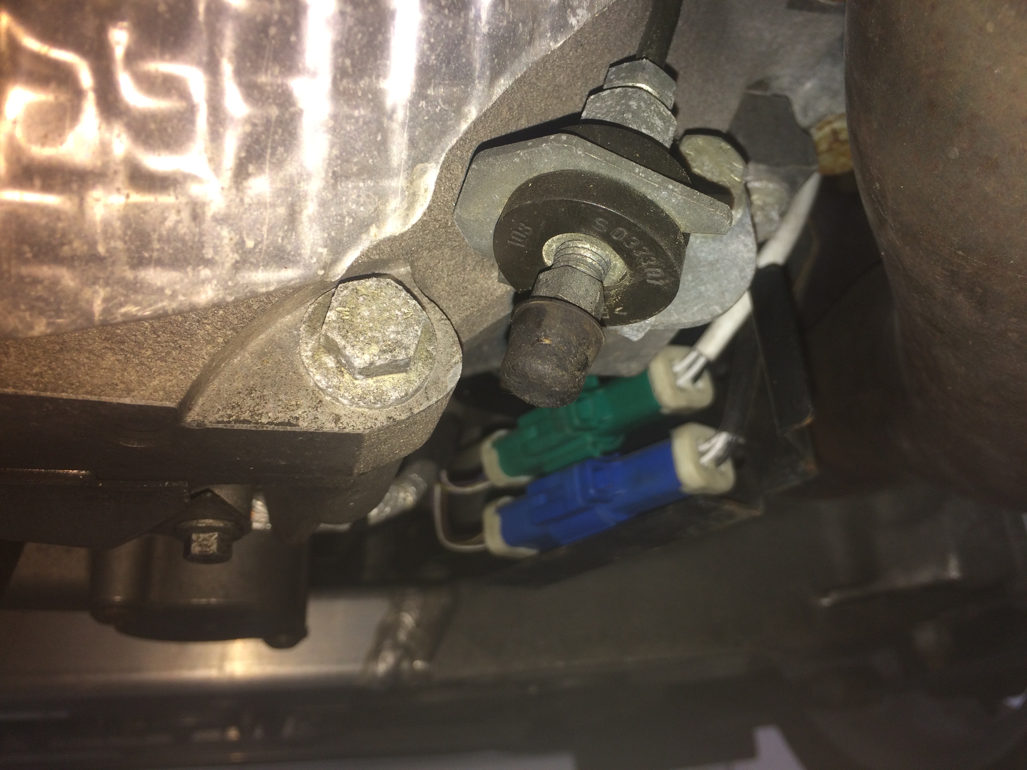

Finally got some garage therapy time away from house building .
Changed the oil and did some under belly detailing .
I plan on doing a brake /clutch fluid flush this winter .
Is this the clutch bleed point ?
Passenger side just beside the exhaust/ back end of the engine /front torque tube flange area .

yes, that's it.
Note to anyone with a SportShift: Do NOT drain this unless you have an AMDS.

Perfect , tks Rich .

THE best slave bleed location for servicing I've had on any car of any vintage.

How does it work? Like a normal nipple?
It's a bleeder valve just like any other slave cylinder or brake caliper.
