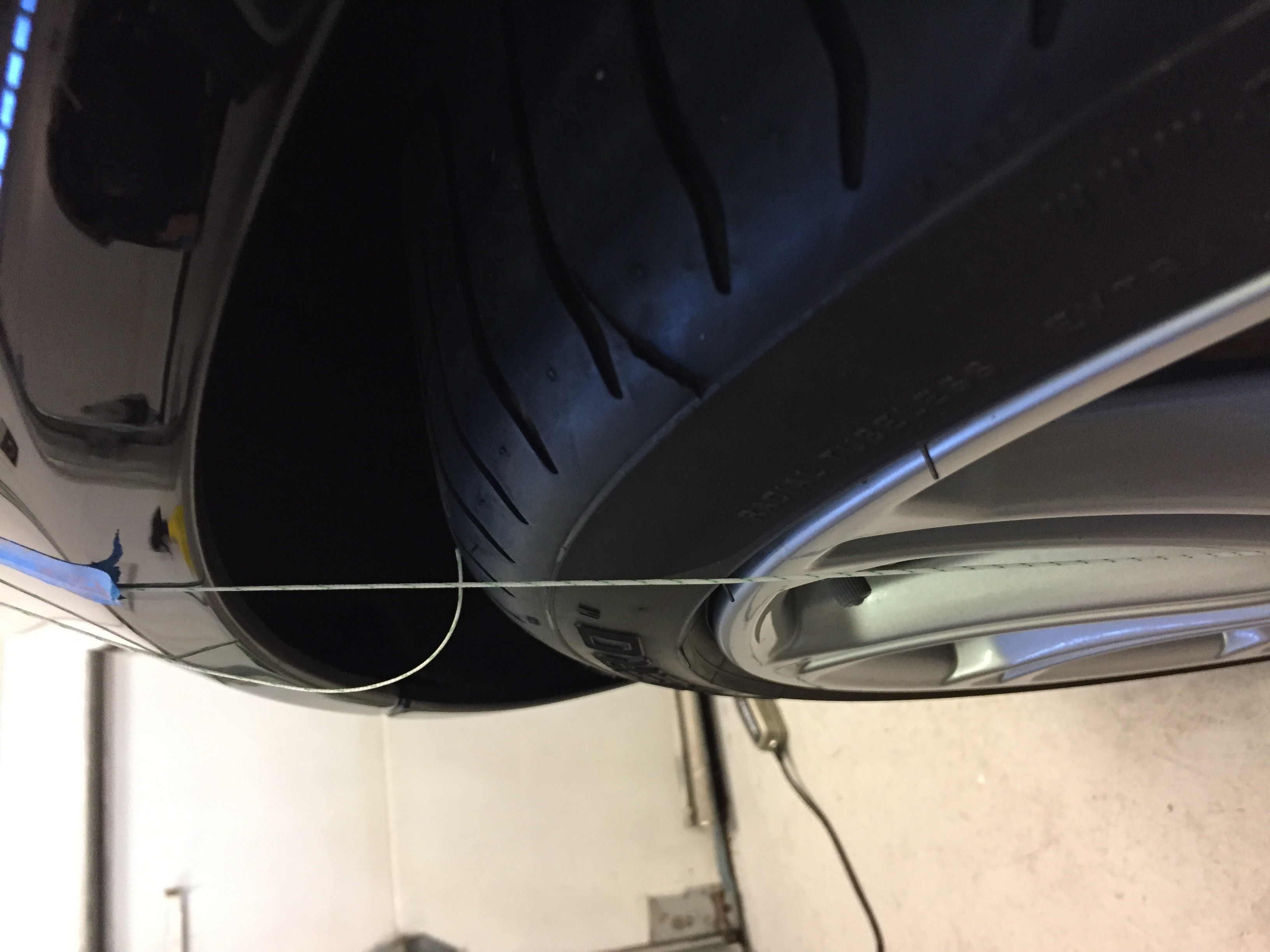

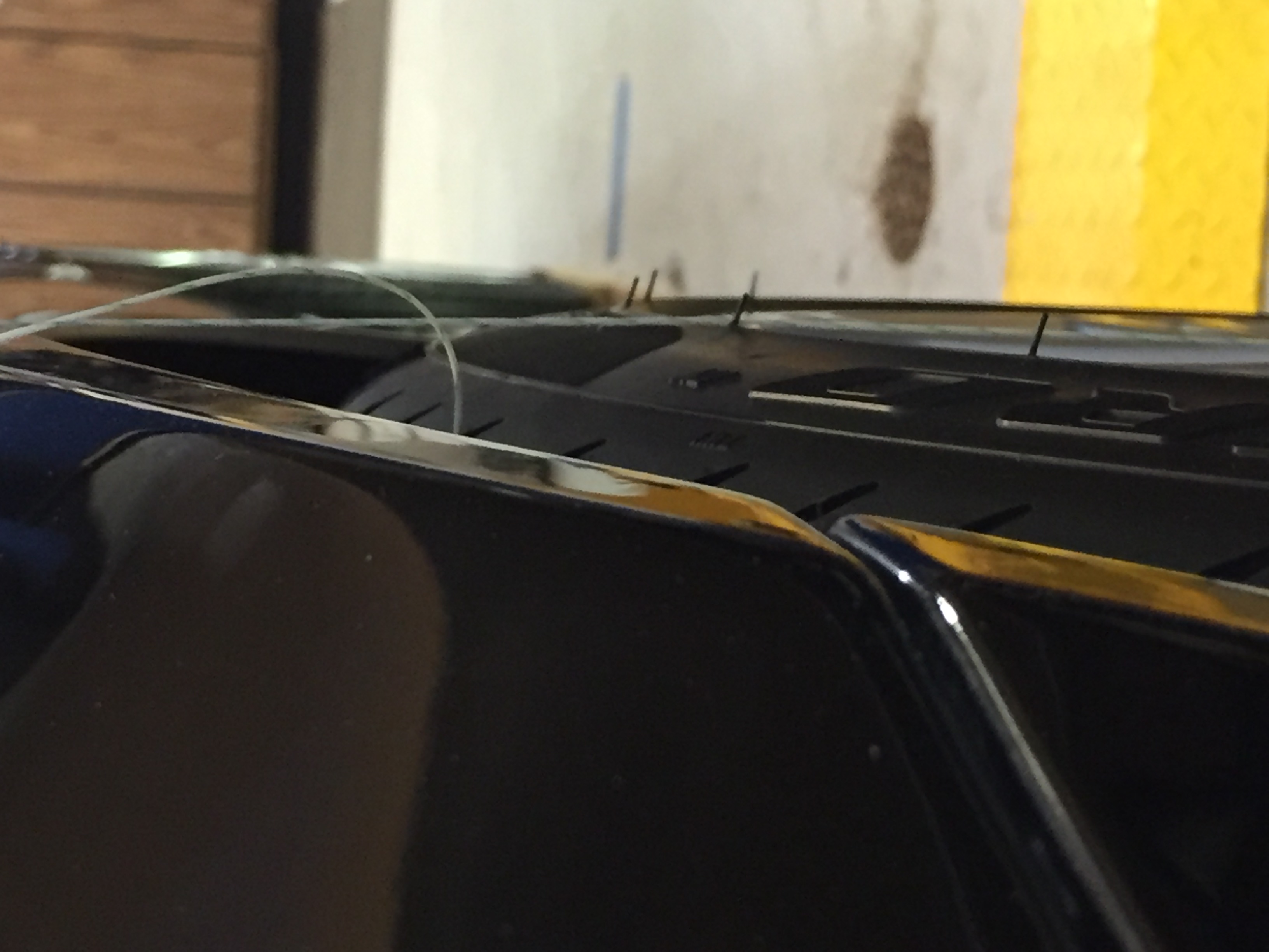

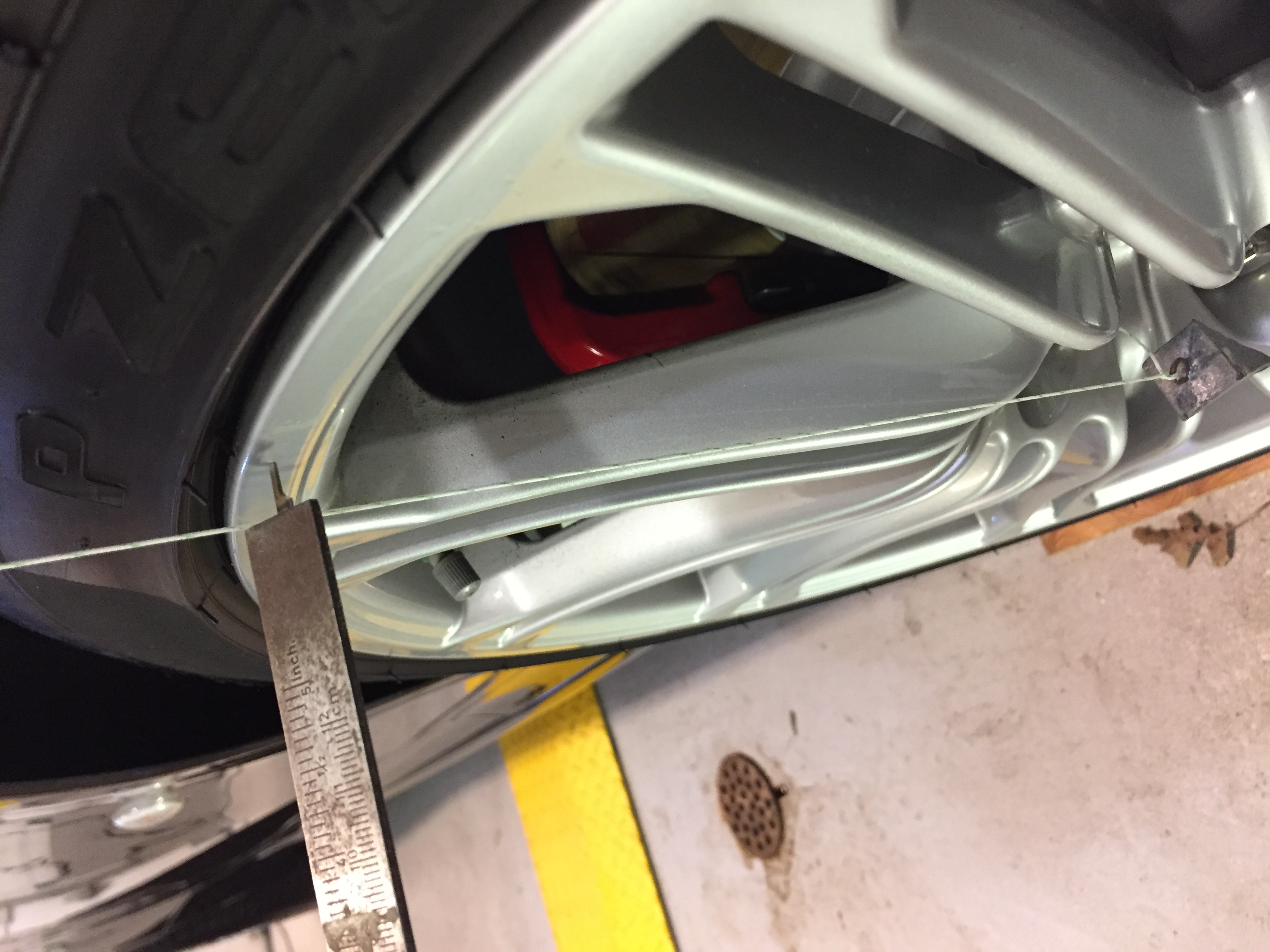

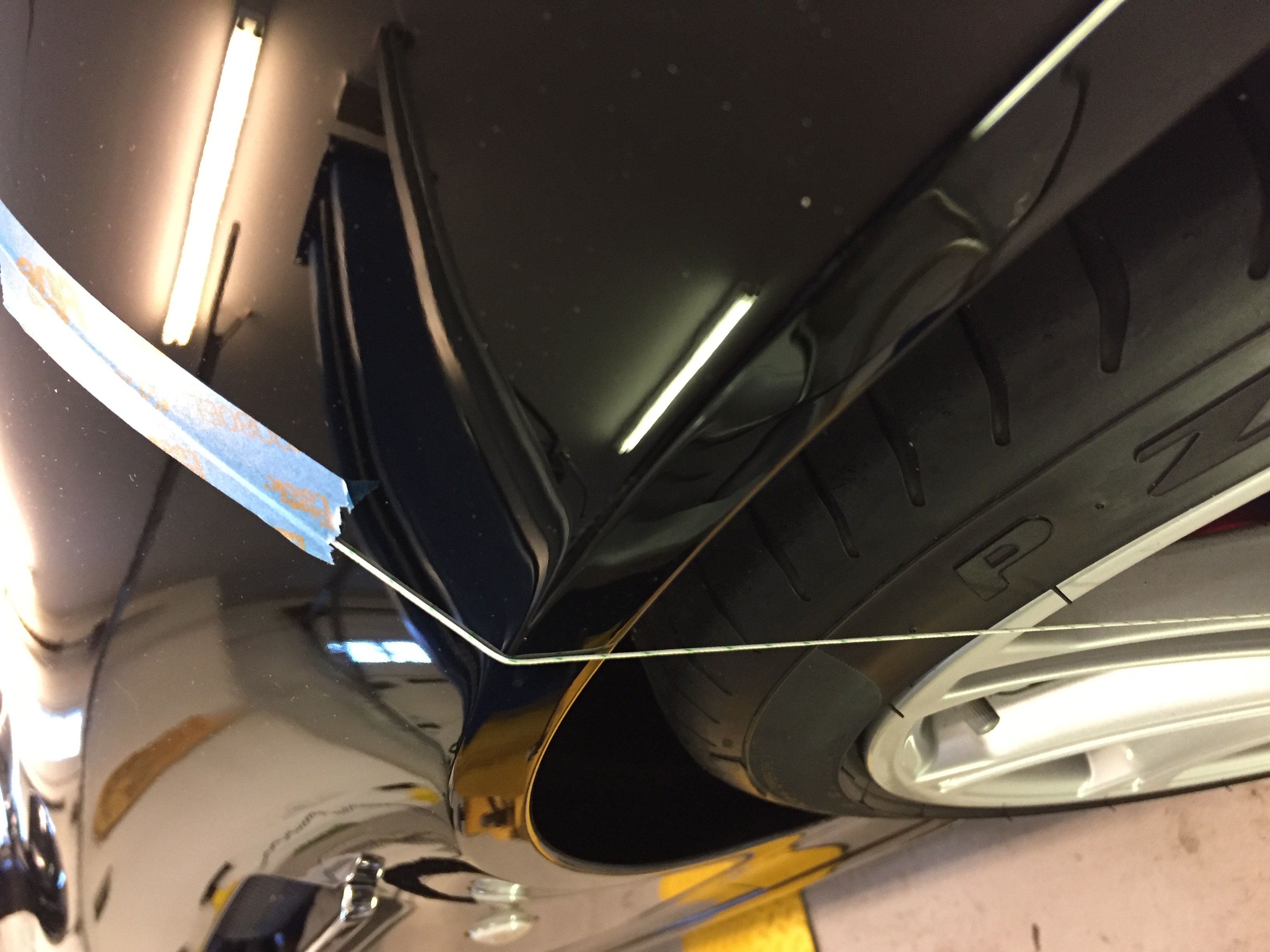

Here, finally are some shots taken with a plumb bob and a vernier.
The front shows that the outside of the fender to the face of the rim is 9mm.
The rear shows that the outside of the fender is set back from the rim a mm or so. The plumb line hits the rubber before the rim.
not sure why these all come out sideways...

Thanks so much for the info.
The DBS infö is not only helpful to me, but to many who ask those questions from time to time.
Here is what I went with and why-----
Final:
Fronts- 245/35/20 with a 9in wheel offset +42
Rears- 285/30/20 with a 10in wheel offset +46
What I wanted was a 10.5 in wheel at +52 which would have been slightly smaller than the DBS fitment.
But.... the RZ21 BC Forged style wheel they cannot make above a +46 offset due to design. I didnt not want to go to a straight spoke type wheel similar to the V8V standard wheels, and really wanted the HRE P101's but wont spring for 11k in total. So we worked numbers and with the 285's and the 10in we can bring it out to +46 on the rear and still be 2-4mm shy of the DBS fitment. I have the exact measurement, but not handy. I will have similar pictures taken when they get installed. This will still put 285 worth of rubber down which can be done with factory wheels, just mine will move outward some, instead of filling everything out. Hope that make some sense.
This will be the first set of RZ21's BC has done like this, but they wanted to open their business to DB9 owners also, so they said they would make them. Their fitment for Vantages is no issue, just they never had a DB9 get wheels. They do have caliper measurements so that was taken into the mathematics.
