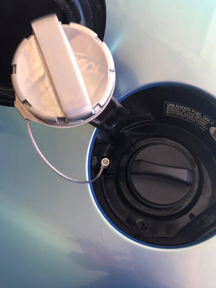

Gas cap trouble
Is there something special about the AM gas cap? Can't we replace it with a generic cap?
funny my car came w/a generic cap and i actually just bought an original.
Any reason for changing to a factory gas cap?
i mean just look at, how do they even compare
