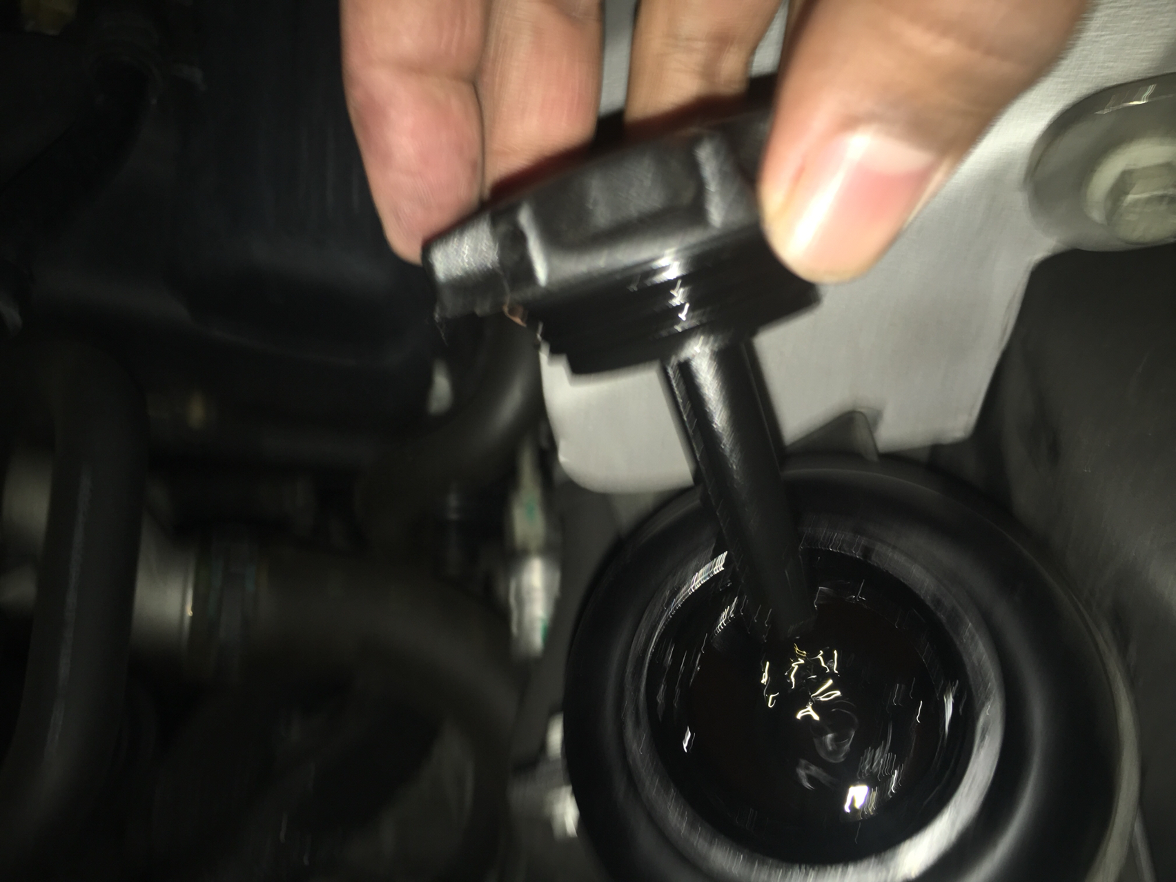

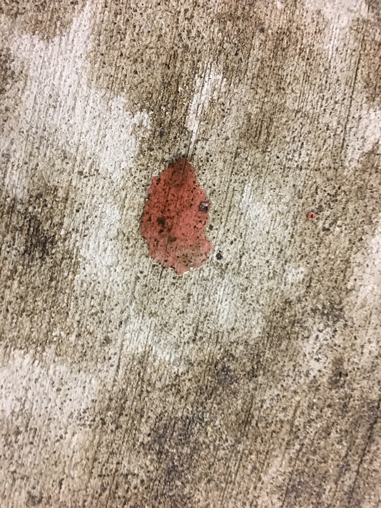

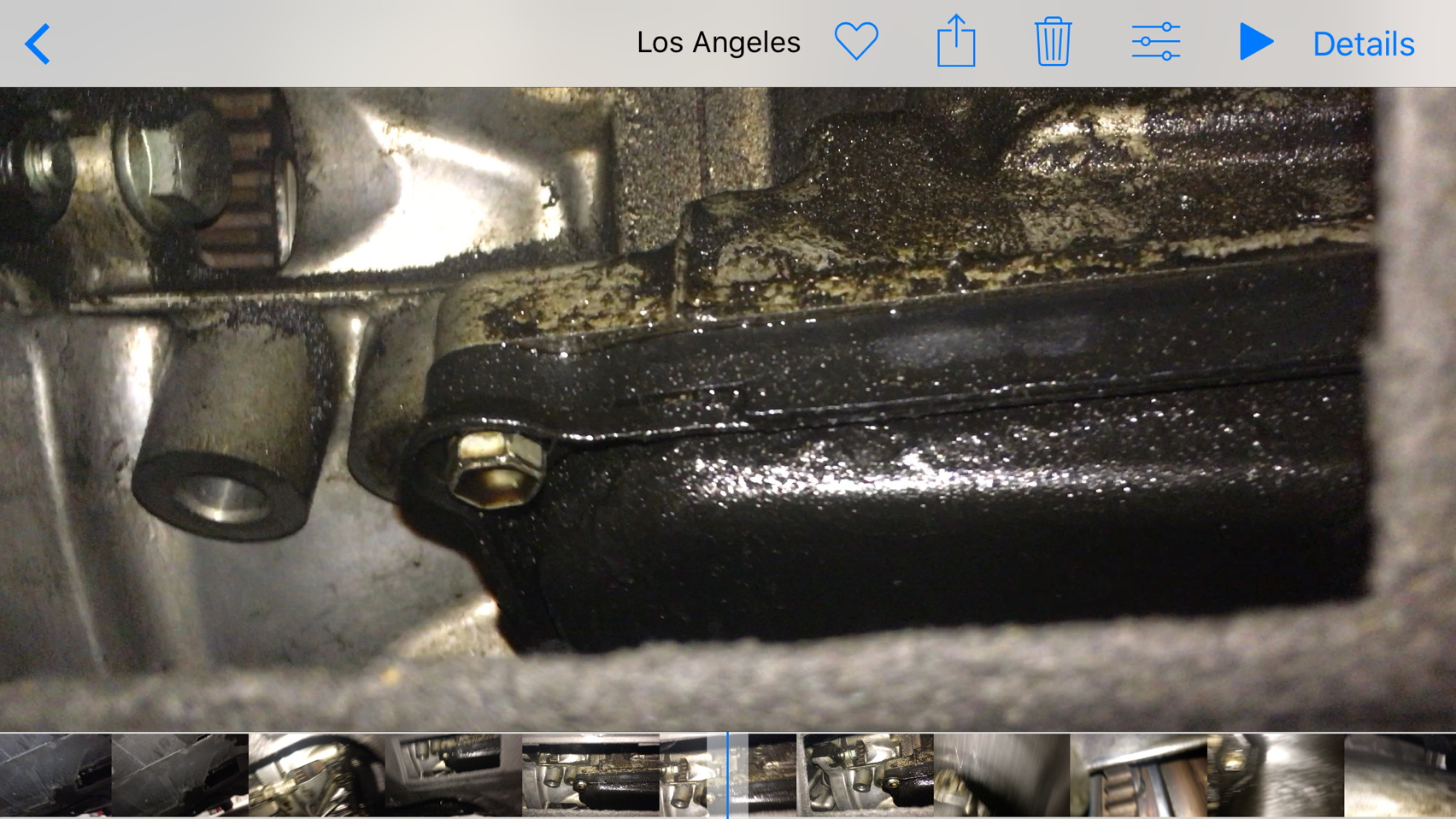

Found this red liquid under my car. What can It be??
08 Vantage roadster sport shift
Went for a 50 mile drive earlier. Parked the car and saw this and now panicking.
What should I check?

Check that fluid with you fingers. Is it oily? What part if the car did it come from? Front or back?

Seems a bit oily. From the front.

Get a white piece of paper and pull your oil dip stick. Is it the same color as that fluid? First check your dip stick was tight in the first place. LOL. My dealer use to put a dye in my oil. Makes it easier to see i guess. If its not the same color as your oil, move over to the power steering fluid. MAKE SURE YOUR CAR IS COOL. You don't like burns do you?

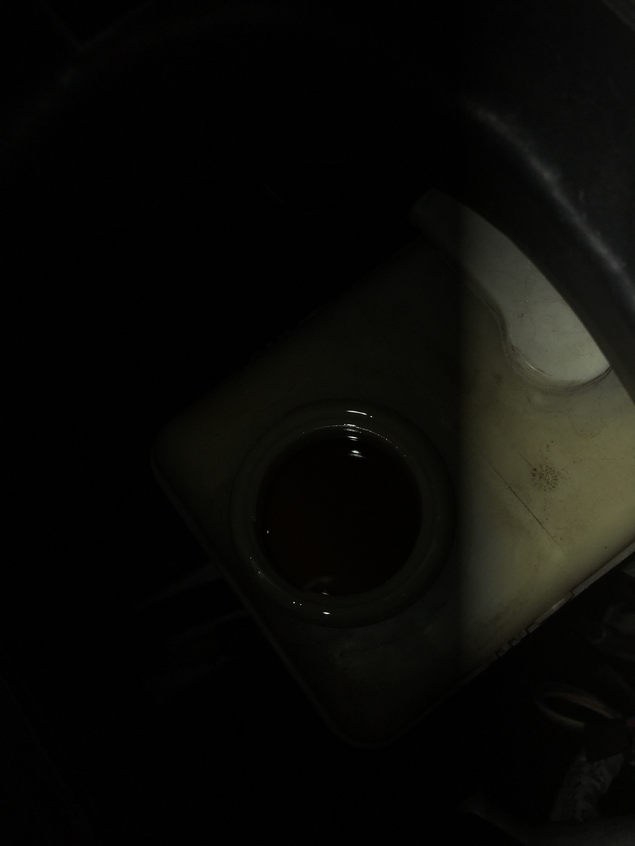

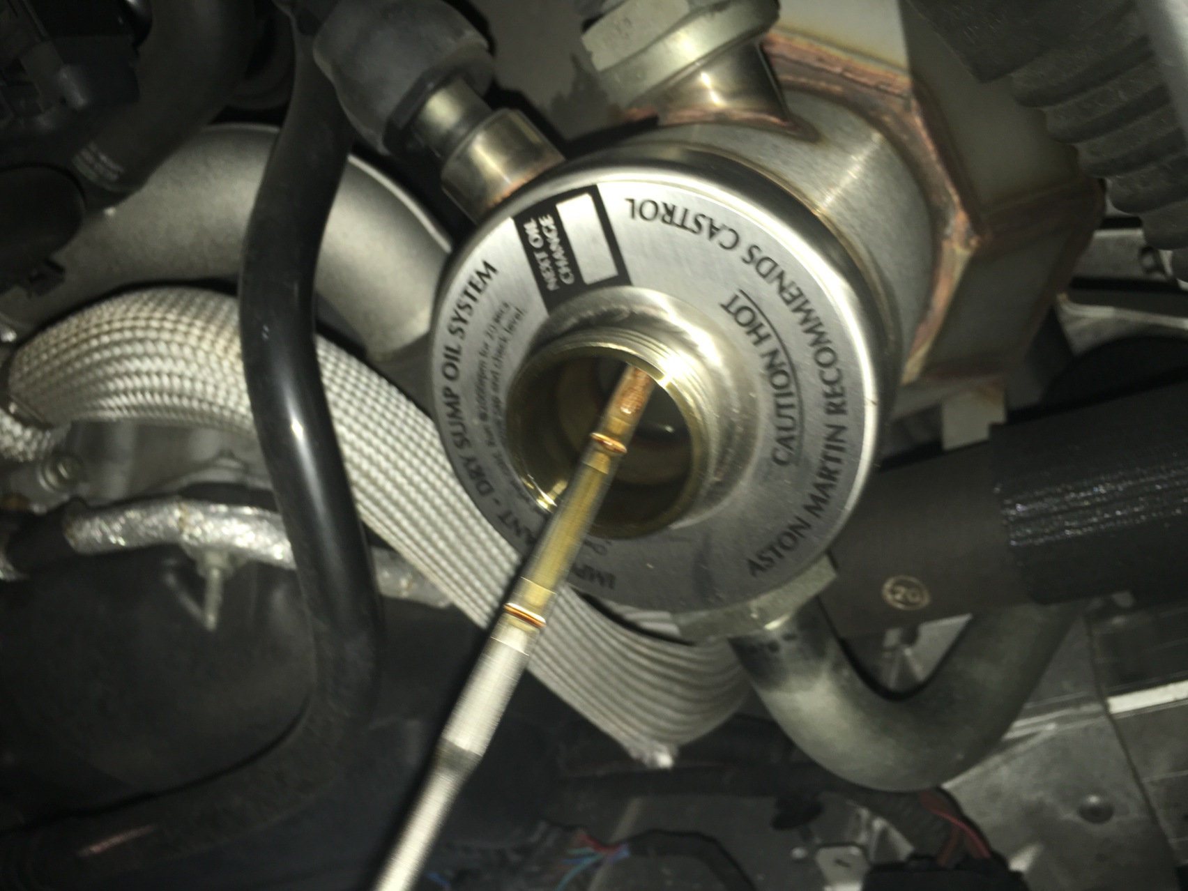

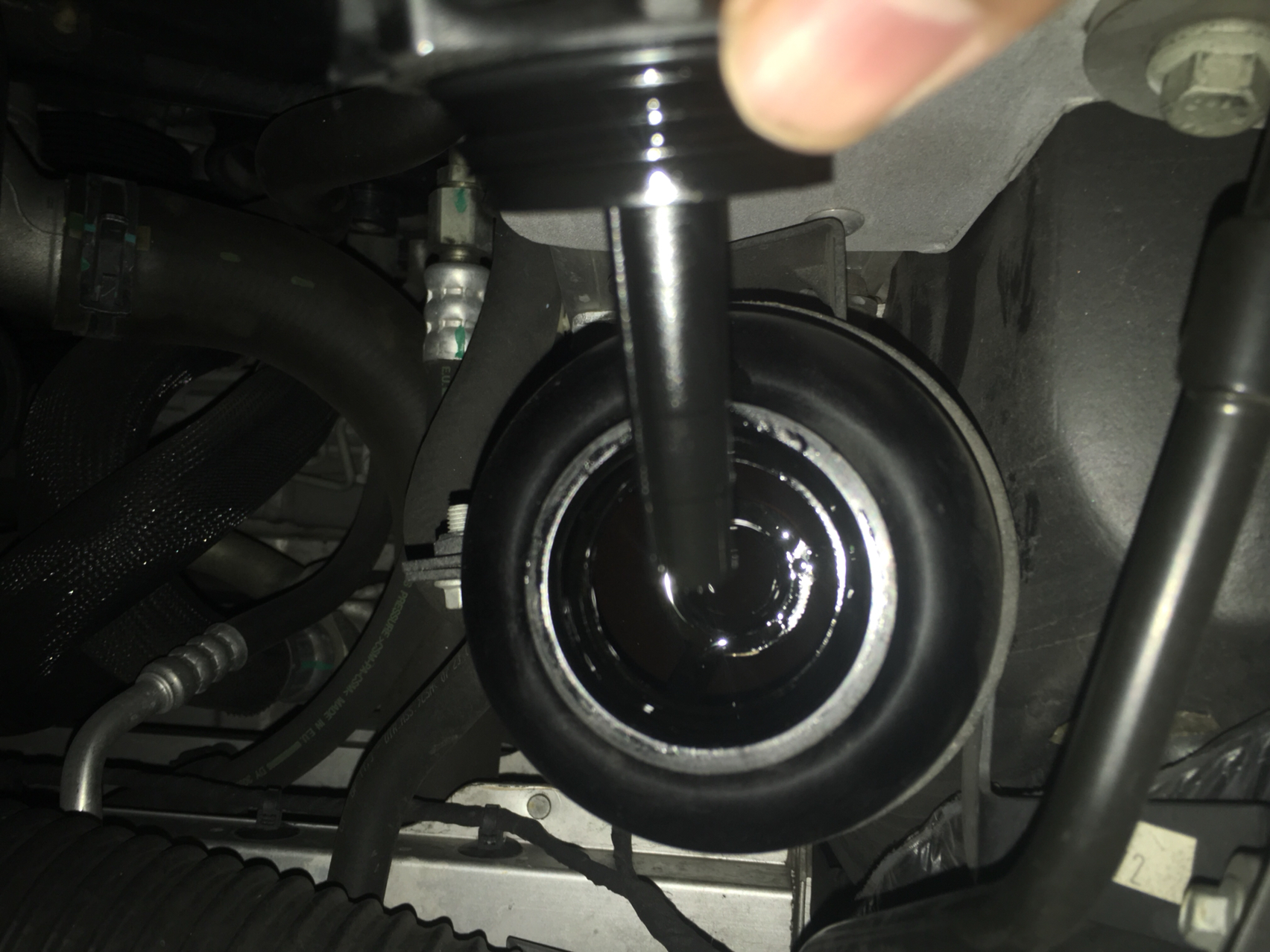

Oil fine. Power steering fluid fine. Brake fluid fine.
Couldn't check coolant the darn thing won't happen. Probably not the coolant.
Can't see leak from top. I think it may be my wifes car lol.
Recently did a transmission fluid service in her car (vw) so going to check on that. The transmission fluid was red. Going to check once wife comes back.

Power steering did check to the top of fill line. And the color wasn't red so that ruled it out. Anyways probably wife's vw. Will get it checked out.

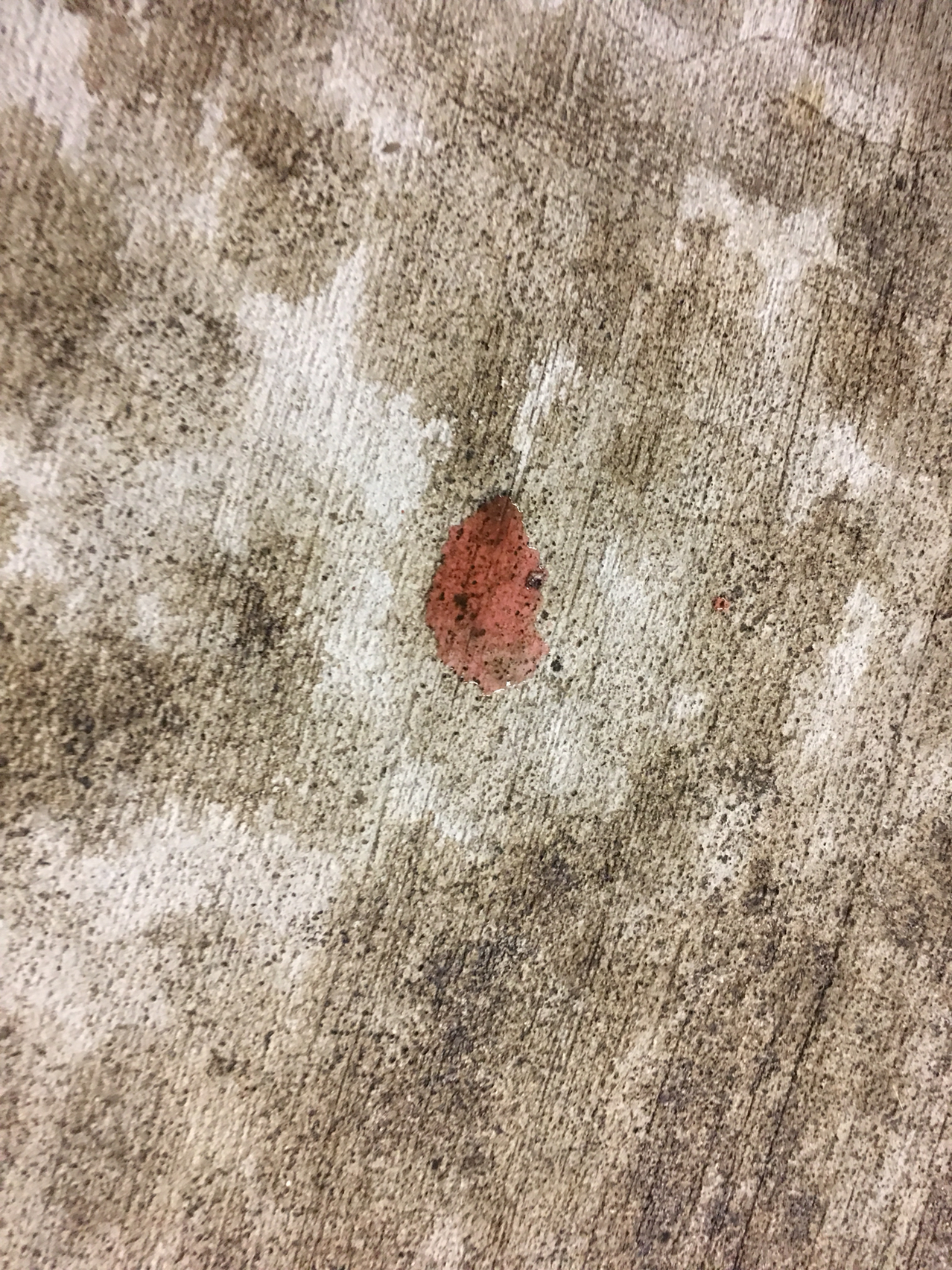

turned out to be my wife's VW. We did a transmission service with a new gasket and fluid. Apparently the brand new gasket failed!
