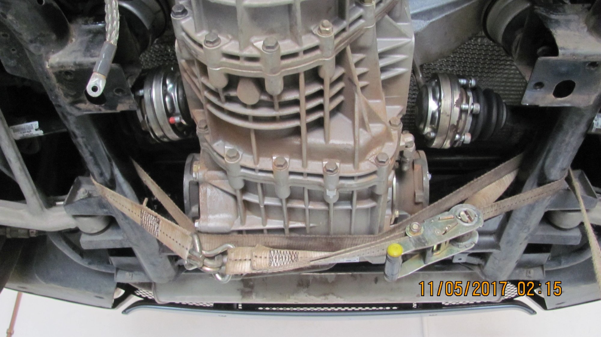

The gearbox came out easy and I do not have a gearbox jack, so I came up with this Idea.
The Cargo strap hold it in place while stripping of the Sideshafts and the cables, wires.
The sub Frame is a nice place to attach the straps.<br/>
Once the box was free I tied another strap to the frame and box. I could then drop the gearbox on to a table with only guy balancing it.

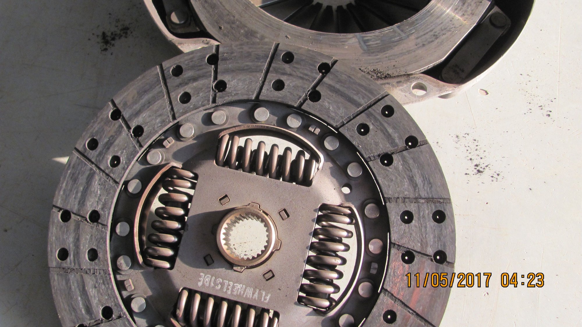

The old clutch was not on the rivets yet it was finished. I think the linings get old and brittle. It also looks like the linings only gripped on the inside of the flywheel and pressure plate.50% only worked.

I also used 2 straps to lift the gearbox back in place.

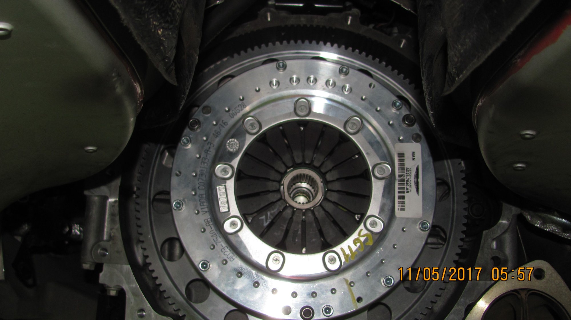

This clutch is the double clutch from the V12. This is also a original Aston clutch. The Flywheel is not Aston made. But it is made from Chrome Moly steel, and not the usual cast iron.

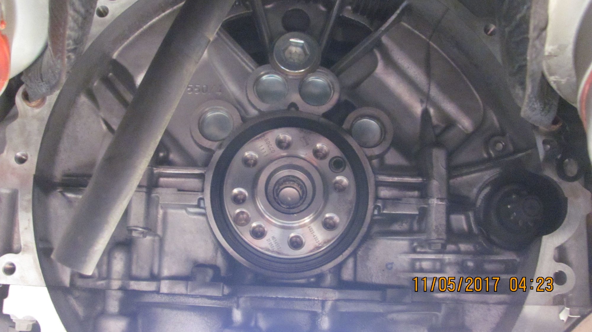

To remove the pilot bearing from the crankshaft I measured the propshaft that fits in to the pilot bearing.(19.00mm) So I made a bolt , rod , shaft of 18.90mm.
Then you fill up the cavity with plenty grease behind the bearing. Knock the bolt in with a hammer and the grease will push the old bearing out!!

The Crankshaft with old Pilot Bearing
New Lightweight Flywheel.

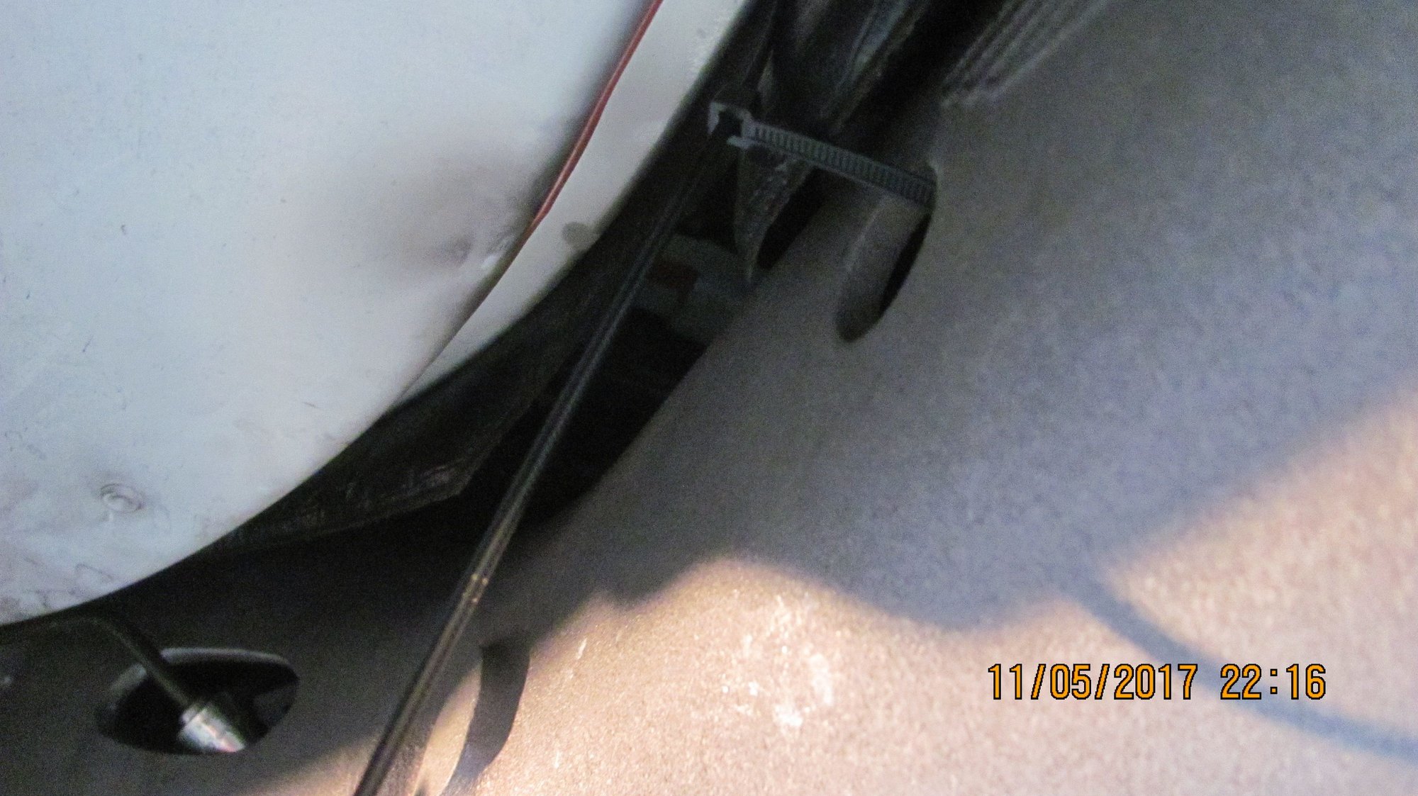

Long Cable Tie through the Torque tube. I did this incase I need to lift the frond end of the propshaft. By pulling on both ends of the cable tie it will lift the propshaft. Before it gets to the clutch plates.
