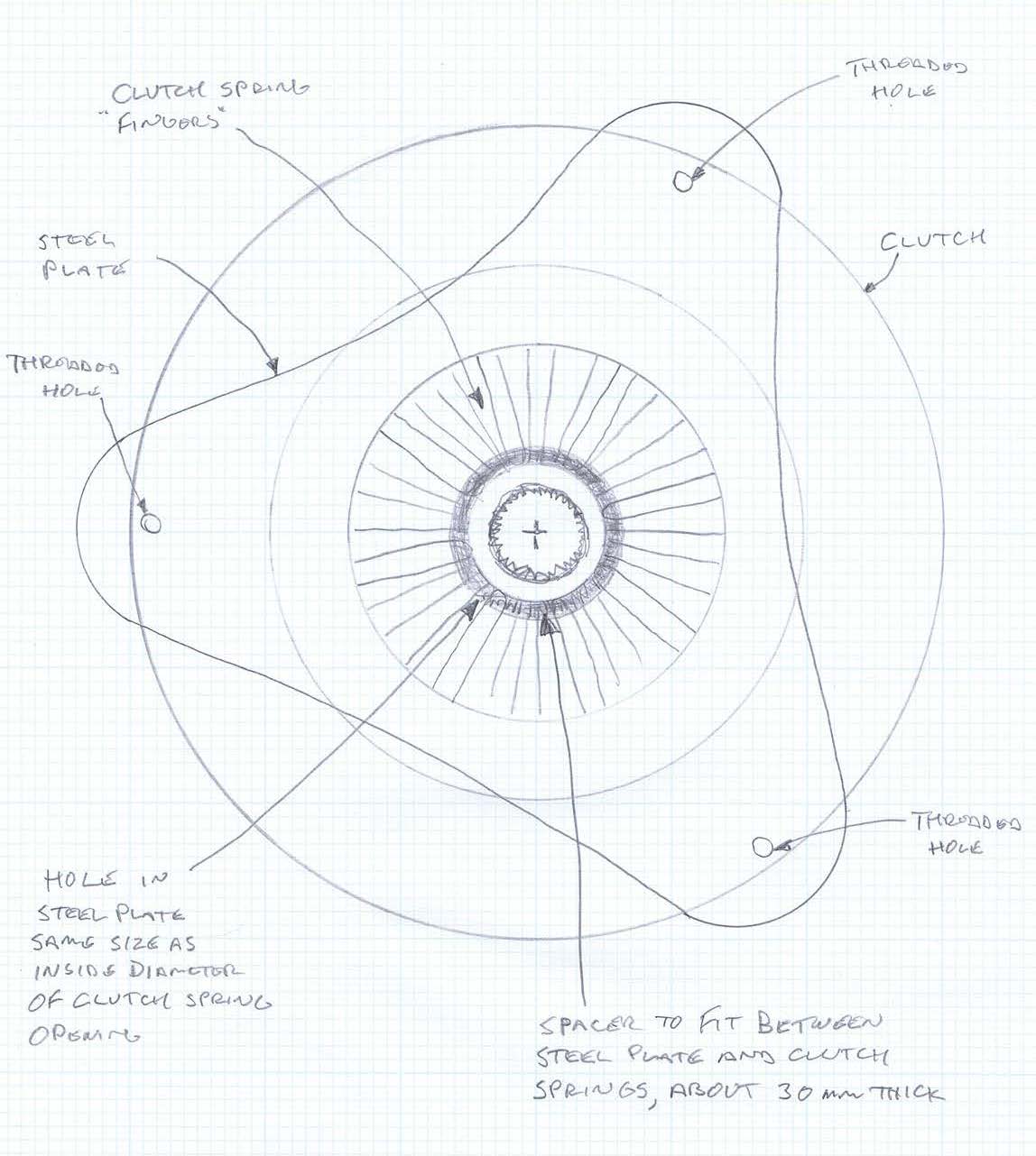

The bolts that attach the twin disc clutch pack are much smaller diameter than the ones used for the standard clutch. The manufacturer specifically told me that they are not up to the task of reliably drawing down the pack to the flywheel. It may work some of the time but probably won't work every time. Since the incremental cost to do it "right" is so low and the cost of failure is so high it was an easy decision to make, especially since I could make a suitable tool from materials on hand and 30 minutes of labor.

Thanks for the information and photos. I just ordered a kit yesterday and will be performing my own install in 4-5 weeks or so.
Jeff, do you have any photos of the tool you made for compressing the V12 clutch? I thought about the commercially available tool and some bolts to interface to the clutch housing. I would rather make something though.
I don't have a photo of the tool but I have a sketch I used to make it. The tool is at my mechanic's shop, I let him keep it.
That is a simple enough tool to fabricate. Thanks for the sketch. Instead of the center hand nut on the factory tool you used the 3 bolts to gradually compress the clutch springs. I will add a pilot on the triangular steel tool so the cylindrical spacer stays in place easily.
Correct about using the bolts to draw down instead of the center nut. I had a piece of pipe that had an end cut down to a smaller diameter that fit in the center hole so the spacer stayed in place. Sorry about forgetting some of these details, this was done about 18 months ago...
No problem on the missing details. I only repeat them in case someone else uses this thread for reference in the future. I am a mechanical designer for a living so I already thought of those details looking at your hand sketch.
