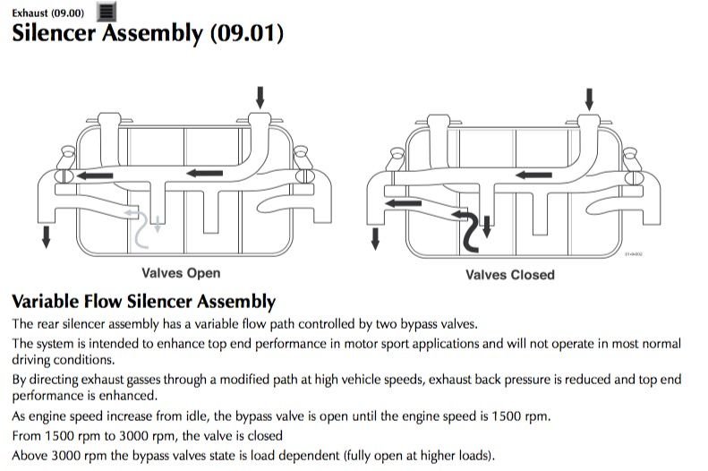

As far as I know the original valves bypass the muffler completly when open, that is when you still have the AM backbox.

Do you know whats inside oem rear silncer box? When bypass valves open, is it straight out to tail pipes or still flows trough some silencer tubes?

I am 100% sure that the open flaps enable a complete bypass of the silencing parts of the back box, look at the image from the workshop manual:
