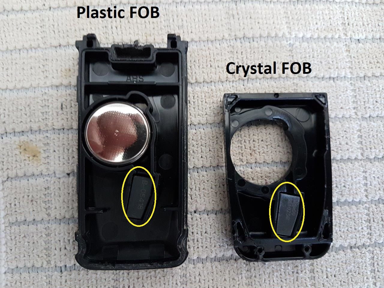

So I don't know if anybody did this successfully as what I found is it can't be done easily (see last post)
I have been searching for an answer and so far I am not 100% sure, so is the internal of a working Plastic Fob can be transfer into a none working Sapphire key? I know that the little black chip in the back cover is what make the car start, but does it have places for all the parts to fit in?

Yes - the internals of the plastic key will fit the sapphire key. I just had this exact procedure performed a couple of weeks ago by the dealer.

I did this and it was fairly easy. Believe that I posted some in a thread with photos, may want to use the search to find it

That's what I did. It was a about a year ago, so it's from memory.
On the glass key there are two very small screws, and I believe the metal slides off. And then yes, I believe that I had to cut it open to access the circuit board. Swap the plastic board into the glass key, glue and reassemble. Took about 15 mins. Dealer was surprised ;-)

Over the winter I was able to find a Crystal FOB in excellent condition (never used) but programmed to another car at a reasonable price. Today I proceeded to do the internal switch over from one of my Plastic FOB but first I wanted to see if Irish07 procedure to programme a 3rd FOB would work with a FOB already programmed to another car. The procedure goes as follow:
1- Start the car with the 1st FOB (Already programmed to my car)
2- Start the car again with the 2nd FOB (Already programed to my car)
3- Start the car yet again with the 3rd FOB (Newly purchased used Crystal FOB)
all this has to be done within 10 Seconds or so.
I am glad to report that the Crystal FOB is now programmed to my car :-)
Now onto swapping the Circuit Board from the plastic FOB to the Crystal FOB, it was pretty straight forward:
1- unscrew the 2 screws on the back of the Crystal FOB
2- slide the chrome piece down and push the plastic internal from the side, be careful to hold the key with the buttons down as they will fall out as they are only held there by pressure from the plastic internal
3- I removed the 6 screws for the battery but that wasn't needed
4- Here it gets a little tricky as they 2 pieces are glued together so you have to pry it apart without damaging anything (see picture for glued point)
5- take the plastic FOB internal circuit board and place it inside the Crystal FOB
6- I tested that the Crystal FOB was able to open/close doors and trunk and light
7- reassemble everything, you might want to put a dab of glue to hold the two pieces together.
So that finally answers a lot of questions that people had (including myself) about this swap. Remember I am not responsible if you damage your FOB by following these steps, good luck. See below a few pictures I took while I was doing the swap
