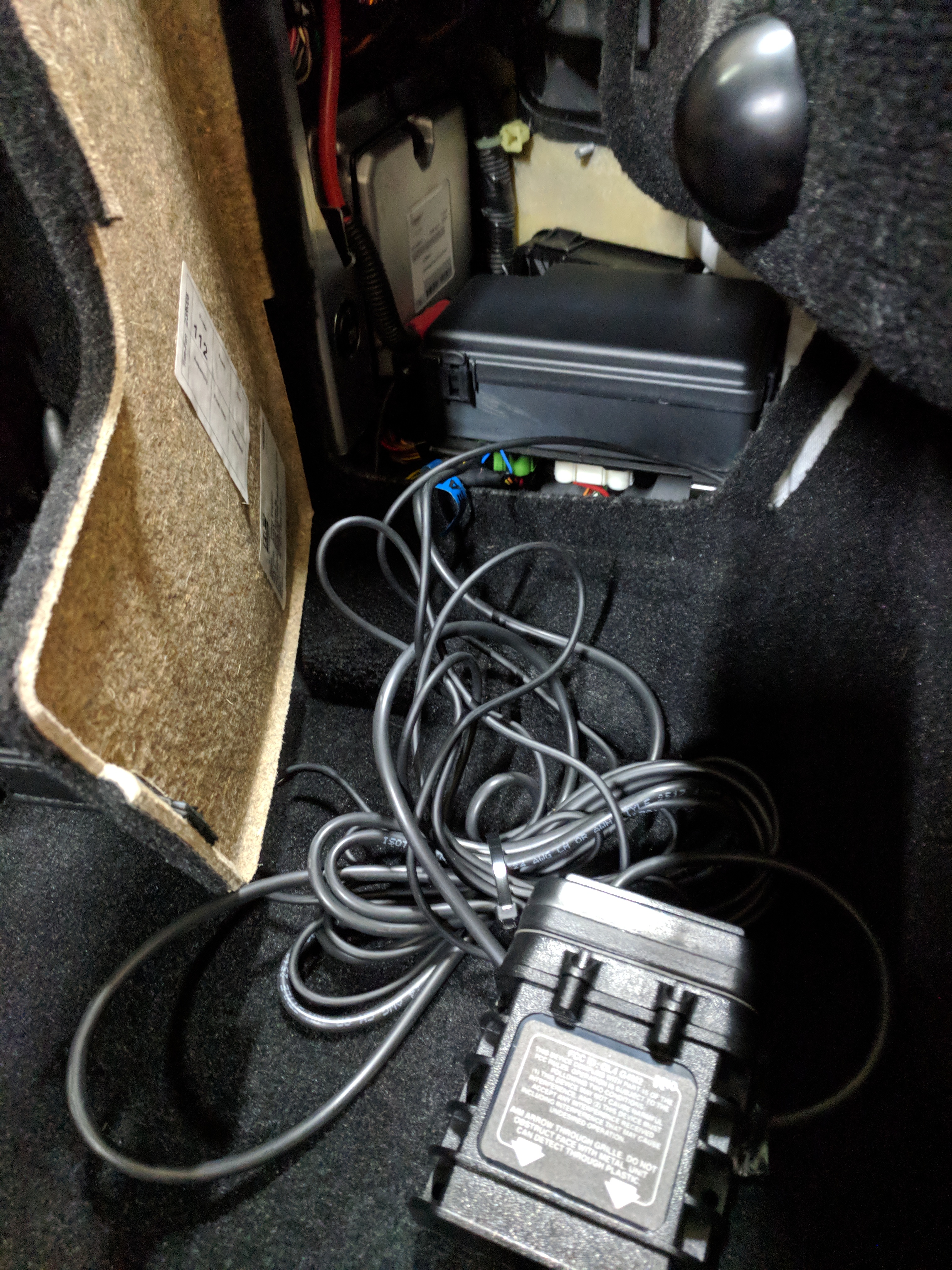

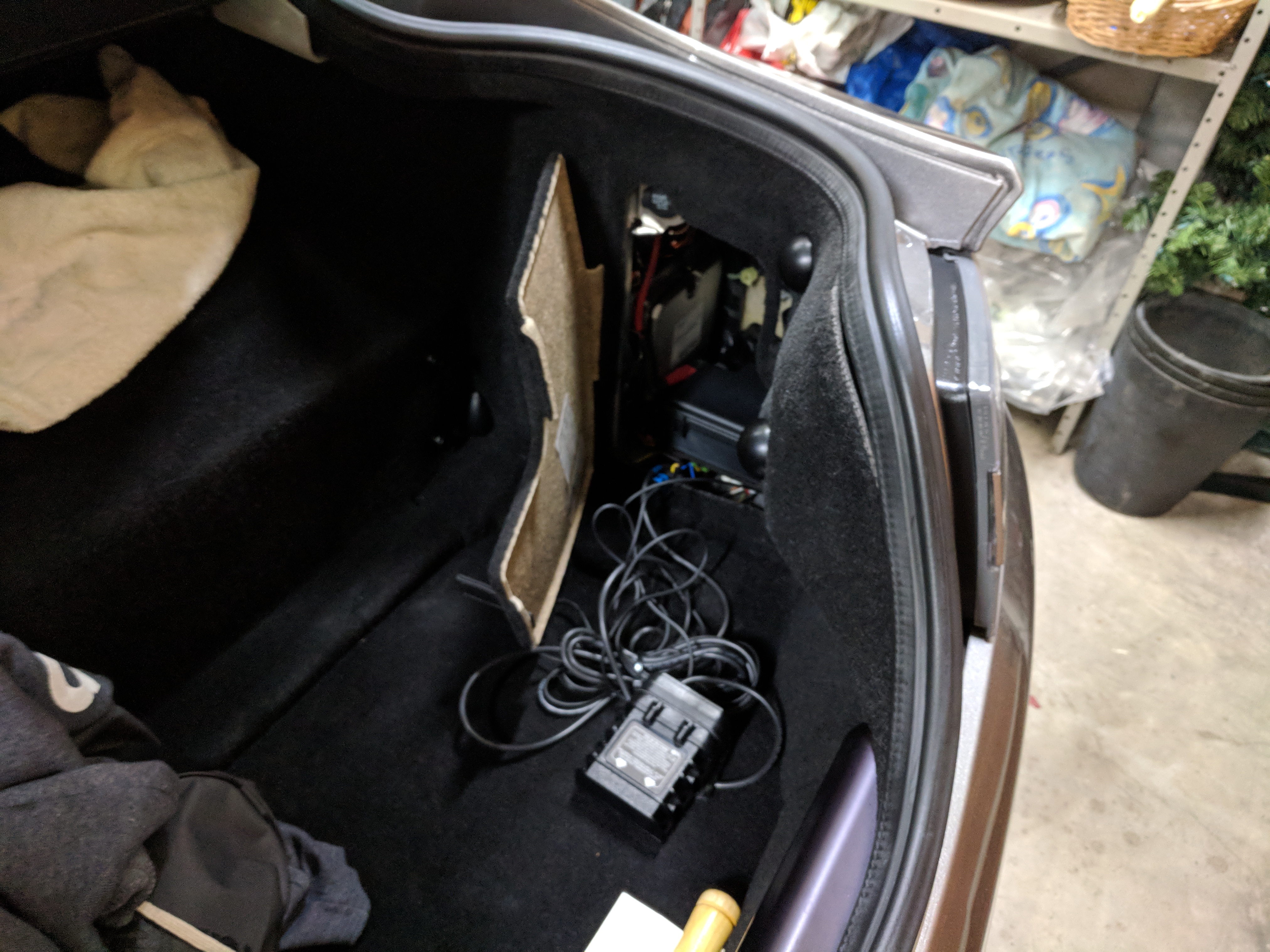

Cool Can someone tell me what the @#$@ is this in my trunk
again, i was supposed to make a new thread to introduce myself, but i keep making great discoveries. just picked up the car two days ago.
was poking around inside of the trunk and found a tab and low and behold, i found THIS
can someone tell me what i am looking at here. looks like a some kind of voltage converter/ballast, with wires attached to it. and the black box sitting inside the corner, is that the fuse box, or lunch box, jack in the box? i don't think i want to open it. to be clear, the voltage converter looking thing was sitting on top of the black box when i pulled open the tab, and those wires were tucked inside the corner.

The box with wires looks like a grille mount (hidden) antenna for a radar detector.
The big black plastic box is just the fusebox.
Tip - Pull fuse 22 if you want your exhaust to be open all the time, rather than just over 4000 rpm. Growley but not obnoxious.

The black box with wires IS a Radar Detector module for installed detectors such as the Escort Passport. Likely the Rear Antennae not used but stored in that area. You might have one installed in the front and dont know it. Look for it, if found, then you possibly have one in the car and once found can use it.
I found one in my RR that I had no idea it had. K40 totally hidden and Remote control to run it. Had to buy the remote to make it work. But works well

"Aim arrow through grille, do not obstruct face with metal. Unit can detect through plastic."
probably a radar detector that you install on your grill
does appear to be installed incorrectly based upon its location

Nope, for sure a radar module!
Take a look under around in your front end and see if you can locate the exact same type of box there. If so and its mounted, then you most likely have at least a front warning system installed and the rear was A. not installed B. just stored in that cubby in the back. Now, if the back one's wires are somehow attached to something in the back, then its is installed also.
Then start looking in your ashtray, under dash in front near drivers side, inside center console if you have one, etc.... for the small PassPort module. You may have a K40 which doesn't have an electronic view plate and is run by remote control. Then you would look for a roundish speaker mounted under the dash somewhere also. Then it would be tracing it and see which model you have, ordering the remote and seeing if it works. Thats what I did and mine works fine, but only front sensor is mounted on mine.
Hope that helps, you will have to search a bit ti figure this out.
Also, part number or module number or company name on the trunk black box in google will help you some too.

That is the rear radar receiver for some version of K40. Could be remote or hardwired. As previously stated, look under the dash for a speaker and possibly a control pad/switch. It's always nice to get something for free
