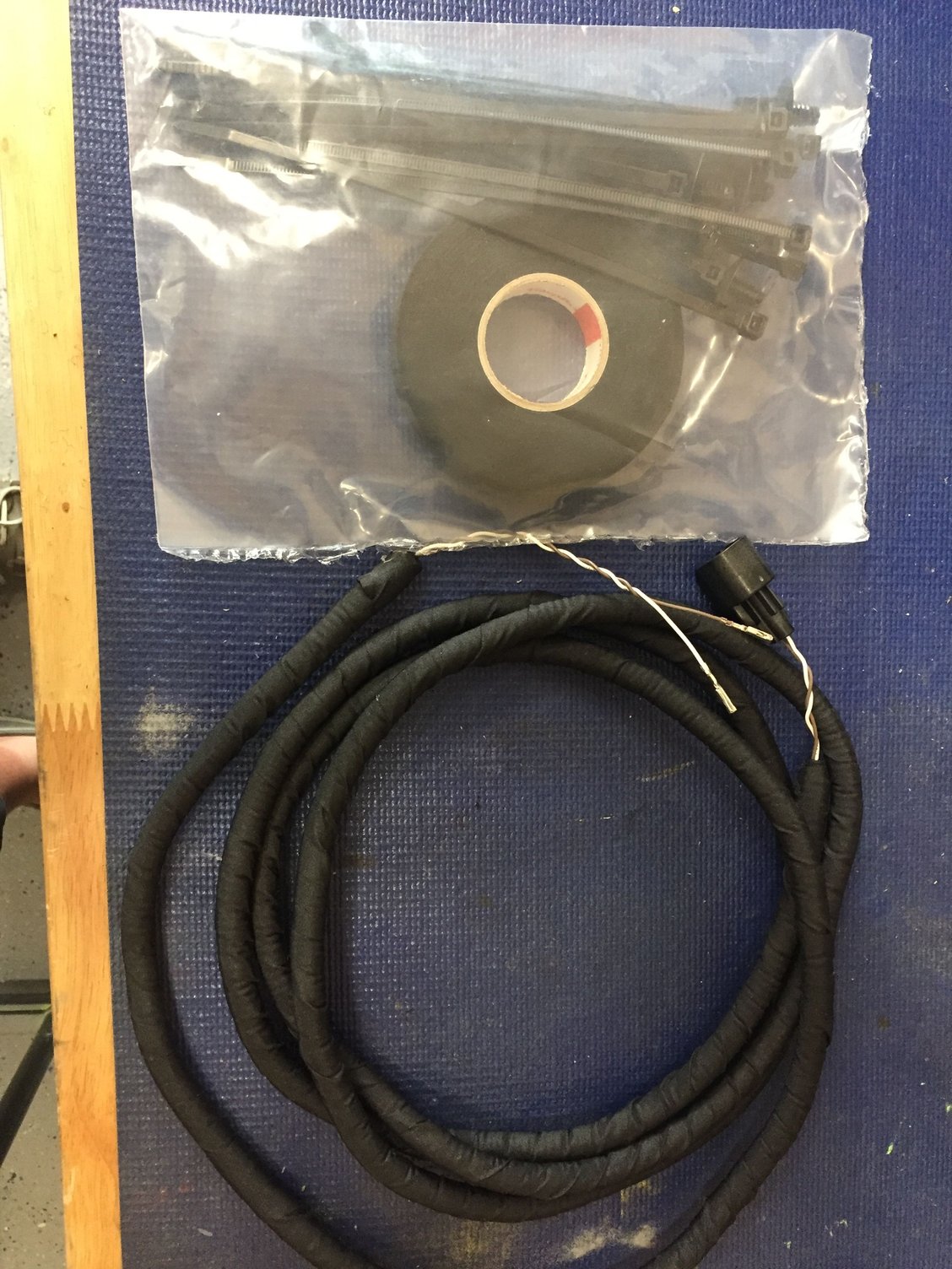

Update.....
Pictured is the damage area after I accessed the harness section removing the tie wraps/studs. Also the harness assembly part number 6G43-90-10445, LH wheel speed sensor harness assembly.
I cut a section with the new plug off the new harness (the harness intersects another loom/harness across the car so I didn't want to disassemble the loom all that way) you can see what came in the harness assembly, the harness, ties and tape.
I used heat shrink to splice the new plug on, re taped a bit better than the factory since they left 6 inches of wire exposed.
Installed the plug and all the lights reset/extinguished.
