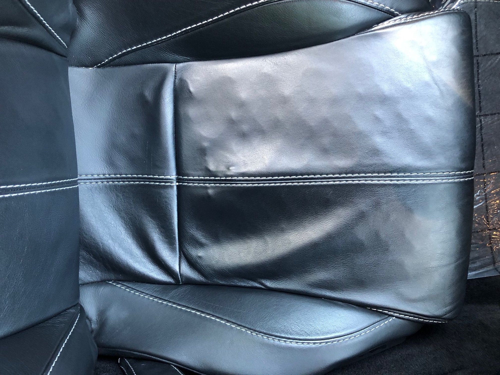

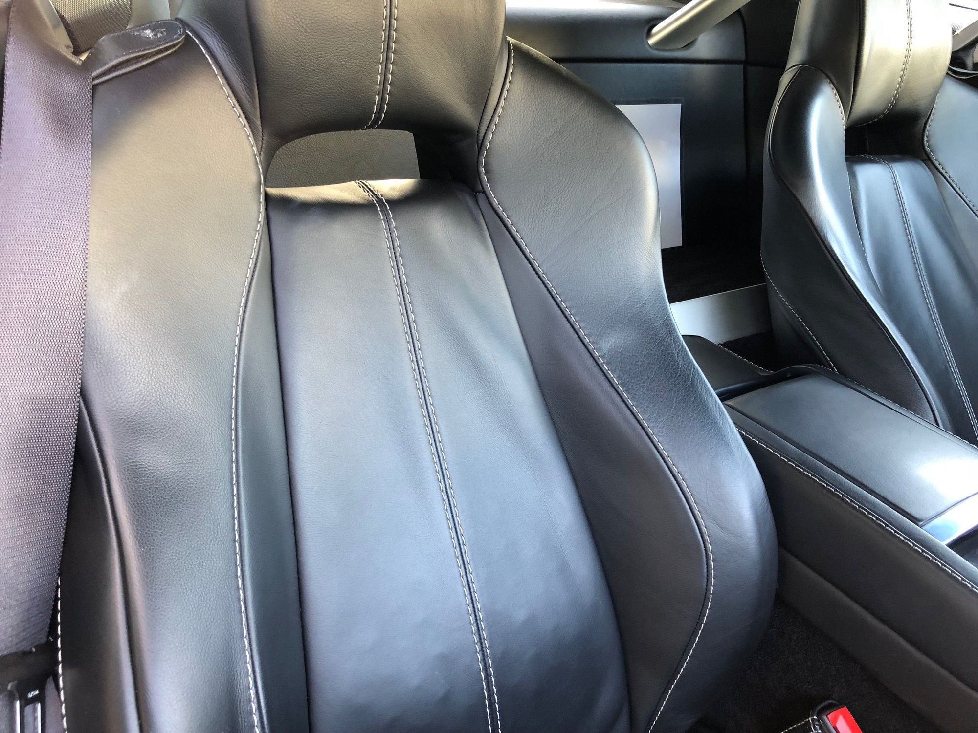

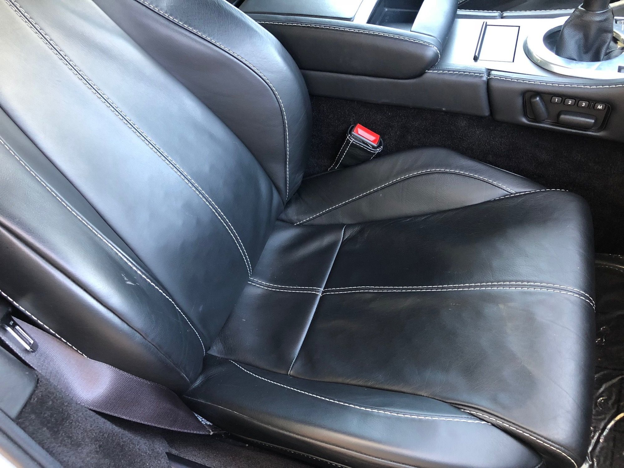

Here are pictures of the seats. They appear worse than average. The dealer states that the dot "pattern" looks worse than it is. They don't think the you can restore or pull back the saggy leather to make it more taut.
Has anyone restored the saggy parts?

WTF happened to those?!
Somebody here had really sagging leather and found out it was because the conditioner was breaking up the foam underneath, they replaced the foam and they looked great. May be the same problem there?

blown motor, poorly worn seats, sounds like this car wasn't very well taken care of... are there service records?

Redone leather
Reminds me of my ex-wife - I'd have the seats professionally redone - DEMAND Weir Leather - my seat guy told me the leather he uses is better - it was not! Showed discoloring after a few months - the price was the same $5000 for both seats, keeping the good leather, replacing the bad, adding some cushioning, and then the Vanquish pattern probably was $1500 of that cost. Shortly after I demanded they replace the leather with the proper one they went out of business.

$5000 to redo the seats! That's expensive Prefurbia!
Cannonball, I'm kind of thinking the same as you.

That pattern is from the seat heater grids, those are horrible. 7 owners with a lot of friends! They could be fixed but for what price would be acceptable? I think you need to move on from this project car for $60k
Yes that was me. I took my driver seat out and brought it to a leather shop and received a call the next day from the owner saying my foam had disentigrated and that there was a gooey substance behind the leather. After I shared the yearly application of leatherique that I massaged into the seats, he said the leatherique had destroyed the foam over he past 9 years. He replaced the foam and and stitched the seats back together. They are now 90% and I no longer use leatherique.
