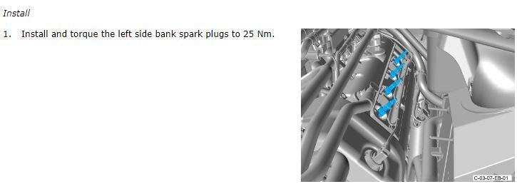

The build manual for the 4.7L that was used for Cologne stated 20-30Nm. The WSM from Aston states 25Nm..counting pellets really but those are the 4.3/4.7 specs

03.07.DB is just code for spark plug set, doesn't reference any engine. Basically it's a warranty code that is also referenced in the WSM to make life easier for tech when stating what procedure was done. If the tech was doing just the left bank, code would be 03.07.EB..doesn't matter if it's a V12 or V8, code would be the same if parts applied to vehicle. The VIN would dictate which engine platform for warranty to pay out correct time..nonetheless, that's why V12 and V8 have the same code for spark plug set replacement of 03=(engine component) 07=(ignition system under 03 category) DB=(spark plug set under 07 category)
The spec I posted is in the newest manual for 4.7L V8 Vantage, it's an online version, not a PDF. Believe it can be accessed from the techinfo site but you would need to request info for something like a 2013 V8 Vantage S.
