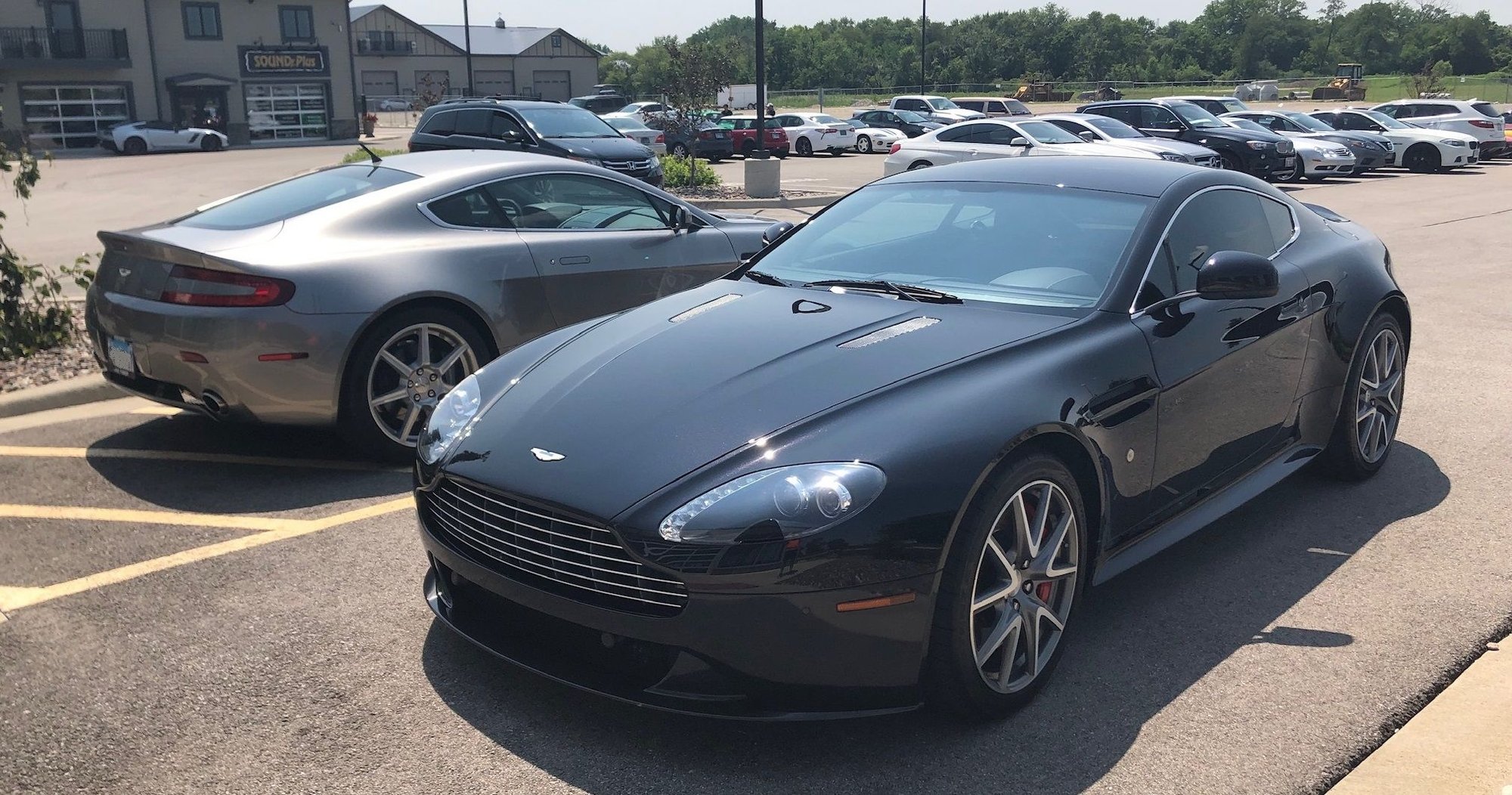

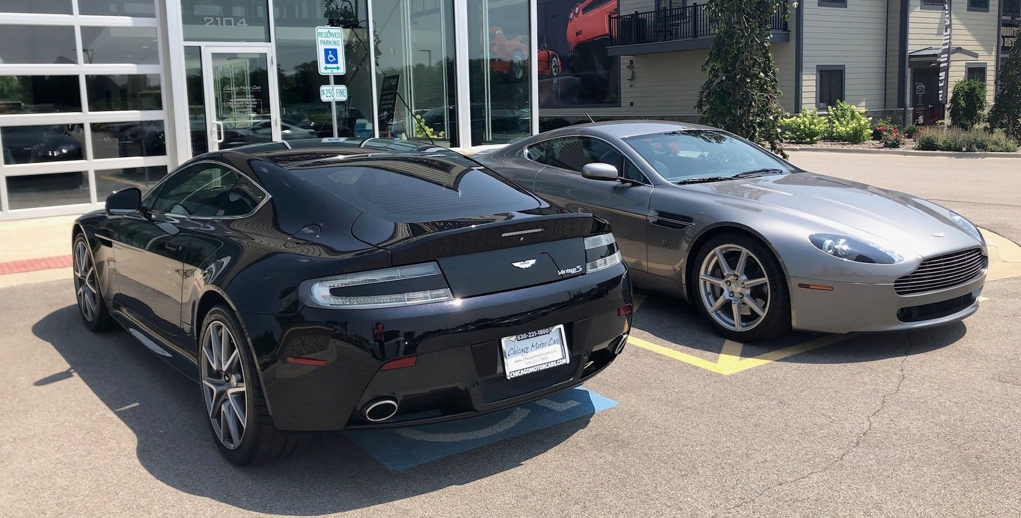

About 2 weeks ago, I traded in my 2006 Vantage Manual for a 2011 Vantage Sport Shift.
I know I am in the minority on this forum, but the I was TOTALLY DONE with the Manual transmission in my 2006 Vantage.
Since I got the car (2 years ago) I have vacillated between "I like the nostalgia of the old school manual transmission" to "UGH - I wish I did not have to manage this incredibly heavy clutch".
This summer the northern Chicago suburbs have been one continuous construction zone and after weeks of construction congestion merging (2 lanes in to 1), I found myself walking right past the Vantage and getting in my 911 (PDK) for my daily commute.
So, I started doing some shopping....
Found a beautiful 2011 Vantage at Chicago Motor Cars (first experience and they were awesome to deal with) and traded the 2006.
I am really loving the 2011.
On paper, the power difference between a stock 4.3L (early car) and the 4.7L (later car) is only 50 HP, but in reality, it feels like A LOT more.
In most city driving situations where I am in the lower / middle of the RPM range, the 2011 feels so responsive!
The 7 speed Sport Shift II is great - no complaints what so ever!
For anyone interested in a nice (2 owner) 2006 with 13K miles - the car is listed on Chicago Motor Cars site (I have no affiliation) in the low $40's.
(Not sure what the rules are on posting links, so you will need to google)

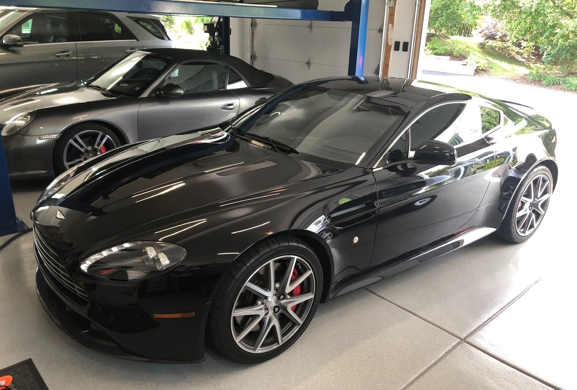

Update - Drove the car more and Tire System Fault light is not going away.
Tires - best I can tell, the tires on the car are the second set, and based on your responses, it makes sense that the sensors are original and approaching the end of their battery life. Changing out the sensors before the tires are "used up" does not make sense - not worth the extra risk to the rims for a remount.
