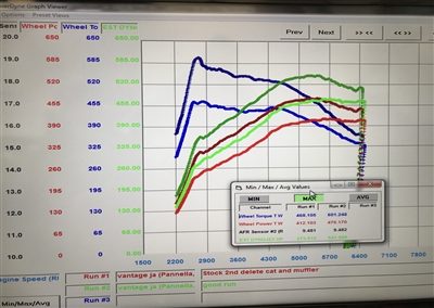

Hello,
Glad you found us! We have had ECU Tuning available for the New Vantage for nearly a year. We're running a very safe calibration which makes around 580BHP. Properly documented & calibrated by our Software Engineer Chris Edgett (15 years as a factory trained Tech.) We currently offer secondary cat deletes and lowering springs for this platform, and are finalizing some Beta versions of our primary cat deletes, valved exhaust and larger tail trims.
We're also doing some work with our UK distributors on their own Vantage, being documented on the dyno and verified in the real world. They ran the car from 50 to 150MPH (under controlled conditions) against a Huracan Performante a couple weeks ago and it was a dead heat.
