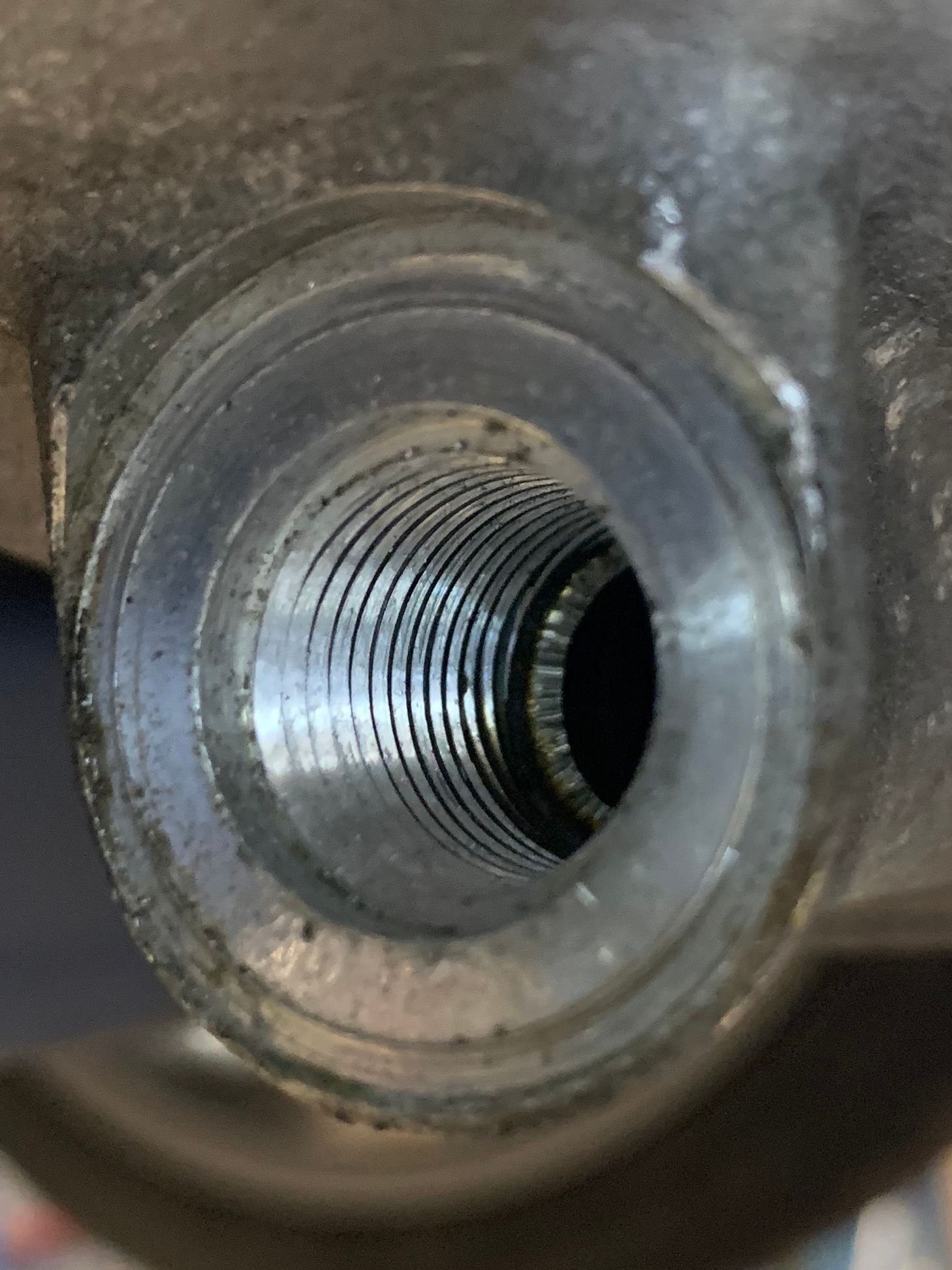

Hi, guy's.
I did oil change on my car for the first time since I bought it. Before me it has been serviced only by Aston Martin.
Started to drain the oil from front to back. But when I loosened the last oil plug it felt weird. AND that feeling was right. The threading is almost gone...
Most likely from over-torque in the past.
So... I'm thinking Heli Coil. But then I am not a professional.
Anyone here that know the right solution for this?

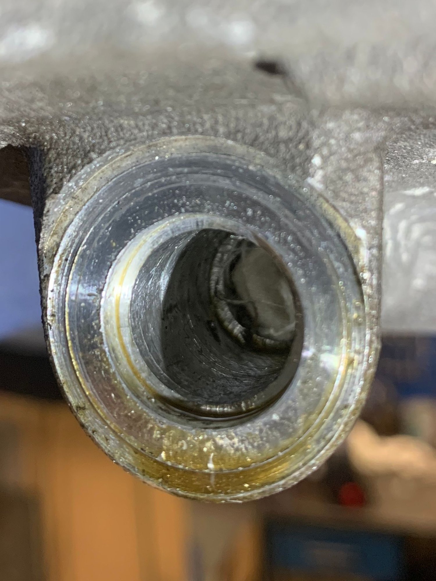

That sucks. What incompetence it must take to keep driving in a thread that doesn't feel right. They probably used a power driver, a no-no on aluminum threads.
The risk of tapping a new thread is generating debris that gets into the oil passages. Especially considering where this plug is. If you do end up using a timesert, try to have a vacuum nozzle pulling on the bit as it cuts. Personally, I'd just try recutting the threads a bit with the current thread pattern so that the plug can be easily installed and removed. The oring does the sealing so you just need the threads to be strong enough to hold the plug in with sufficient pressure.

Mm, debris is the downside of making new thread. As you suggest, vaccum is a must. I'm also thinking of pushing in a loosely wrapped piece of linen, as extra protection. And then (with some luck) vacuum both debris and linen out...
Regarding refreshing the original threads. Could absolutely work but sadly I don't think I could sleep well, knowing that it isn't 100 %.

Looking at your picture, there seems to be some heathy thread (4-5 turns) left inside.
Maybe a longer plug will do?
That could absolutely work.
But I would like to keep the OEM plug. Maybe I am a little bit picky but that's the way I am...

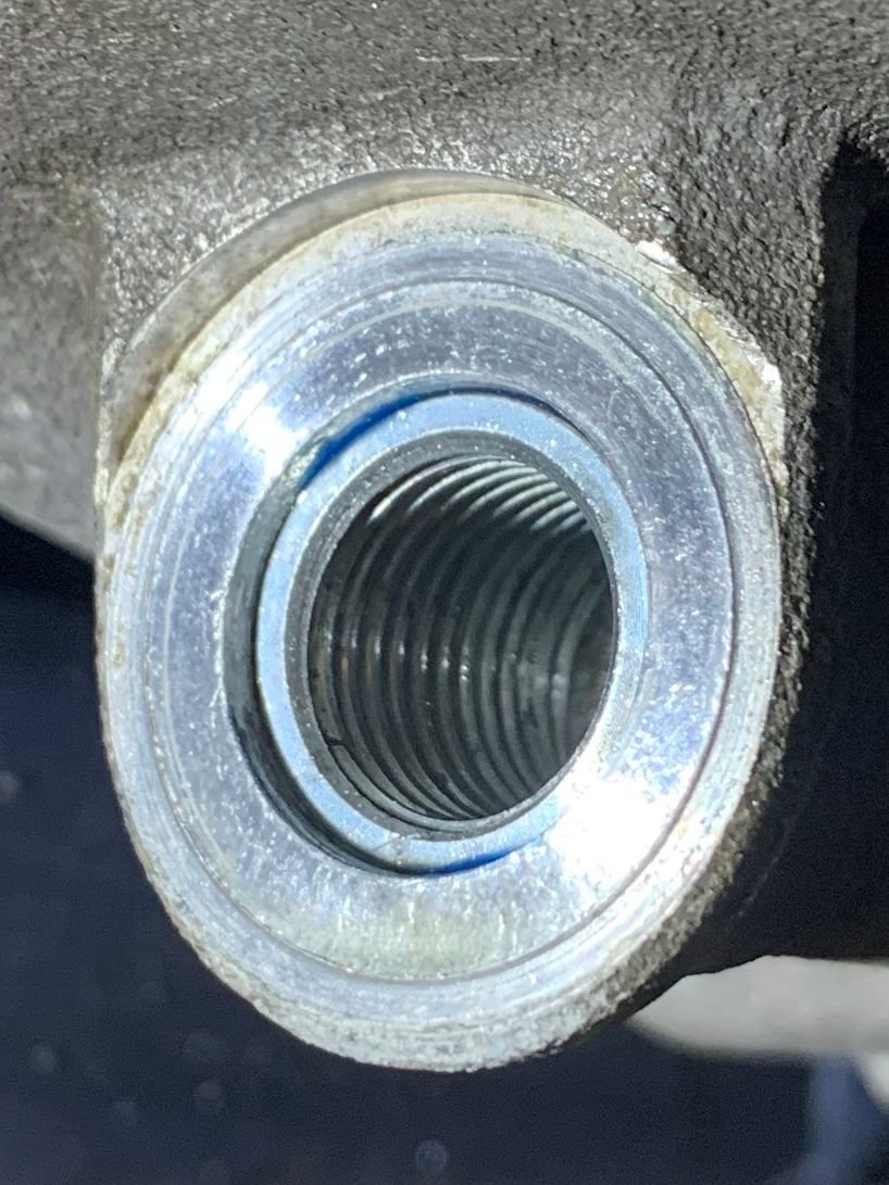

Thanks for all info and good idea's, guys!!
I choosed to go for the time-sert solution. Just got my hand on a kit and I'm hoping to get it done later today.

The loose linen is a bad idea.
My suggestion, Put the plug back in and finger tight only. Put a couple of quarts of cheap oil in the engine. Prepare tap with liberal amount of grease. Remove finger tight plug and immediately introduce tap to oil pan threads. Any shavings debris should be forced out as the oil drains. Once tapped introduce your desired solution.
Good luck.

That would certainly minimize the chances of debris getting up into the pan but I doubt someone could adequately line up, start, and run a tap while oil is spilling out on them. Let alone drill the larger hole for a timesert. I have no idea how that would work.

For some reasons I can't upload all the photo's.
There is a lot of videos regarding Time-Sert on Youtube for those of you who don't know about it already.
The new thread insert in place. Job done!
