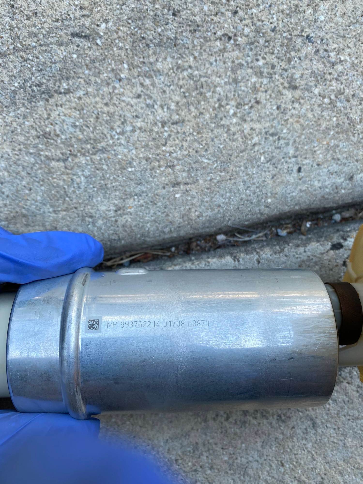

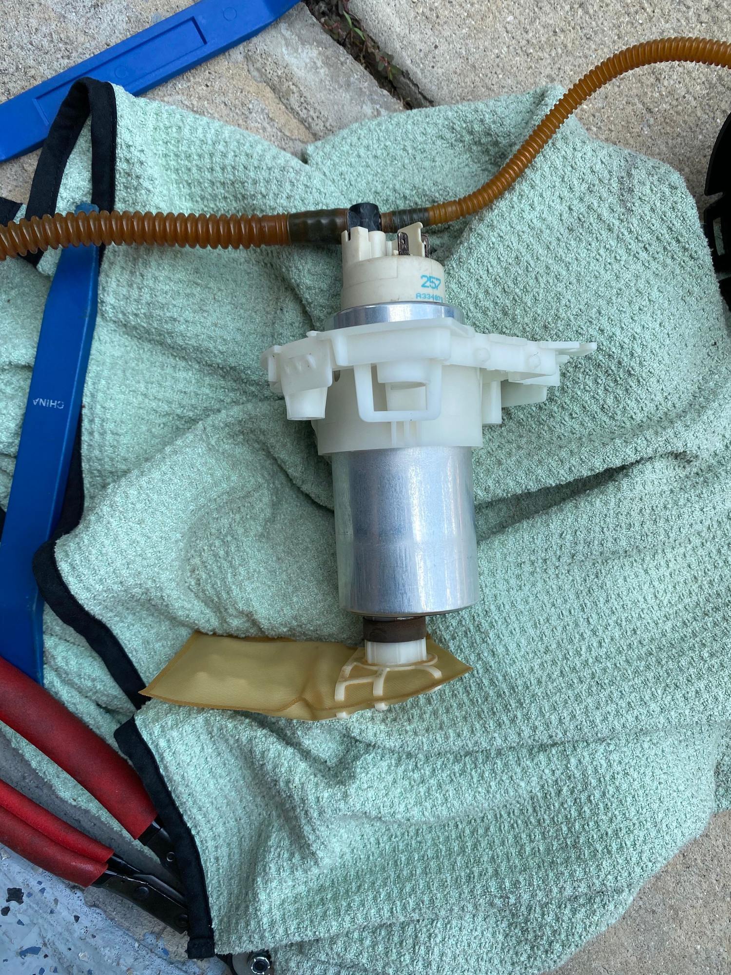

Here are the pictures of fuel pump with some part numbers on it

if you search "MP 993762214" exact fuel pump shows up but its all Ukrainian website which i can't read and can't figure out if they will ship to USA?

Right next to the model number, there is a Q-code (or what ever the thing is called) to take a picture and bring up a website
I think it’s called QR CODE I tried scanning it with my iPhone but darn thing is too small

Well I tried and zoom and cropped it
it reads but it does not recognize any product here it is as attachement
