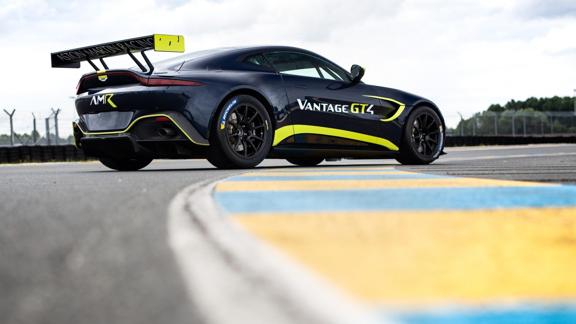

Drop a plum bob from the trailing edge of the boot lid to the floor. Move the diffuser rearward until it touches the line. If the line does not clear the bumper you could consider adding a rear spoiler or try to get a GT4 wing. The trailing edge of the diffuser needs to extend out some from the bumper.
I think you should slide the diffuser aft and up until it aligns with the trans cover. Tape it in place, drop a line, and take a look at it.
Also - I would not count on using that diffuser, rather it could end up as a mock-up for a bespoke which you necessarily fabricate.
The problem with OEM, especially at the Mustang price point, is it designed around form rather than function.
If you build bespoke consider working closer to 8 degrees.

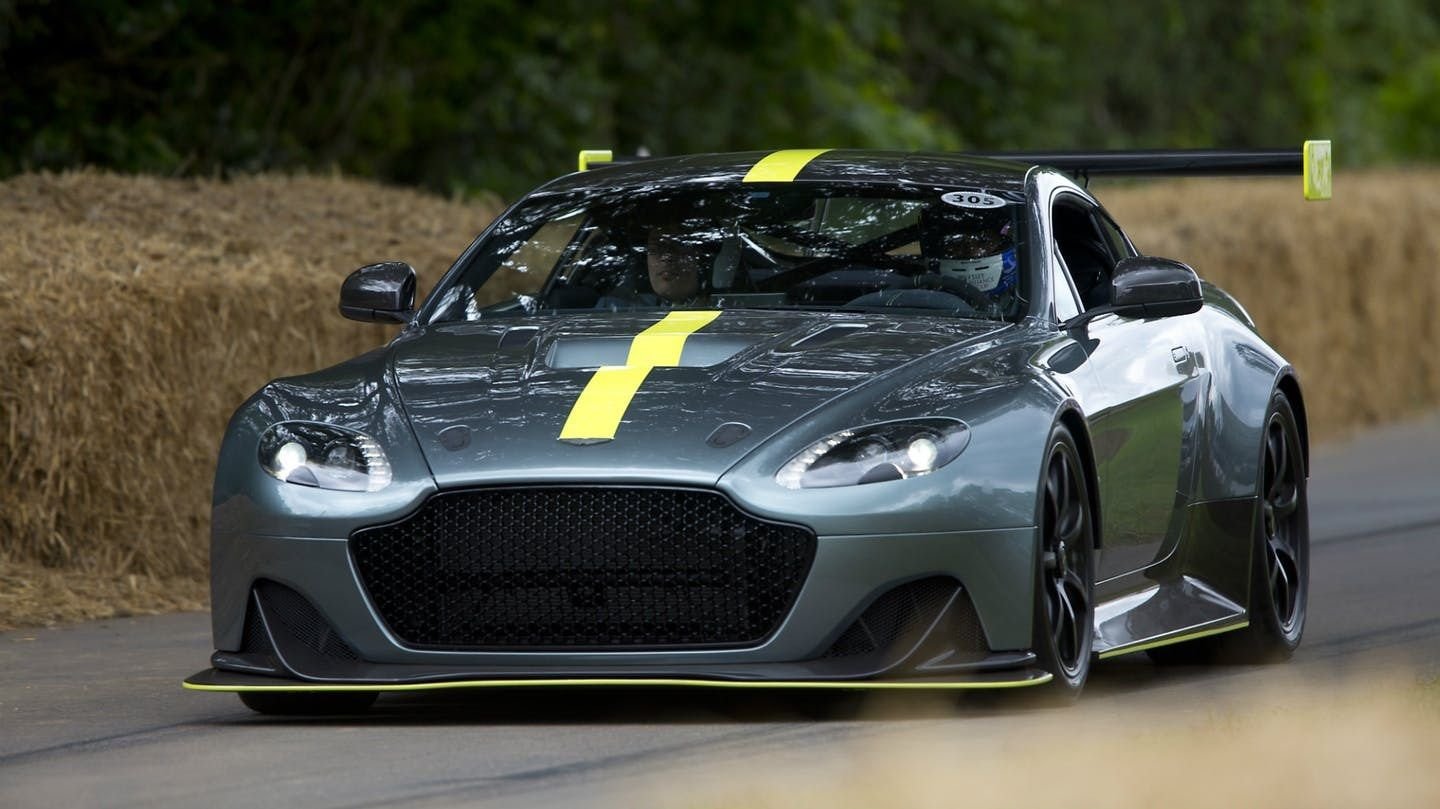

Opening the front sounds great, I love the Vantage AMR pro grille.

Zett, I love that AMR front and thought about going with that one but once I saw the 2019 trim on ebay my design light went off... I think the dash on the new design is too Ferrari like... The Alcantra everywhere is too much...

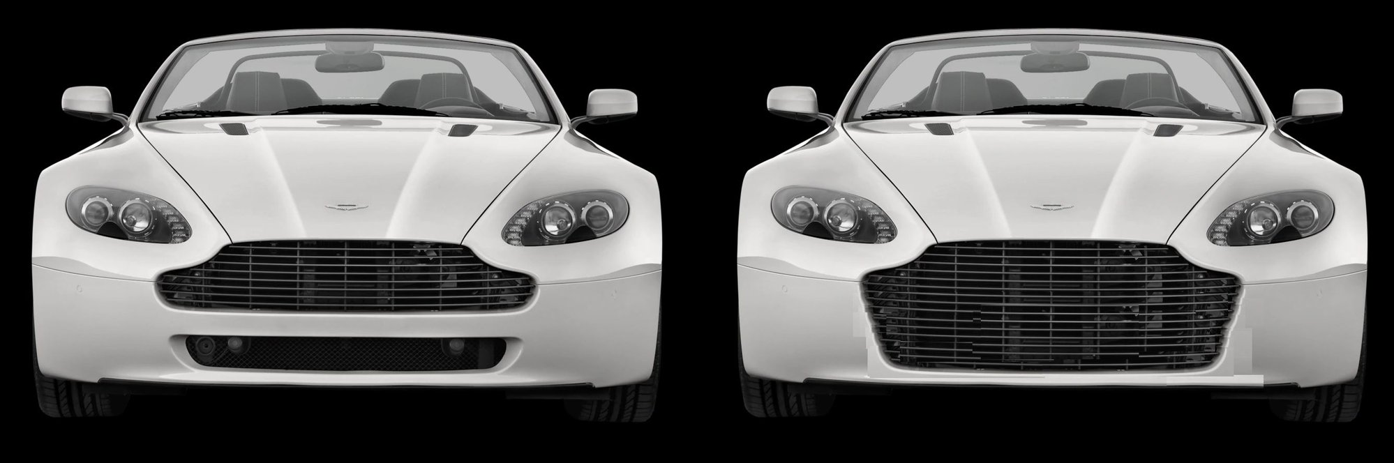

I’m trying to decide if I want black mesh or the chessboard/slat front like the 2020MY. I would have to build a new grill with plexiglass to get the proper radius.
Slats
Mesh

The AMR pro front is not available for sale. The aftermarket big grille fronts go straight down and no angle.

this grille has been growing on me and I'm not sure the roadster one is better - need to see both side by side in the flesh
