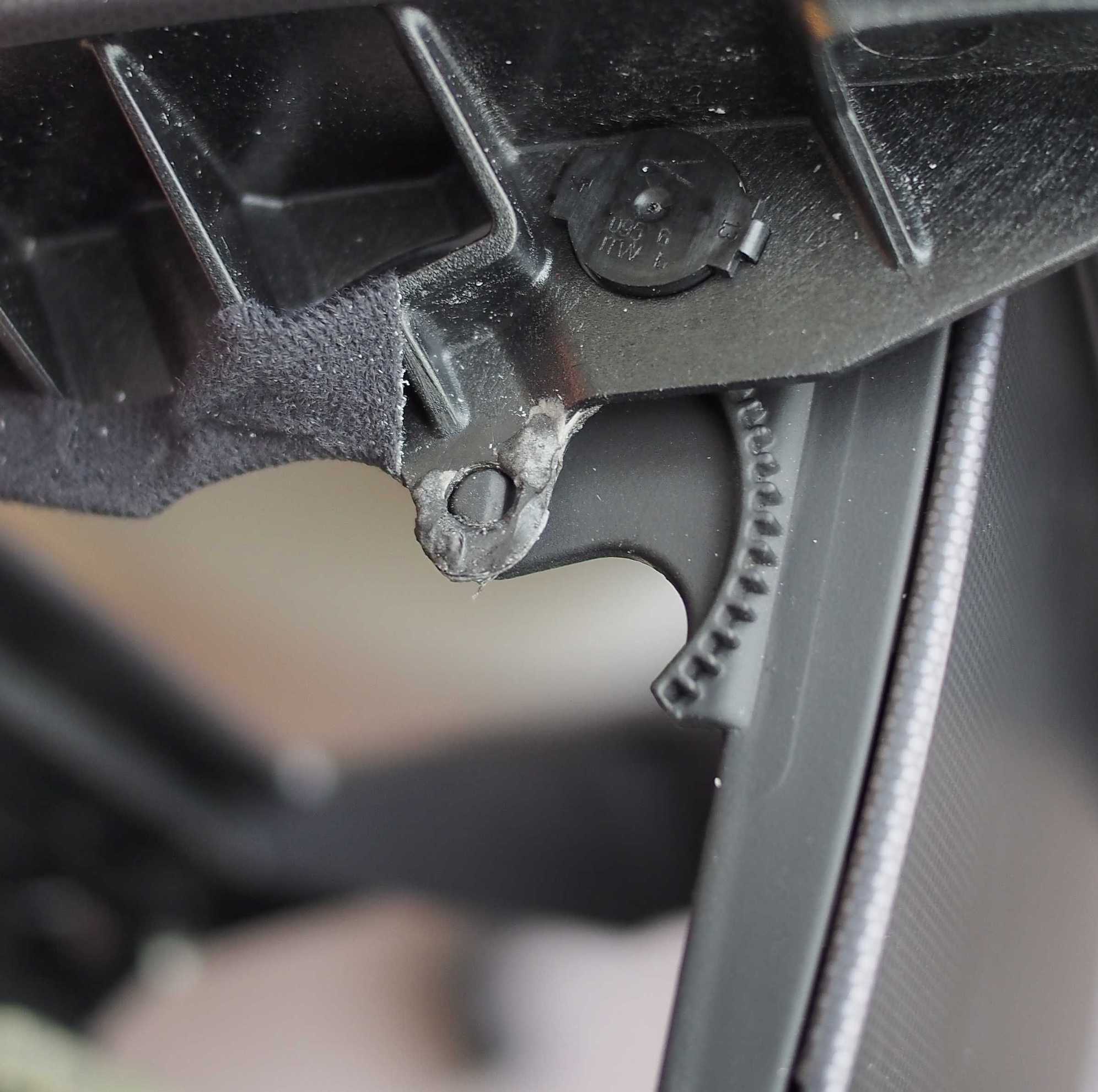

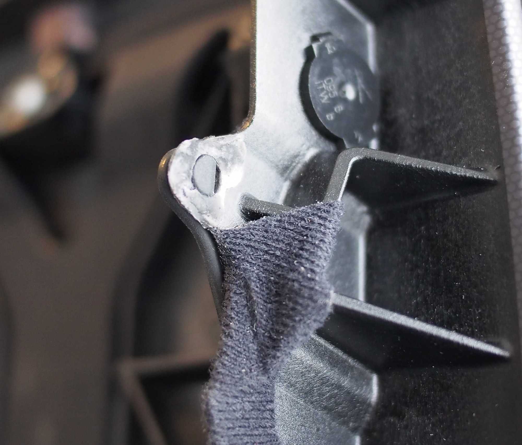

Removing the waterfall
Thanks to Rich for putting out a video on removing the waterfall.
In the comments, I noted that I haven't successfully removed the waterfall without breaking the loops that hold the nav door hinge when pulling on the hole of the open door. I've been able to repair the eyelets, but it's a pain to go through that (see pictures below). Also I found that if I try to pop it out with a trim tool along the outer edges, it indents the leather covered ridge from the trim tool levering on that surface. I wanted to see if I could continue the discussion here to see if Rich or others can provide more detail on their procedures.
