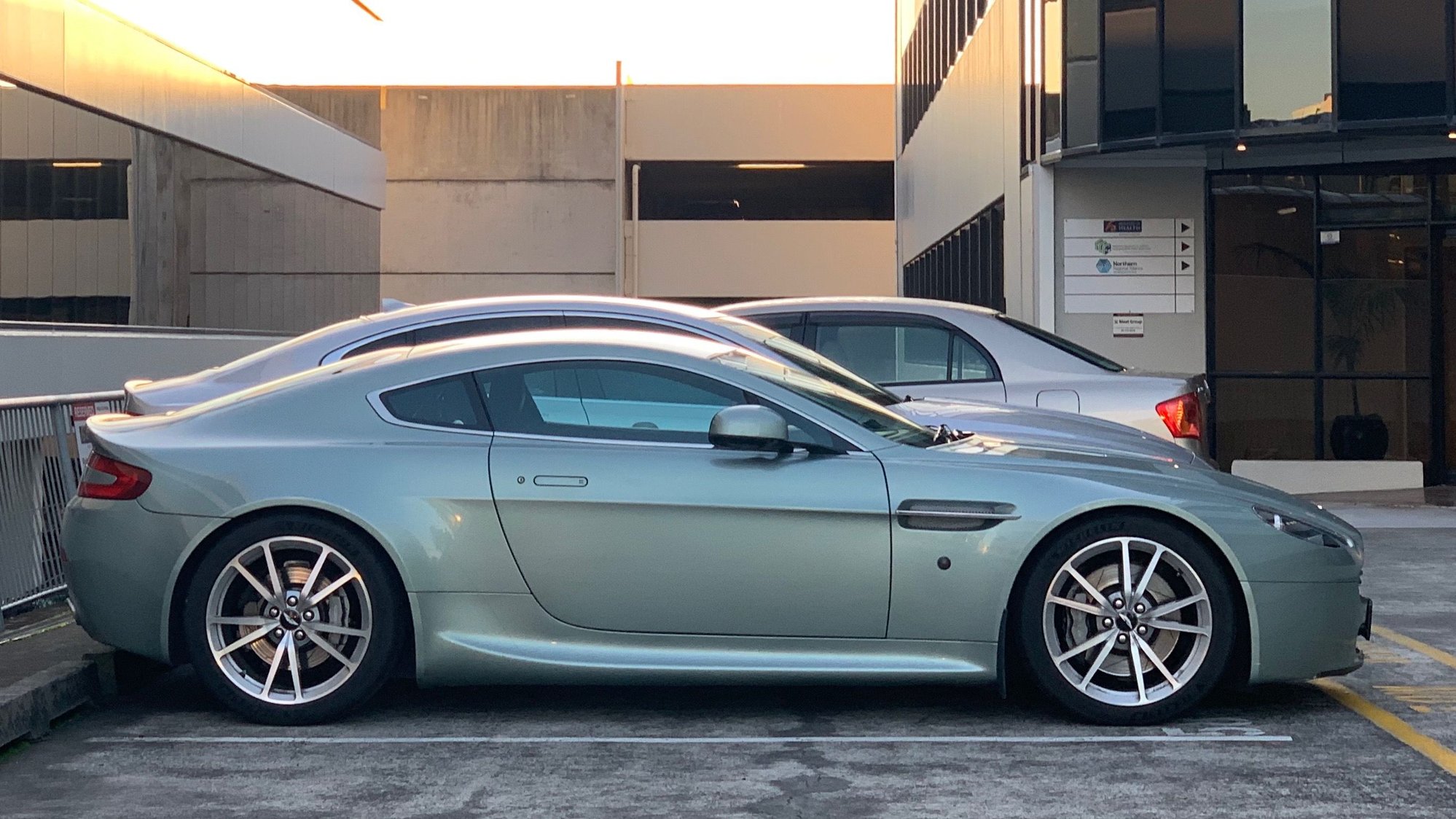

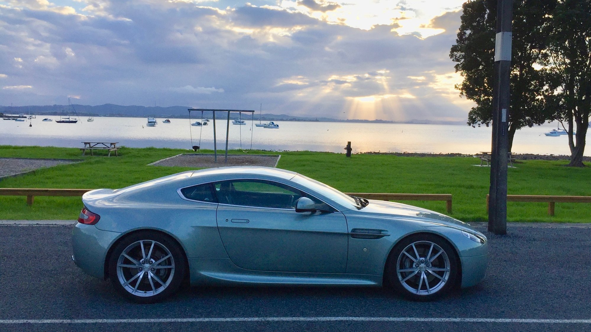

I did this job myself. Front install straight forward but I found the rears quite difficult to reinstall.
As a word of warning on my 2010V8V these dropped the front way more than advertised and too low.(scraped everywhere) Drop was 15mm rear and 35mm front. I think they were probably specced for the earlier model before the bilstein dampers.
I have since put a poly spacer in but it is still more of a drop than the rear. 20mm drop @ front. Make sure you measure before you install to understand the drops.

Are those VAP or H&R ? The front seems a lot lower than other pics that ive seen.

VAP
Yes, I was very surprised too. My shocks are standard Bilstein ones. It’s been a real pain too be honest and I probably wouldn’t bother again. I’ve had coilovers on other cars and at least you can set them as required.
