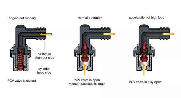

AKAIK In the original design there was a "Ball" or object built into the device that rests over the orifice’s opening of the tube that connects to the engine's valve cover.
The blow-by pressure from the engine had to be strong enough to "move" this ball off the orifice and allow the engine vacuum from the intake manifold to draw the blow-by into the engines combustion’s chamber to be re-burned.
This “ball” was built into the PCV design because the design was never to offer unrestricted vacuum to the engine’s crankcase, but rather to relieve the pressure in the crankcase after it reached a predetermined level.
Now if the PCV valve was not upside down when you attempted to blow through it from the side that connects to the intake manifold, then the “ball” would block the orifice and prevent air flow from that direction.
Later PCV valve designs changed where the “ball” was replaced by a spring; (see attached photo) however the design purpose remained the same, releasing pressure from the engine’s crankcase after a predetermined pressure level has been reached.
