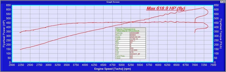

Originally Posted by Redpants
The previous version of the kit was running 6.5 psi, if I remember correctly. Changes to the water injection system, intake manifold, and tuning let GMR safely bring it up to 8 psi.
Dyno of the 4.3L demo/dev car which has well over 100k miles at this point:
