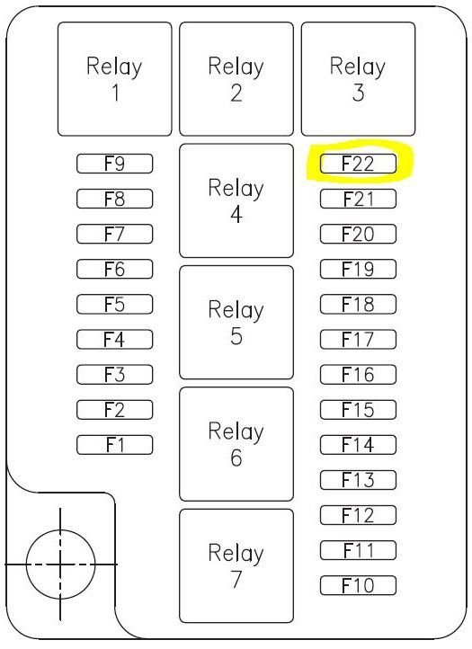

Here is a pic of the fuse box. Which fuse do i remove to have the fuse-22 effect?

Old Sep 1, 2020 | 10:17 PM
J doubleU's Avatar
Joined: Mar 2013
Posts: 2,431
From: So Cal
Rep Power: 262
J doubleU Is a GOD !J doubleU Is a GOD !J doubleU Is a GOD !J doubleU Is a GOD !J doubleU Is a GOD !J doubleU Is a GOD !J doubleU Is a GOD !J doubleU Is a GOD !J doubleU Is a GOD !J doubleU Is a GOD !J doubleU Is a GOD !
#22 but you may want to post your MY as it could be #15.
Old Sep 2, 2020 | 05:17 AM
TiAg's Avatar
Joined: Aug 2007
Posts: 114
From: Miami
TiAg is infamous around these parts
See attached. Please check but i believe for MY2011 and up its fuse 15 (not 22).

Old Sep 11, 2020 | 04:46 AM
michel(houston)'s Avatar
Joined: Dec 2008
Posts: 36
michel(houston) is infamous around these parts
This might sound like a naive question, but is the fuse box the one next to the engine? I looked in the right compartment in the trunk and did not see a fuse box (maybe different on a roadster than the coupe? ) 12 V8VS here
