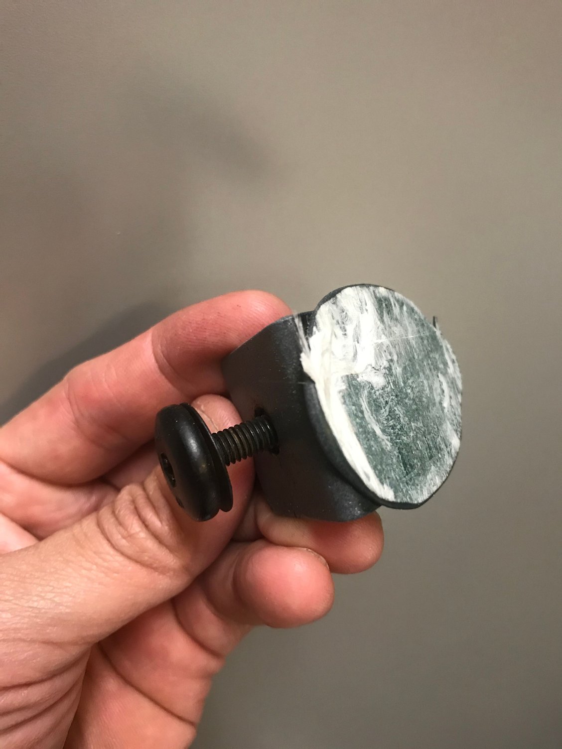

Hey everyone. So I finally received the side repeater from Scuderiaparts. I was able to change it by turning my wheel to the very outward position and didn’t have to remove the wheel at all. There is a t27 torx screw at the very bottom and one right behind the wheel. There is a regular Phillips screw in the bottom corner. Once these three screws are removed, I was able to pull out the black liner and get my hand behind to change the side repeater. Once I loosened the t27 torx screw with the torx wrench, I was able to take off the screw using just my fingers. Putting it back was another story. The torx screw was a bit stubborn and I had to give it a few hard turns. To my surprised, the piece that the torx screw attaches to inside the bumper came off. I doubt there is a way to attach it back. I think the screw is stripped as it won’t go back in.

Originally Posted by hsm precision
Interesting - I had exactly the same problem. To re-attach, I was planning on using a body adhesive. It's still on my to do list though...
Matt
Matt, even if reattached, the screw still won’t go through. Did you just leave it open for now?
