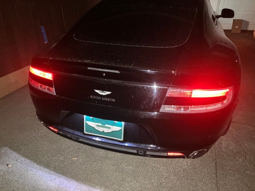

Hi,
My 2011 Rapide back light recently seemed to have gone out. However the break light and blinker still seem to work. Does anyone have any suggestions as to how to fix this? Is this a DIY job?
Thank you!
Backlight doesn't work when driving or parked.
But the brake light works.
Blinker also works

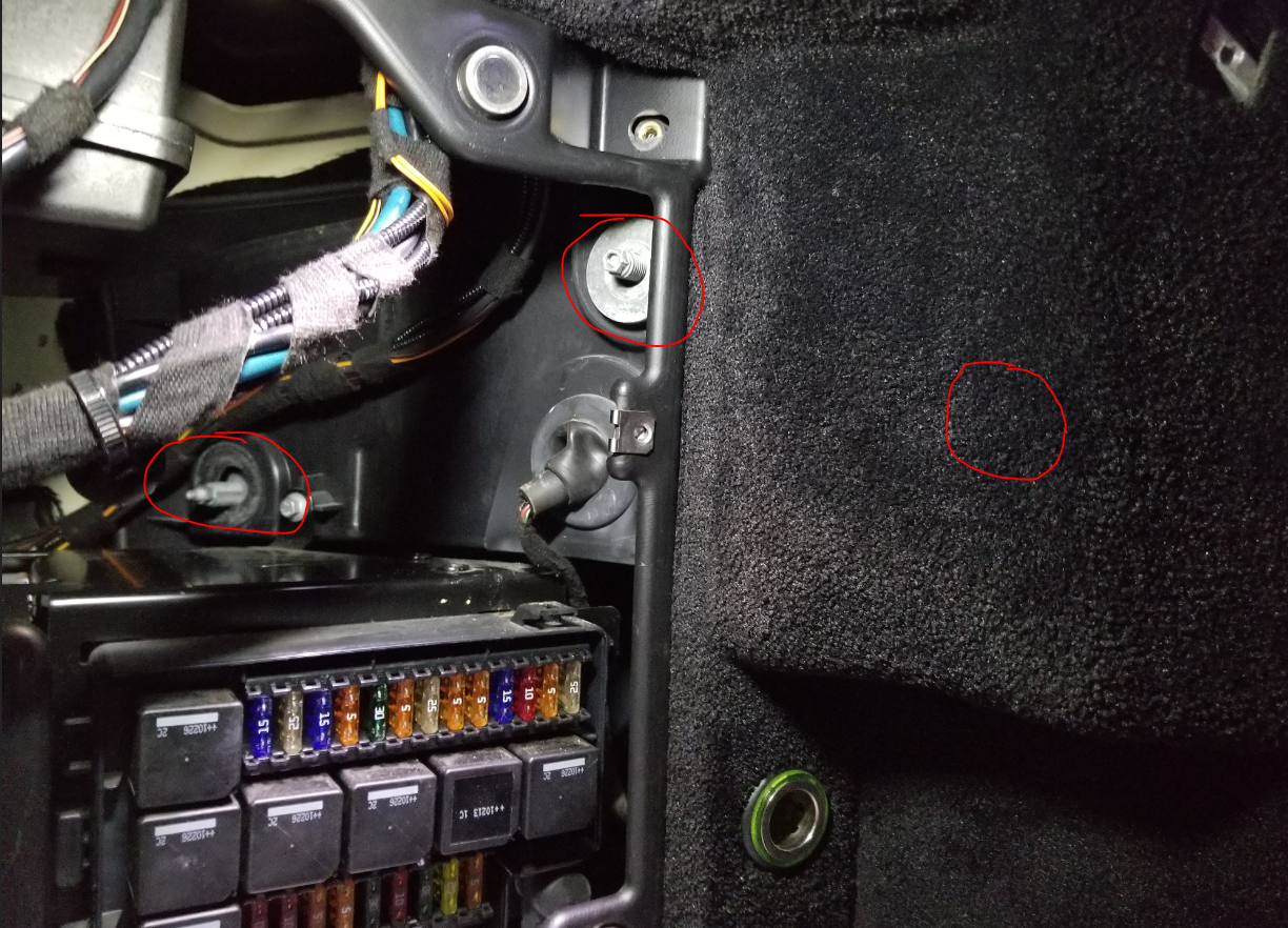

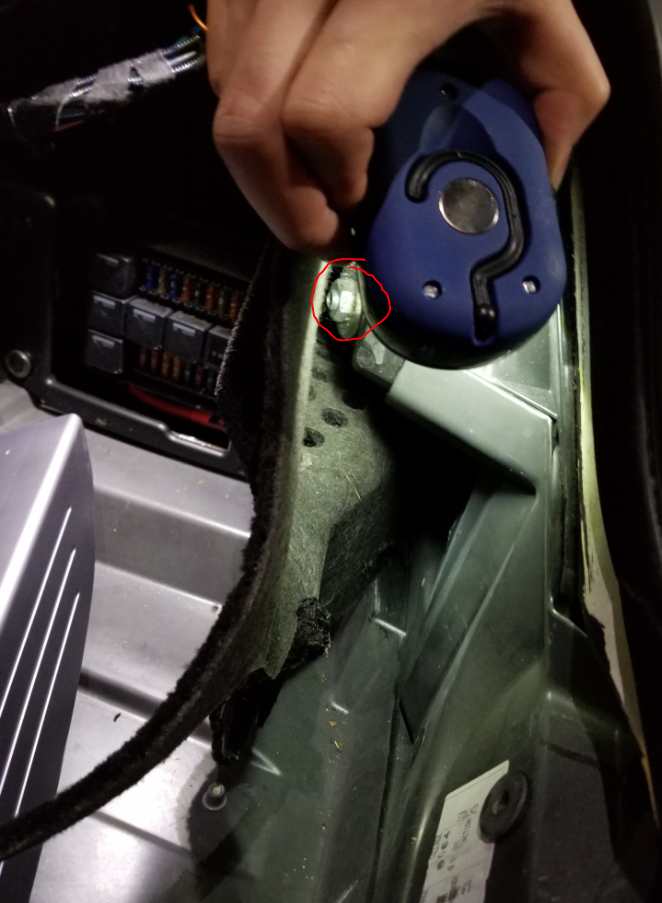

Thanks everyone for the responses. I tried to remove the light assembly and cleaning the connector. It did seem to have a temporary impact (i've added some pictures below to show what i mean), however its gone back to not lighting up when the car is parked. The blinkers and the brake light still works on that assembly. @ccfulton Yes - the parking light is what i meant I don't have any experience working with electronic components, so I'm not sure how to go about checking the wires
Being a Rapide, i think it might be slightly more annoying to access vs DB9 - i'll post some pictures in case others are curious.

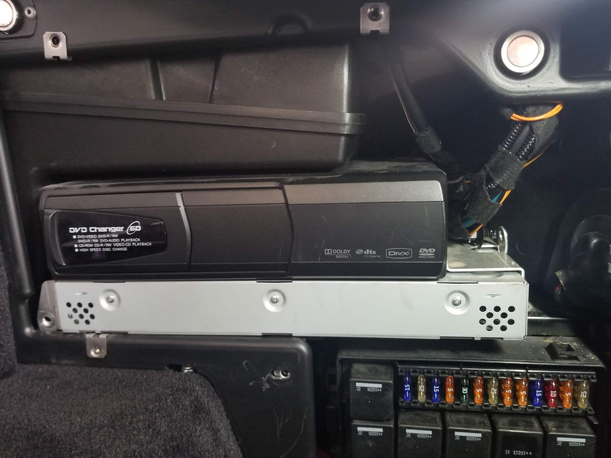

The Right trunk side houses the DVD player, which obstructs access to the back bolt. The unit can be easily removed and moved to the side. Picture 1:
The 3 bolts are located here. Annoyingly the third bolt is hidden behind the carpet trim, and requires removing a bunch more stuff. Picture 2 of the location of the bolts:

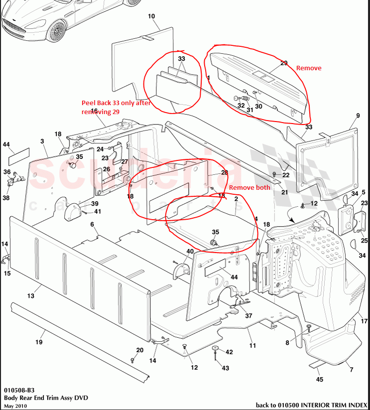

The following must be removed in order to access the 3rd bolt. Picture 3:

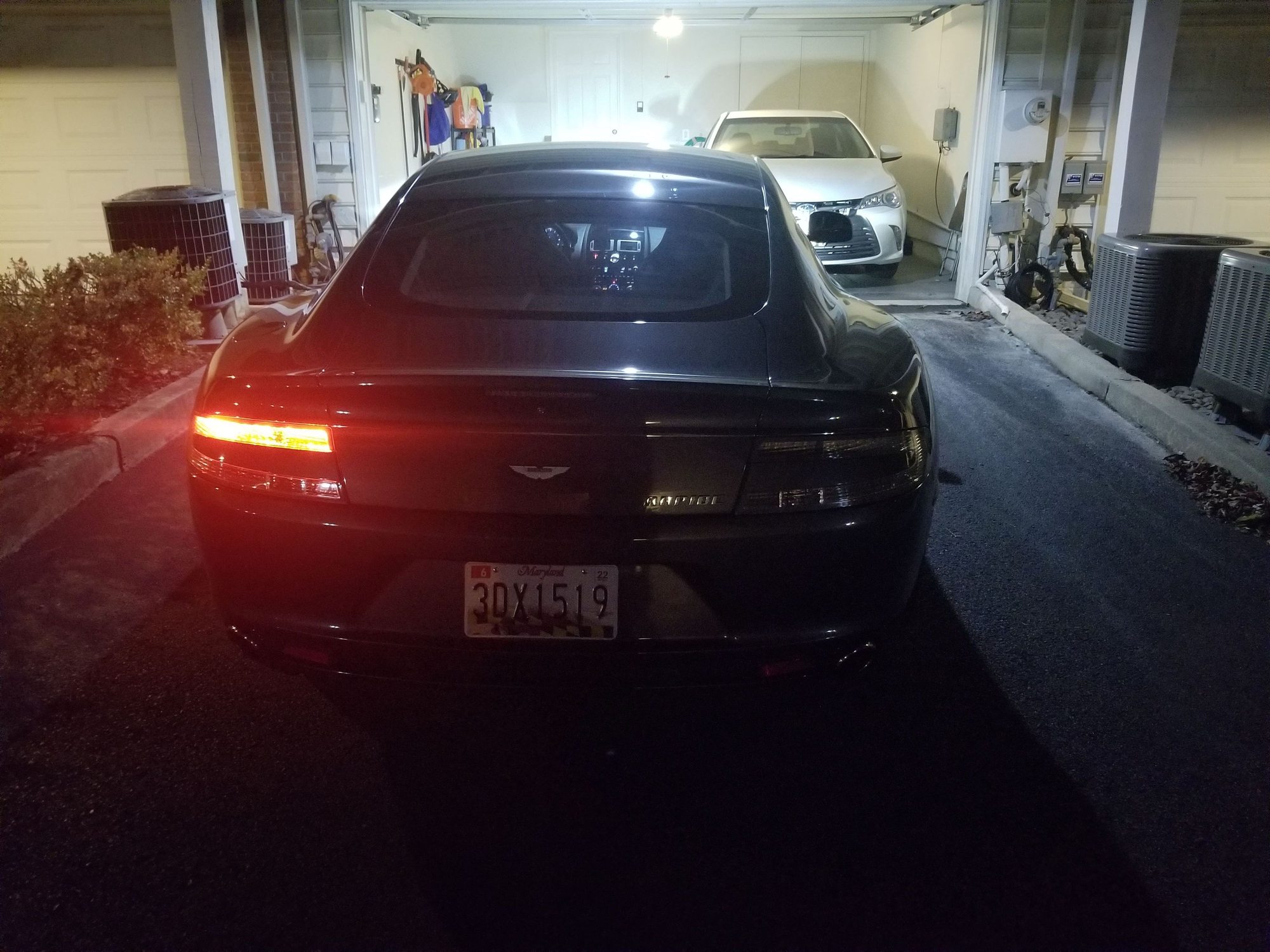

Now you can finally access the 3rd bolt. Picture 4:

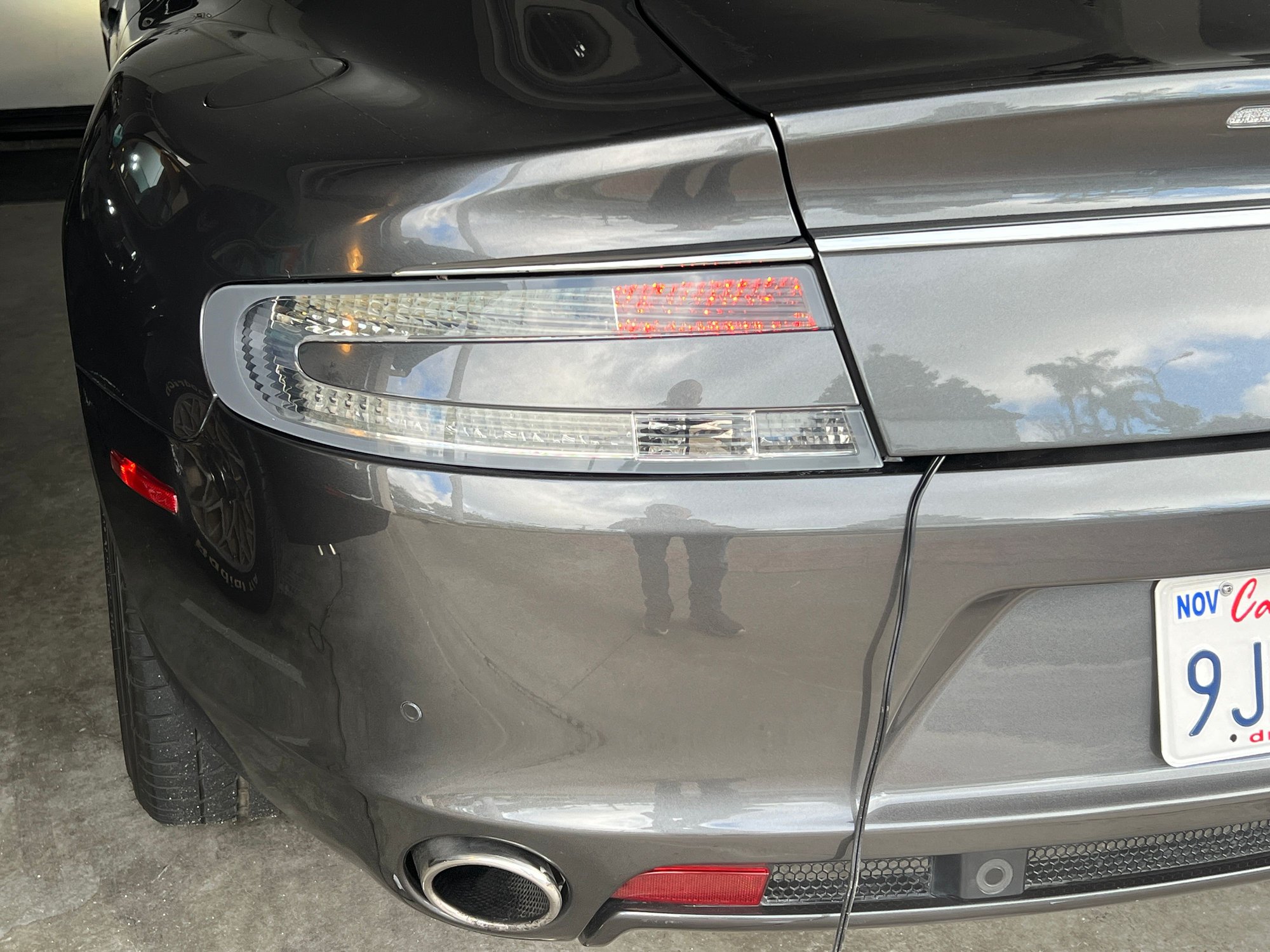

I used an air duster on the connector, and reattached it. It would occasionally flicker back, and even completely back. The following 2 photos were taken on different days.
Its gotten alot colder now, and the parking light has gone out again.
does temperature have an impact? Is it possible its a wire issue?

That it worked for a bit that probably means that the light itself is not dead.
Given your (slight) improvement I would try some electrical contact cleaner on both the connector and the light side. In addition, I would try plugging and unplugging a couple of times to rub off any oxidation.
Temperature could play a minor role but probably not a primary cause.
In my mind, cleaning with a solvent would be the first thing to do, but if it persists, you should be able to turn the lights on and wiggle the wires to see if you might have a wiring problem. IMO that is fairly unlikely if the harness has not been disturbed before now, more likely a questionable contact on one of the pins in the connector.
