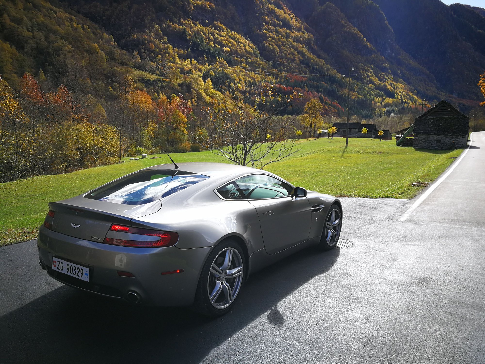

My car is a 2006 V8 vantage 4.3, which I own since 2017. This is my pride and joy:
