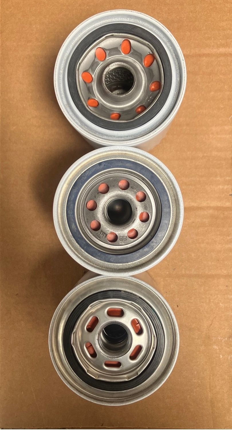

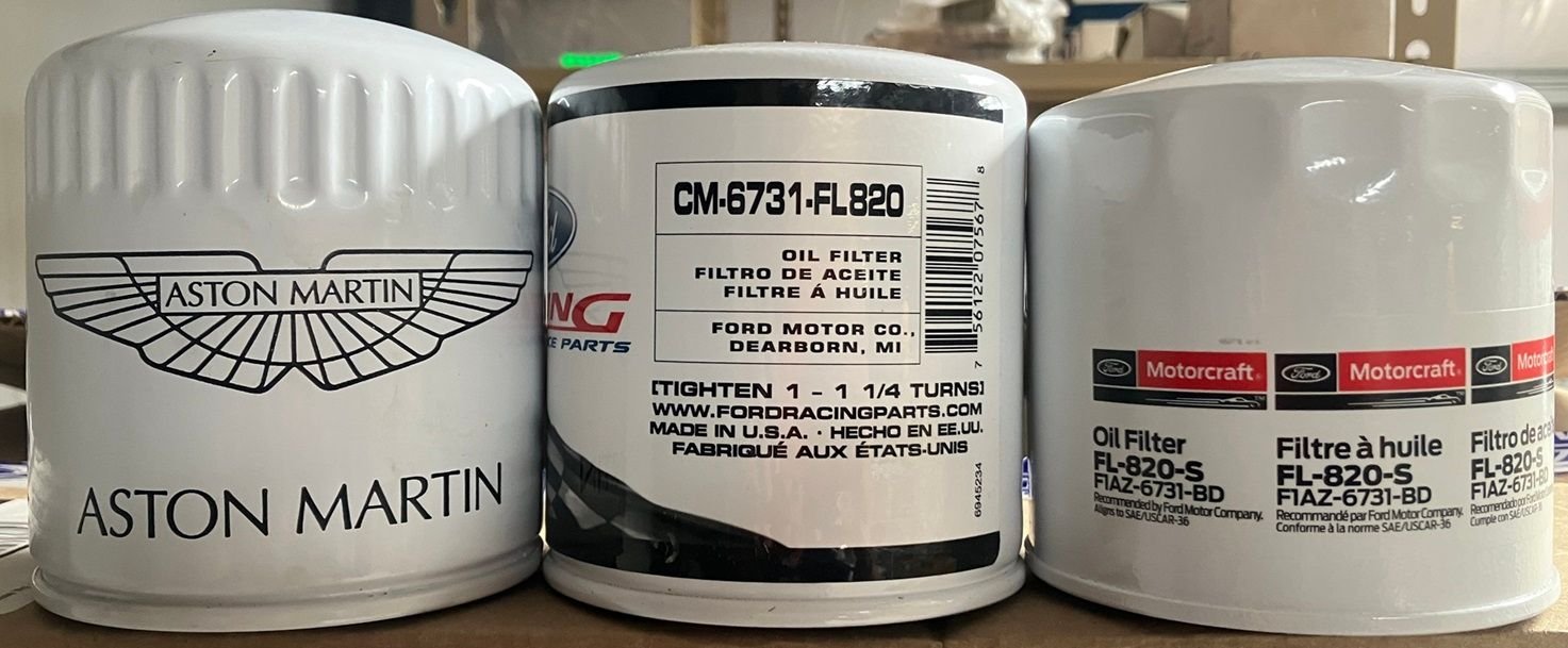

Differences between the OEM (left and top) / Ford Racing (center x2) / Ford (right and bottom) oil filters.

Originally Posted by UltraMarine
Nice Price! However that doesn't look like the Ford Racing filter , but the Motocraft FL-820S.
I bought a couple since it's the best price in a very long time!
That's right, thanks for the correction.
Thank you for the pic's, saved me the trouble of buying them.
Big difference in those oil filters.
The AM filter definitely has more CU opening then the other two, the AM has 8 elongated larger holes then the Ford racing filter with 8 round holes, hence more oil flow with the AM. The 3rd filter i wouldn't even consider on my V12.
Would be interesting to see the interior construction of the AM versus the Ford racing filter.

Why not just buy the AM filter?

There's much better filter out there than AM, and if you're out of warranty there's no reason not to get something that works better at a lower price.
The 3 filters above shouldn't be judged by the number of holes in them, they are flow limited by the filtering media and not the holes!
The Motorcraft FL-820 is OE on cars that have a much more critical oiling requirement than the NA V12 in my car... The supercharged 5.4L V8 it's in is on the ragged edge.
The Ford Racing filter has one of the highest combined flow rate and filtration efficiency @20micron (99% !) on the market, and has some features the AM filters doesn't have at a better price point.
Even other filters like the Wix 51372XP surpass the OE filter specs and you can grab those for $5-$7

Do you have similar specs for the AM filter? I’d be concerned if they didn’t have the same or similar relief valve and back pressure specs.
