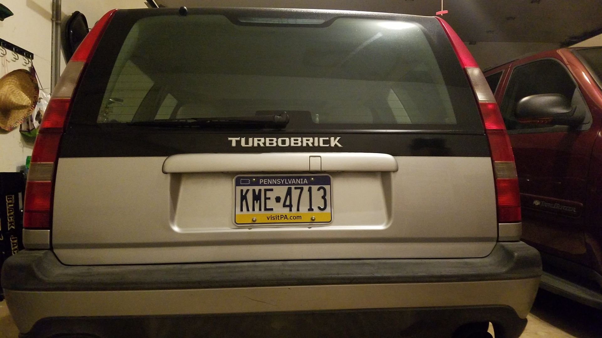

Can confirm dental floss does the trick. I haven't done it on my Vantage but I did debadge the tailgate of a '98 Volvo V70 Cross Country I owned a couple years back. Even on 20-year-old paint you couldn't tell there had been anything there.
After using the dental floss to cut the adhesive there will be bits left on the car. Remove them carefully with your fingernails and use Goo-Gone to clean off the residue, but make sure to wash the area afterward. You don't want to leave the Goo-Gone on the paint.

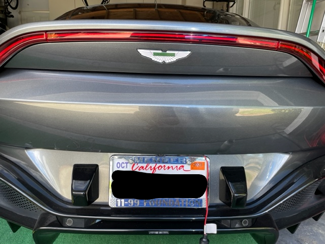

Adding to this thread (from the dead), as it probably isn't necessary to start a new thread for my experience. I have been meaning to do this for a while (my favorite debadge was my e39 Dinan M5) and I have done this to multiple cars, I just like the cleaner look. As shared above, there are plenty of YouTube videos on how to do this, I used dental floss, my wife's hair dryer, Goo Gone and my normal wax to finish things off. Start to end, it took about 45 minutes and I was in no-rush . . . I'm quite happy with the final result:

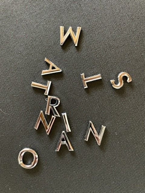

A long, long time ago, I had an Oldsmobile 88 to bomb around. It had separate chrome letters across the rear trunk lid, which I removed. For kicks, I was able to scramble the letters and reinstall. And voila, the BOMSLODILE was born (which it certainly was).
You should try doing the same and see what kind of confusion you create.
How about: Arnott Masin

Scrabble with Friends! If I were Vietnamese, I did notice that TRAN jumped out at me

MARTIAN SNOT?
Nah. Probably not...
