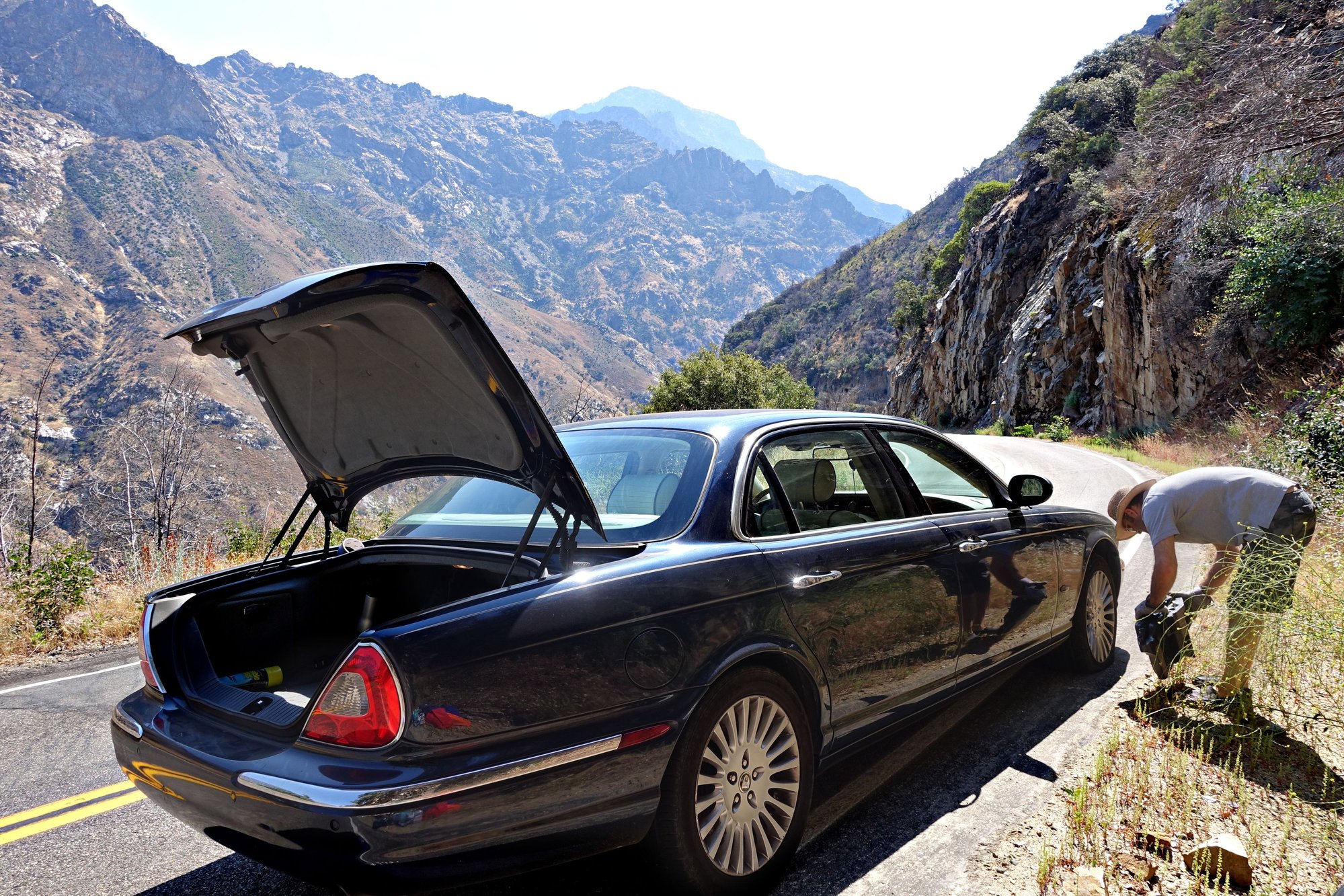

I hit a rock in King's Canyon and took out the front right rim. Literally cracked the rim. Tires these days are way too thin! If I didn't have a real spare, it would have been an utter disaster. In that heat, stranded for hours, no thank you. I have no problem ditching the full size wheel in these conditions.
