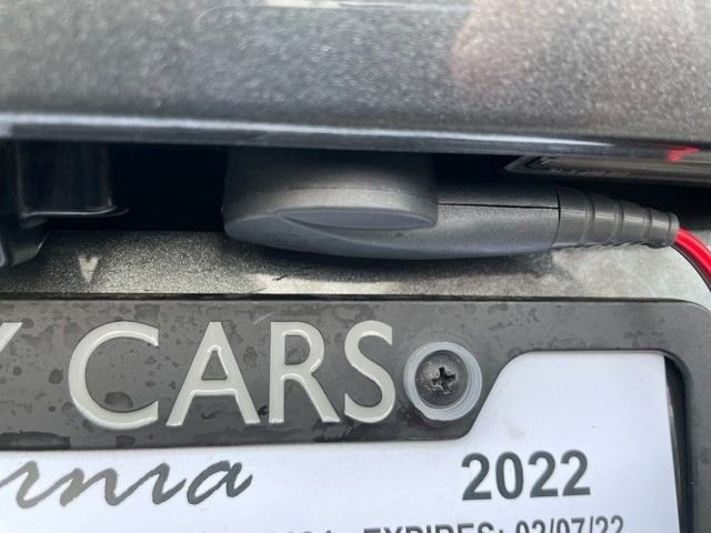

. . . Who knew?! Maybe you all know this, but I stumbled on a YouTube video talking about a magnetic attachment for a CTEK cigarette lighter trickle charger, super-cool. I then found the item on eBay, it was pretty pricey, but I fell for the gimmick The item arrived (early) as promised, but to my chagrin, while the item works perfectly, the spacing between the magnetic attachment and the top of my license plate frame is so close . . . I cannot install the charger without unscrewing my license plate frame; kinda defeats the purpose a of a quick connect/disconnect. I may mess with it a bit more, but that I would warn others of this issue. I will report back if I came up with a clever workaround. KH

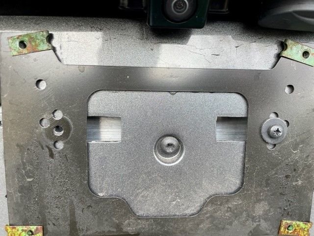

Remove the plate frame and you will have the base bracket that has multiple positions that mount it. Drop it down one position and your clearance should work out.

THANK YOU, it didn't even occur to me that there would be additional installation options on the mounting plate. You can see that it was installed in the middle position (remaining screw), the lower position gives enough space to attach and reattach the magnetic connector. Really appreciate the advice JW, Merry Christmas! KH
