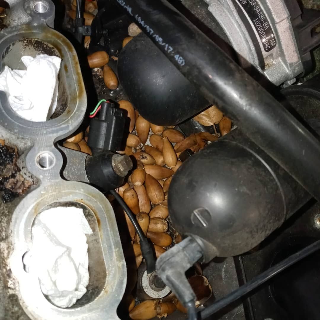

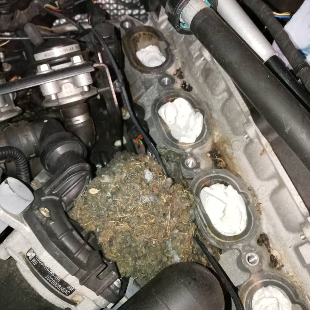

Bastards made a nest in the V of the block under the intake plenum using the stuffing from the insulation pad under the bonnet; also chewed through the 2ndary air pump vacuum line. Nice nuts!

You couldn't see the nest at all under the plenum. I drove the car for months like this before the check engine light came on after the critter chewed the vacuum line. Only symptom all this time was a smell of roasted acorns. I was very lucky the car didn't go up in flames.

They won't chew the wires, however rodent urine destroyed the secondary air connectors in mine, same place as pics above.
