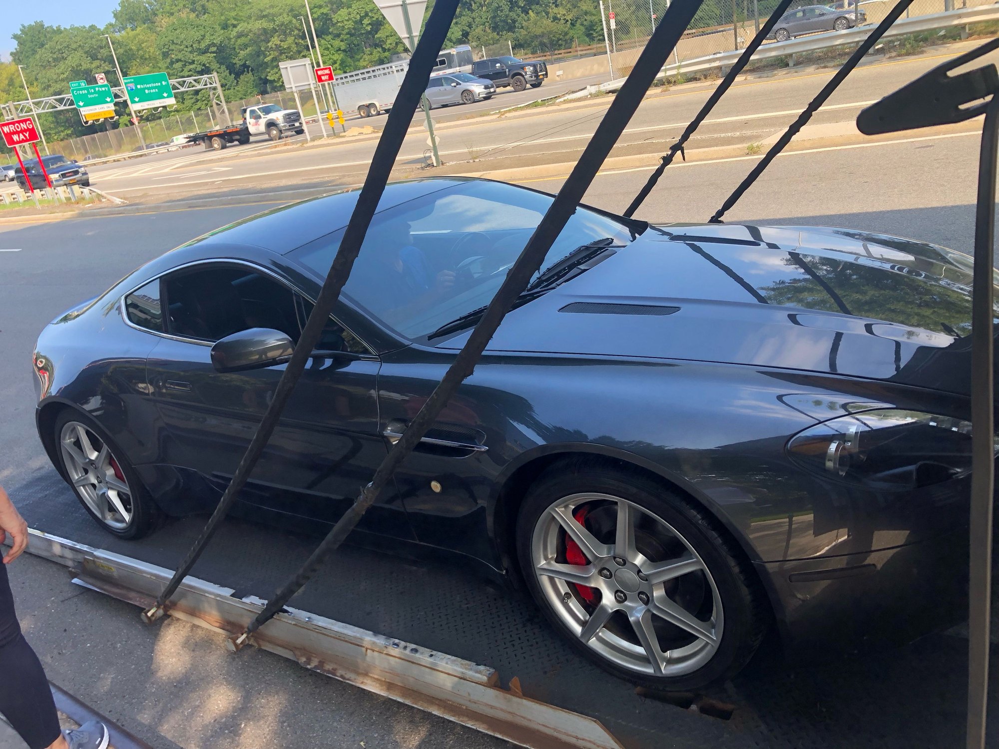

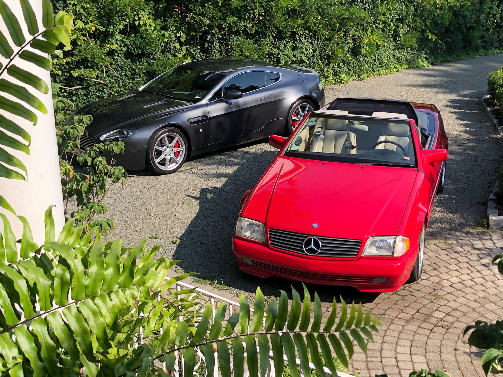

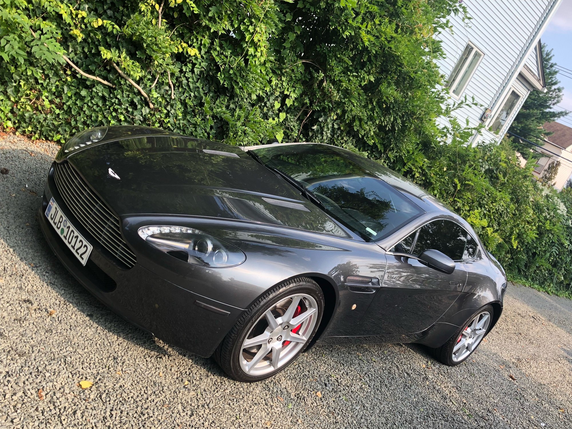

Hi guys -- so I just bought an 08 Vantage Sportshift in Meteorite Silver. High mileage (70k) but in good shape and I got a very good price. Partial service records, clean Carfax, and I had a full PPI conducted before I bought it. Aside from a few minor issues, car has a clean bill of health. I'm confident the vehicle was well cared-for in general. PPI showed 60% life on the clutch and 55% on the brakes.
Anyway I have a few questions about the car and it's operation.
Cosmetically, the side-view mirror stems are a little tatty. Is replacement the only option or can these be reconditioned?
As for driving the car, my biggest concern is preserving the clutch. Are there any tricks for this? I know to keep the setting out of Comfort Mode always and to never reverse uphill. But what about crawl mode? Does that place undue wear on the clutch? I have to say it's a convenient feature in traffic. And when driving normally is manual mode better than auto-drive, or does it not matter? Any other tips?
Only mechanical issue the PPI turned up was the trans oil cooler had a small dent in the top of it, so it will require replacement. I was told the car was ok to drive because there are no leaks and the transmission is functioning normally, but I was wondering if I should cease driving the car entirely until I can get a service appointment (currently a three week wait).
One other thing that's driving a little crazy is a small plastic-sounding rattle in my center console. Nothing is obviously loose anywhere. It's pretty annoying but I assume I'm going to need to have an interior shop open it up and sort it out. It's also missing the forward underbody shield, but that's easy enough to replace.
Otherwise it's all good. Car runs and drives great, sounds great, everything is very tight and snappy, so overall I'm happy. But any advice in general would be greatly appreciated.

I have the same color. Good looking car. Most important thing is to drive the car whenever you can and to have fun. That’s my advice.
