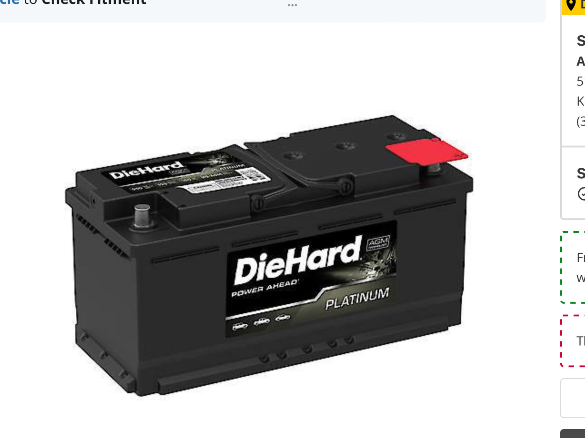

Perfect swap for the OEM battery... it's important that the top of the new battery have the OEM carry handles... the bracket that holds the battery in place is molded to sit behind the two handles. The battery compartment is VERY snug on this MY....

NO! The gold battery wont fit in the compartment due to the top of the Gold battery not having handles.. It wont fit . the metal strap that holds the battery is bent to fit under the fuse box...
the platinum one is an identical fit/size as the OEM. The metal strap sits on top of the battery handles - see pic and handles under the strap... 5 bolts hold that strap in..
Yes, there are signs this MY gives you to tell you your battery isn't holding a charge anymore:
1. When you press the start button and there is a long pause before it cranks.. dash lights look really dim...
2. You get the red "shock stability" message
3. E DIFF light comes on
4. The CEL doesnt go out when car starts up - 2 codes trigger: the CEL triggers a low voltage code and the 2nd fuel pump lost communication... I cleared with my foxwell scanner...
both are still working when the car starts but the CEL wont go out until the battery is charged.. next start up...
part# H9-AGM

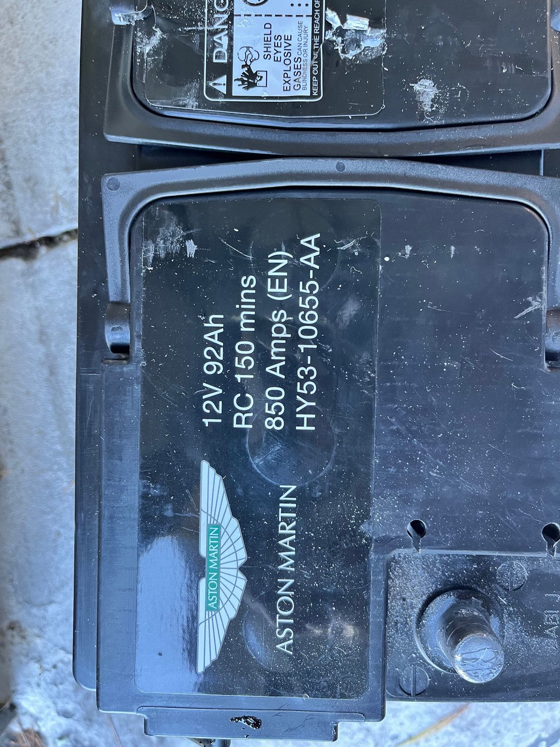

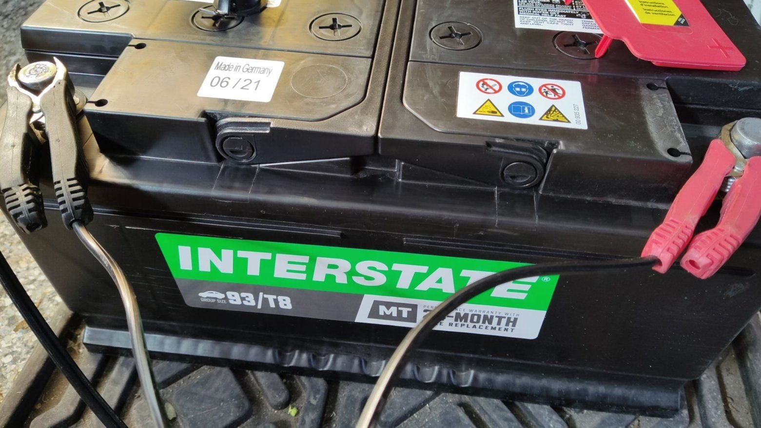

There's an Interstate that does the job as well, and fits like OEM. I don't have the part number handy. When mine died I thought it would be an OEM Aston battery based on mileage, but it was an Interstate and hadn't been replaced too long before I got the car so I was able to swap it under warranty within, I think, the three year period. As a DIY it's not rocket surgery, but it is definitely one of the more obnoxious things to get to, remove, and replace with a lot of fiddling to get the brackets off at the base, and that battery is HEAVY. Redpants has a lightweight substitution and in retrospect it might have made the job a lot more pleasant.

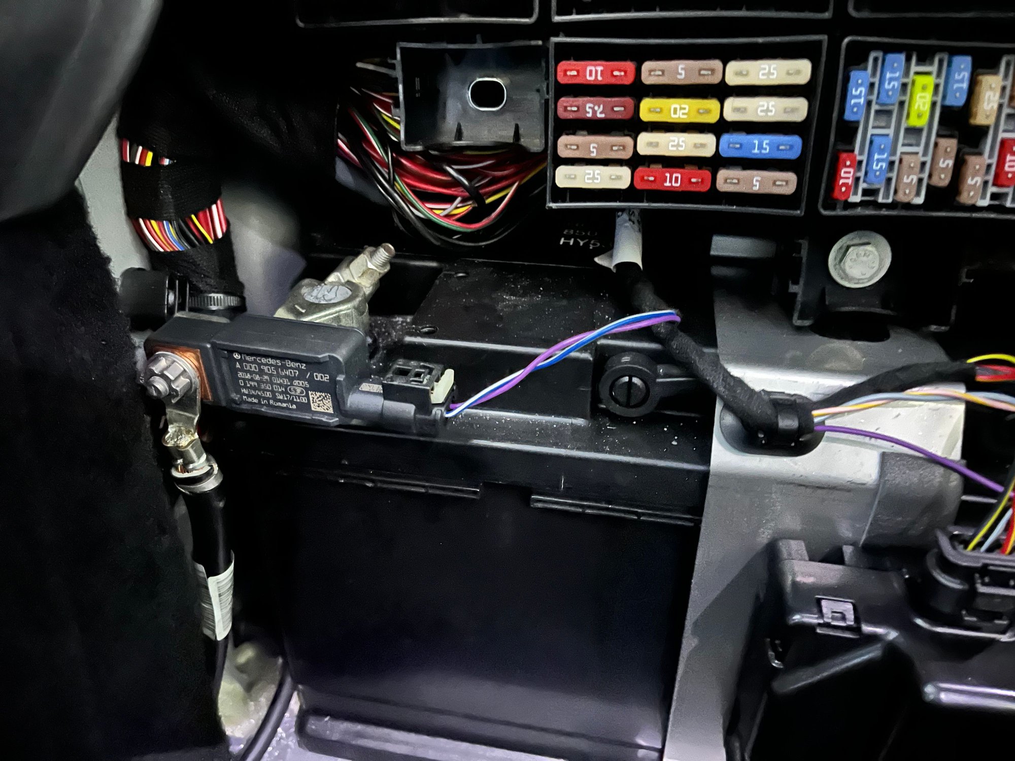

Thank you again, I got the same battery and your post gave me the confidence to do this DIY project. Frankly, it took way longer than a battery swap should, but it will go faster in 3 years, HaHa The one thing that I will add, remove the fuse box (3 very accessible 10mm bolts) to allow you to LIFT the battery out of the compartment. I tried sliding the battery straight out for a bit, but once the fuse box is out, you can lift the battery over the wire harness fray-- KH

Interstate battery should be MTX model which designates it as a AGM battery which is a requirement for stop/start vehicles.
