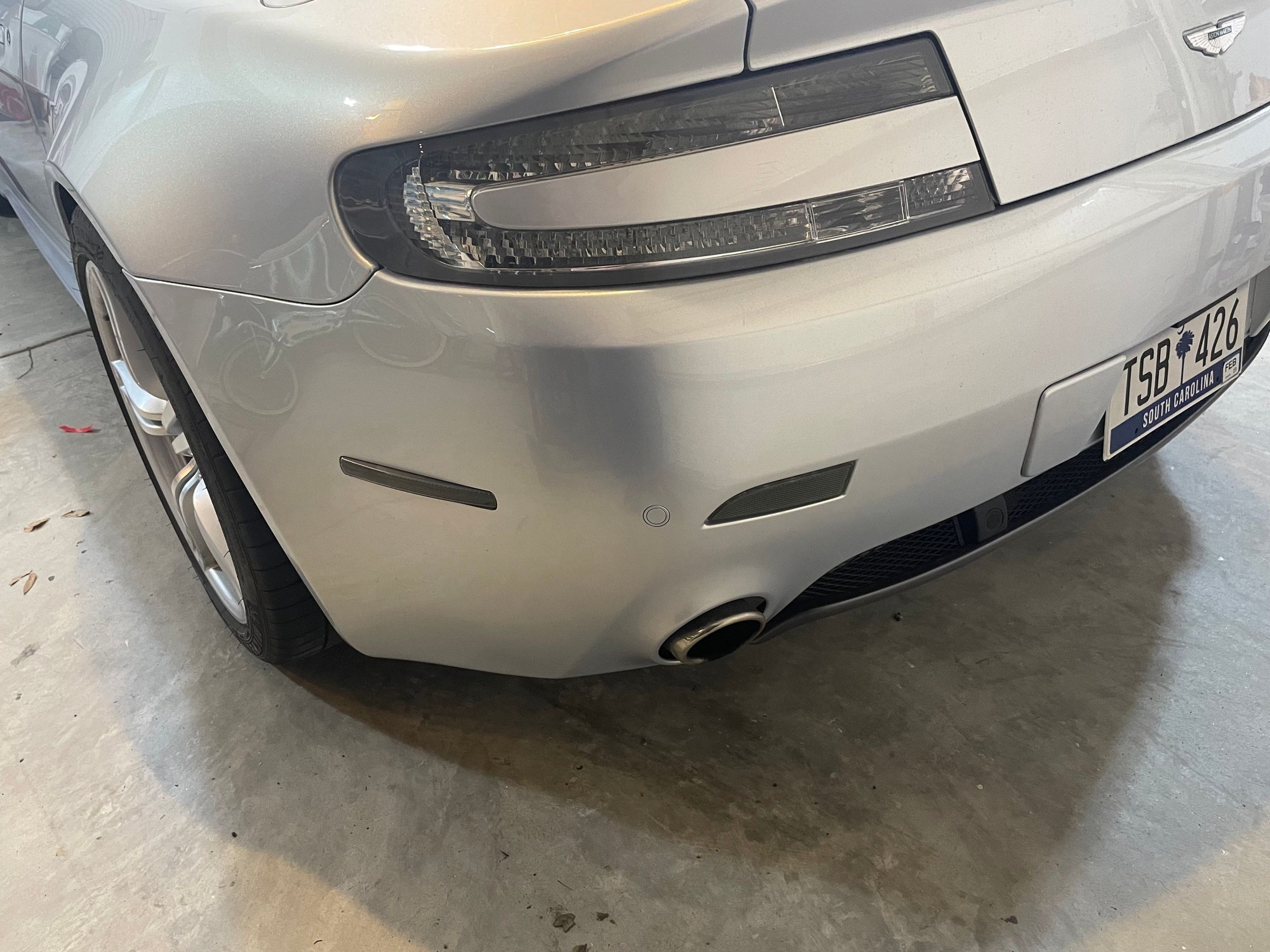

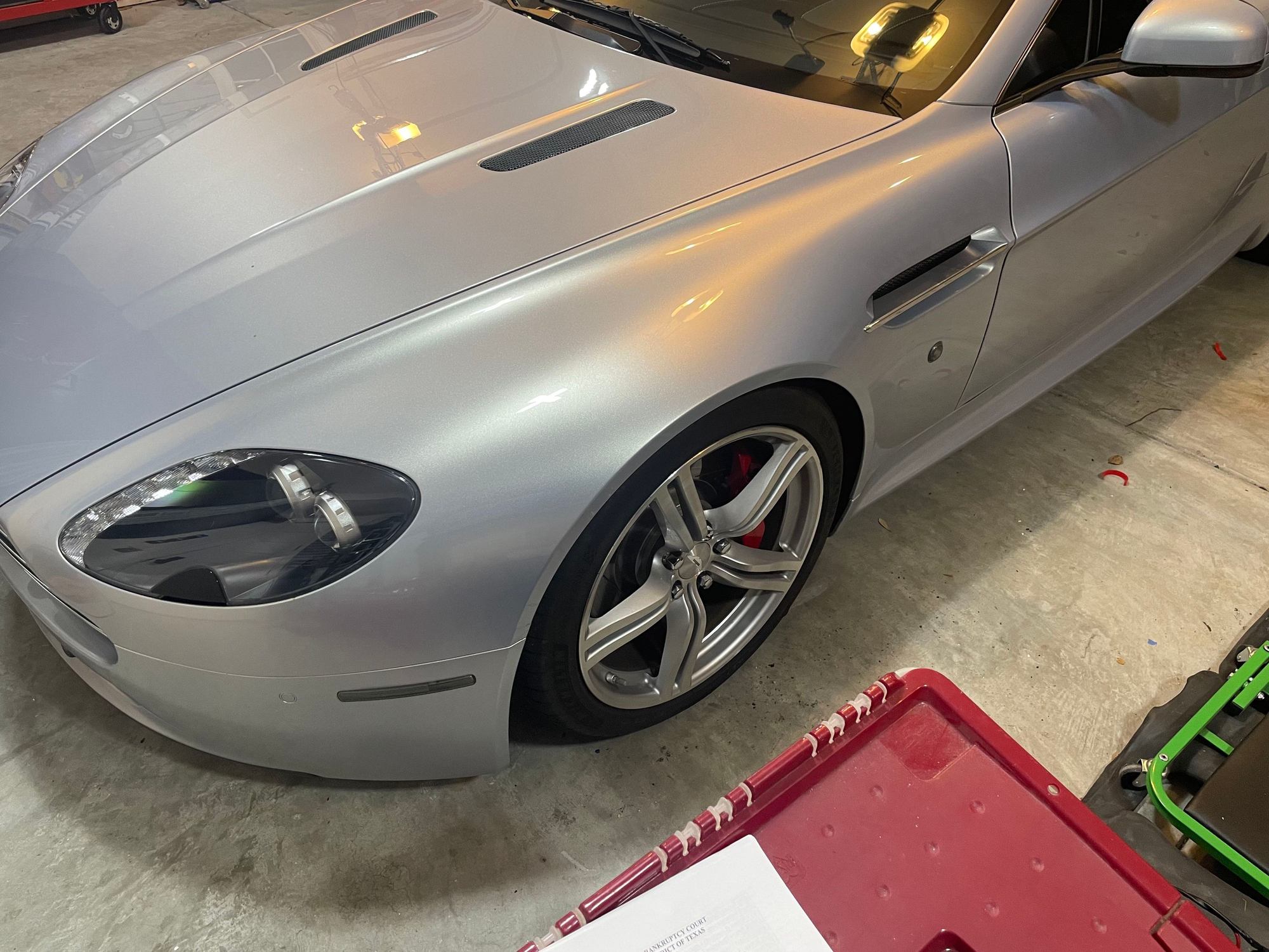

Here is the fruit of 37 hours of work.

It looks a lot better, doesn't it? But yeah, a difficult and time consuming process, especially in the rear fenders!
I posted on this a few years ago when I did it. Have Klearz improved their quality control? I had to take a Dremel to mine to get rid of some ugly flashing and excess glue around the edges - ridiculous.
Unless I missed it, you didn't mention if you kept the OEM bulbs or went for aftermarket LEDs. I did the latter from SuperBright LEDs and ran into clearance issues with the side repeaters/indicators (bulbs about 1/2 mm to 1 mm too long). They look much sharper, though.
