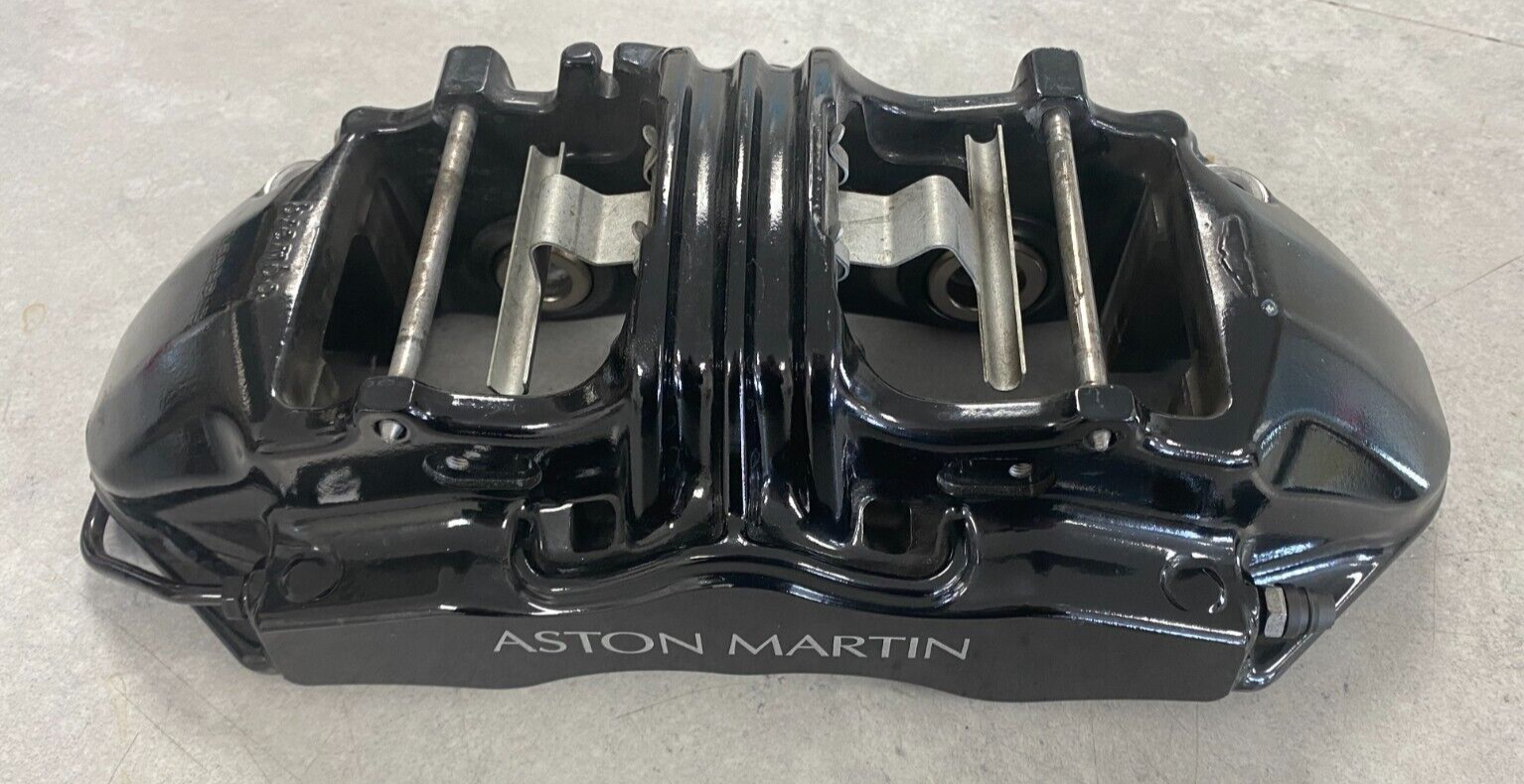

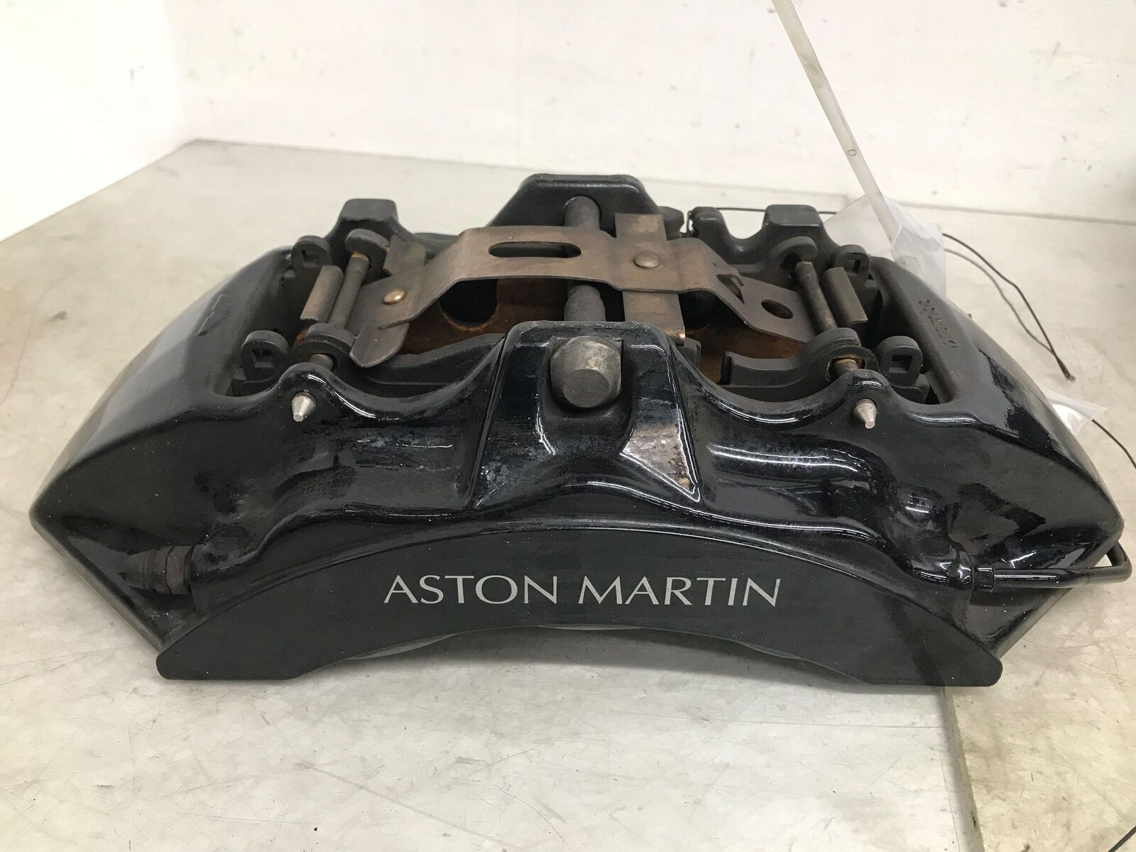

There are 2 different 6 piston calipers
for carbon disks (with the casted bridge over the top of the caliper)
this one has 230mm bolt distance.
for steel disks (with bolt on top of caliper = pads can be exchanged with caliper in place).
I BELIEFE (not sure) these calipers have a different bolt pattern.
Stock 4 piston caliper has, as you said ~180 mm bolt distance.
I have seen pics where the carbon brake calipers were mounted with an adapter like this:
An adapter like that would aprox match the 180-230mm bolt pattern distance.
The steel disk calipers seem to have a different bolt pattern MAYBE 200ish mm, and they require (for the V8V) the hubs of the V8VS to be mounted properly.

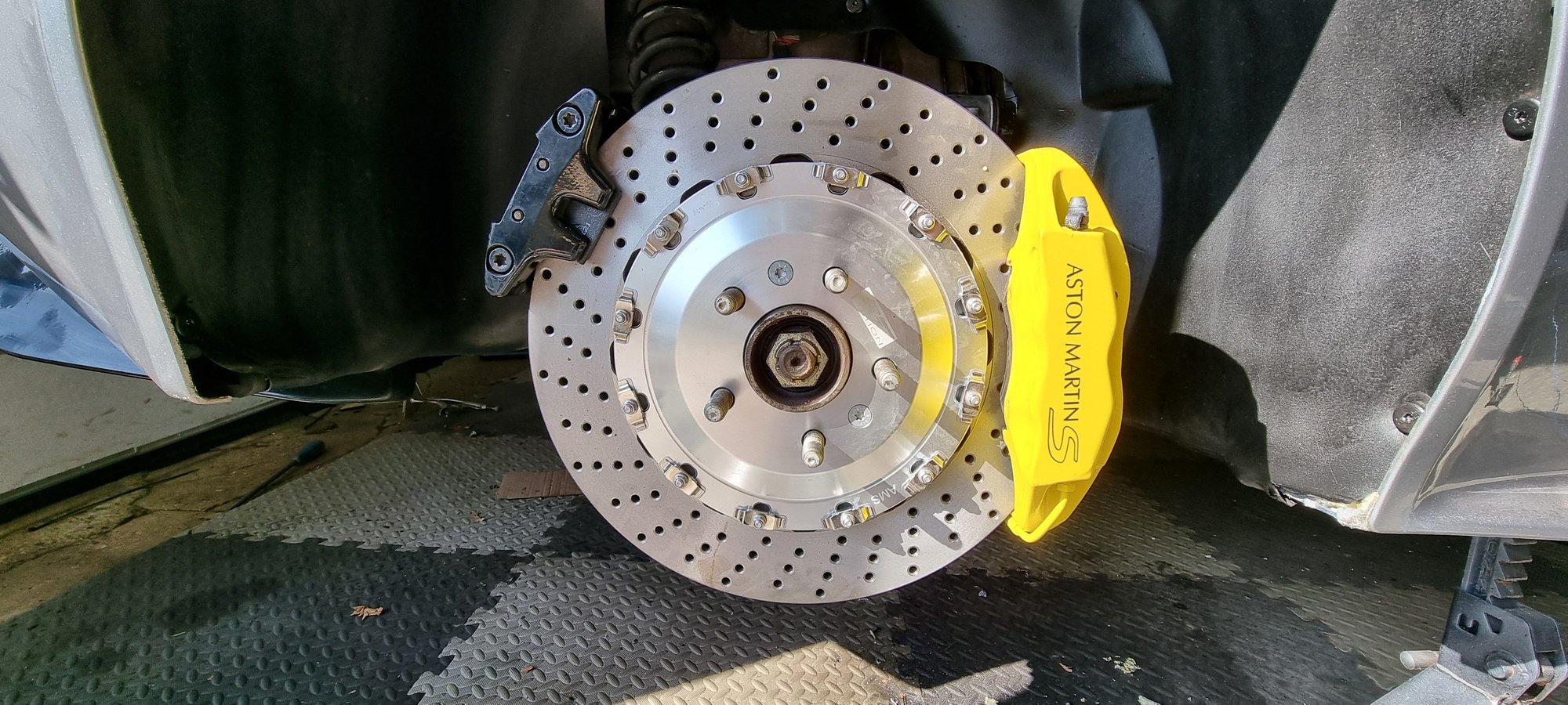

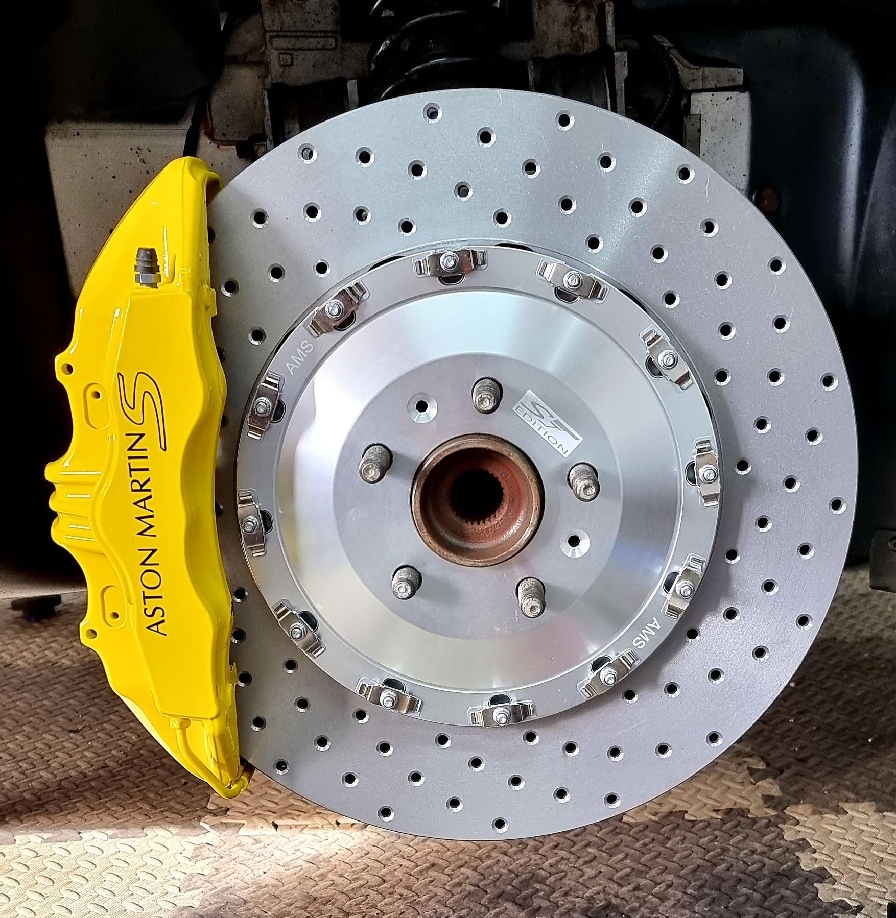

I upgraded my 2006 DB9 brakes to the Carbon 6 pot fronts with 410mm 2 part discs and 380mm 2 part discs on the rear.
Braking is hugely improved, never hneveull.confidence in the original DB9 brakes.
Information below
https://db9s.com/db9-upgraded-brakes/
Christian
