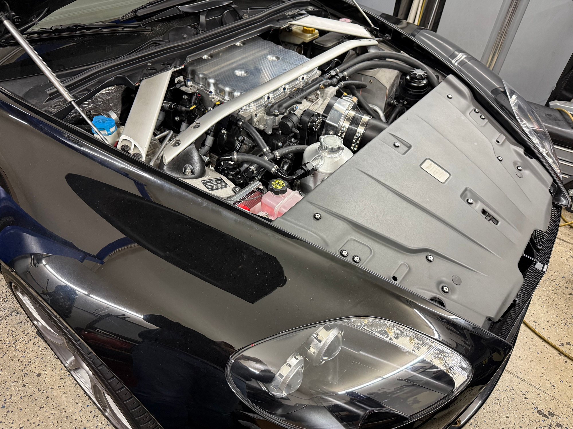

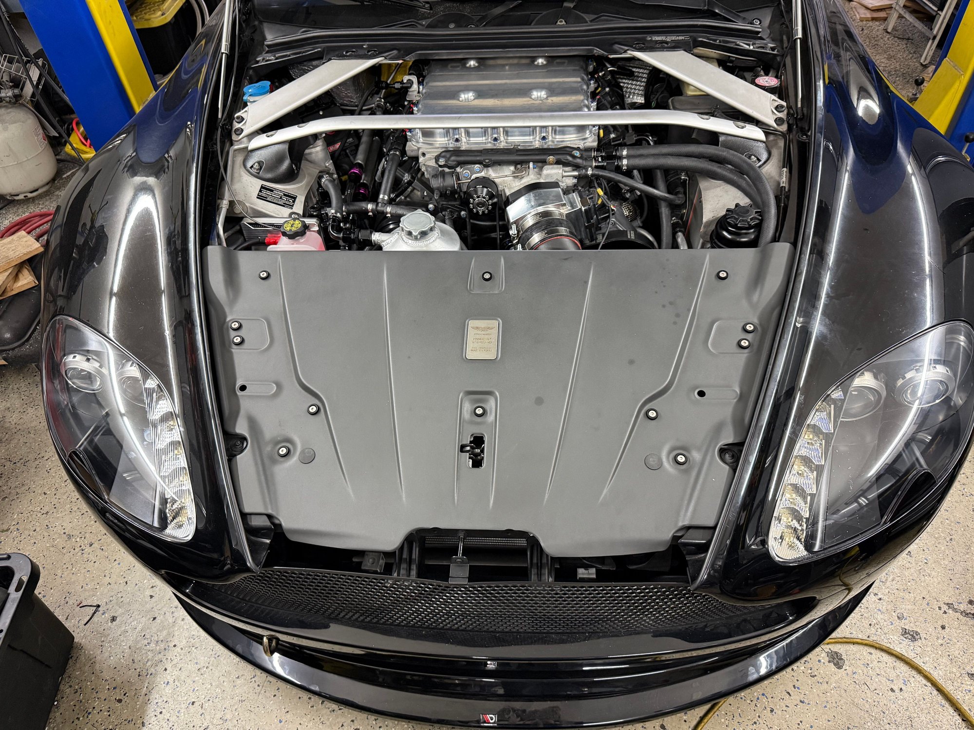

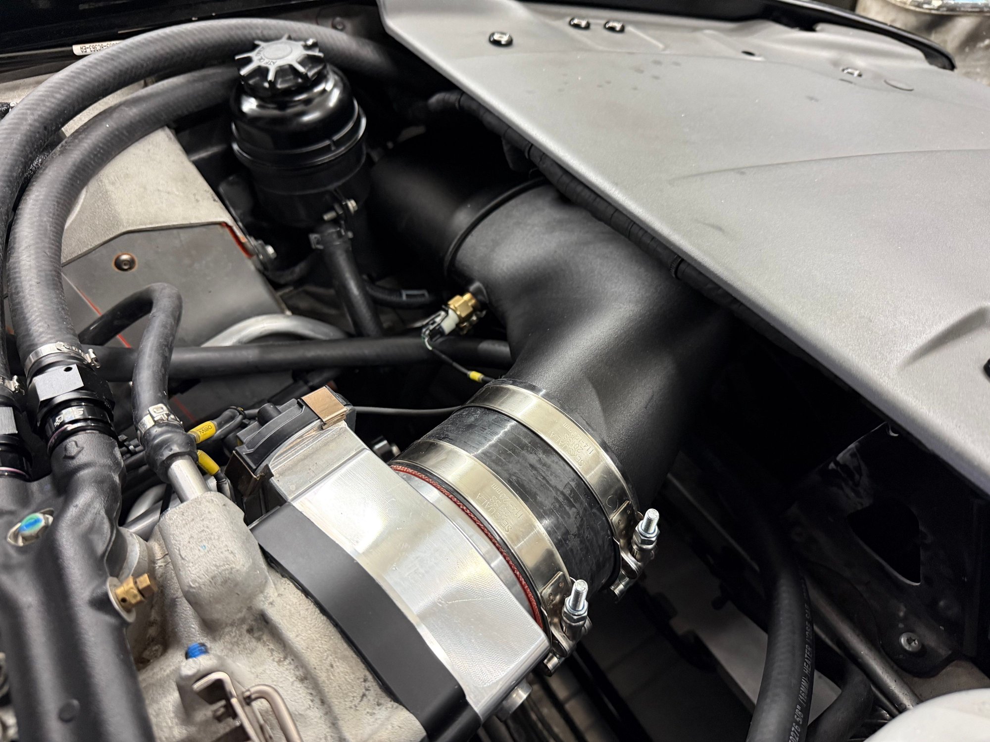

Some pictures of status.
Here's the changes for this season:
1. Ported blower (Jokerz)
2. 103mm Nick Williams TB
3. Custom 3d printed intake with bellmouth/new filter (printed in Nylon PA12/CF).
4. Apex PDM (see previous video) for front chassis power management/CAN gateway functions.
5. Front fusebox delete (due to PDM) - Redid bracket to hold Motec PDM and a bus bar power distribution system.
6. New fuel hardlines for low side fuel system.
7. New heater hose system with Dyme quick connects.
8. XDI "Goliath" high pressure fuel pump.
9. XDI +50% high pressure fuel injectors.
10. Custom in-dash LCD integration.
11. Changed intercooler hoses from 5/8" to 3/4"
12. Larger front mount heat exchanger.
13. Brushless PWM intercooler pump.
14. Upgraded a few sensors from GM OEM to new Bosch motorsports pieces (easier to calibrate accurately on the Motec).
15. Moved to "oetiker" style clamps in the engine bay.
16. Converted steering rack to AN fittings/redesigned hoses for better vibration mitigation.
17. Insulation/stainless shielding on the headers.
18. Redid exhaust "X" pipe to "Y" into 5" oval then "Y" back to dual. This sounds VERY good so far....
19. Carbon bucket Recaro Pole Position seats with custom upholstery.
Probably other stuff.
