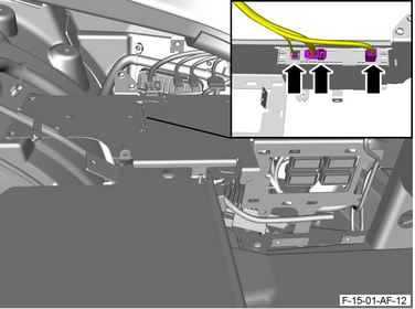

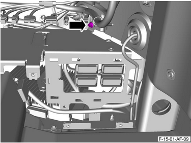

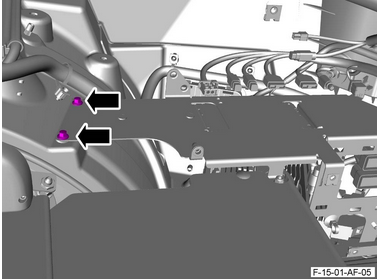

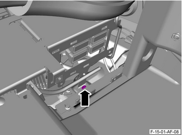

Then you can put aside the 2 electrical harnesses (3 + 1 clips) and unplug the 3 connectors from the SDARS tuner:

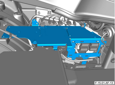

And finally you can remove the whole bracket:
From what I see, I believe you will have to remove some more carpet before you can remove the bracket.
Hope this helps. Good luck!
