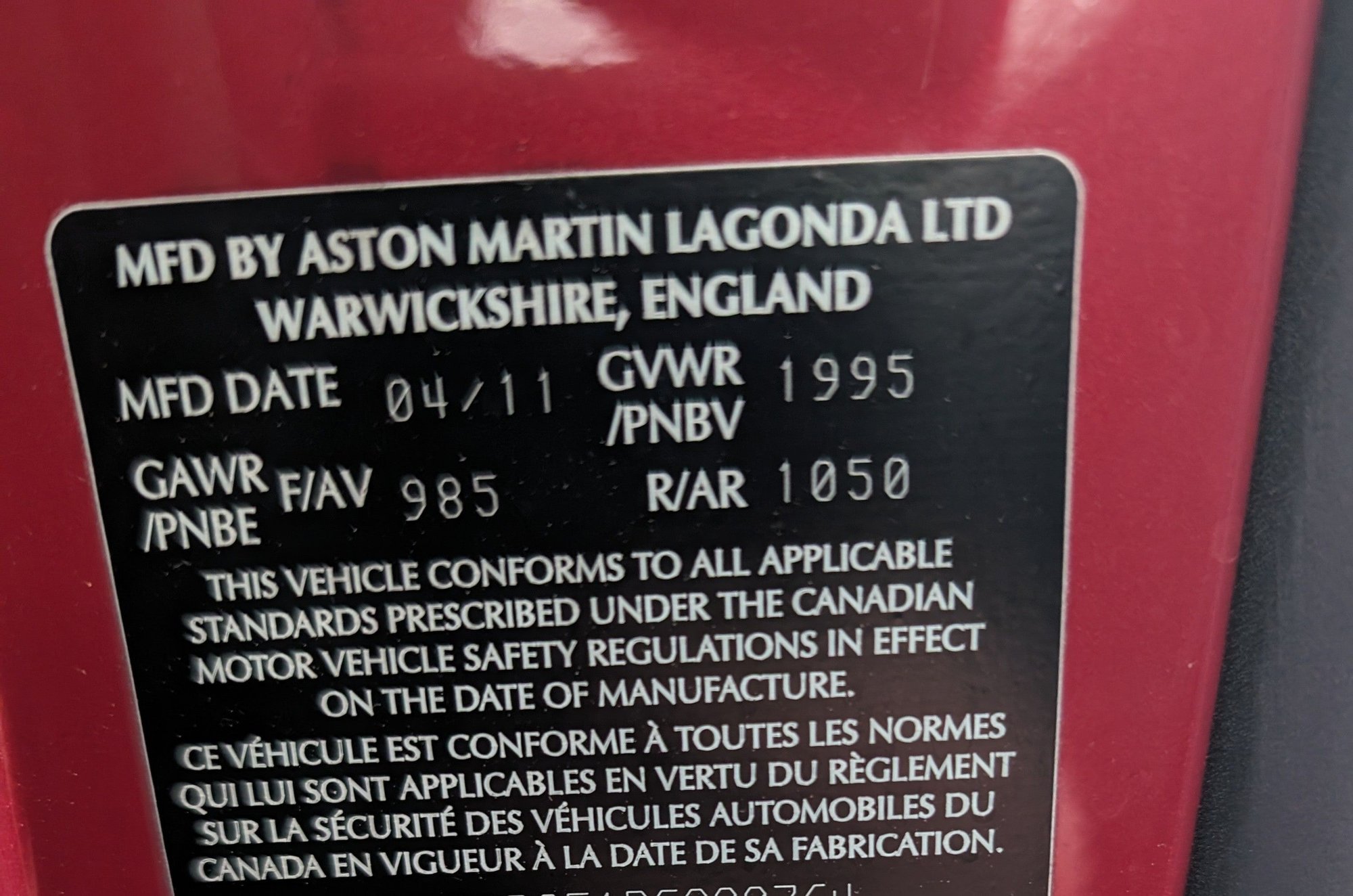

Just got a 2011 V12 with 6 speed, ( big brother to my 2013 V8 manual)
just going through some things, I noticed odometer is showing in KM, according to Carfax report car was purchased from dealer In California & shipped to Canada. So, I'm wondering if there is way to change kmh to mph on odometer? or do I have to go to dealer? I know I can switch on rpm gauge display to mph reading by holding READ button & tapping stalk on left side, but that doesn't change odometer.
according to door sticker it shows car was made for Canadian market.
Thanks

It needs to have the configuration file changed at HQ, Gaydon then flashed with the new file at a dealer.

Thanks @J doubleU for the info, sounds like I have to cough up some $$ & have to go through dealer only.....

Interesting. I can't recall exactly where I got this data from, but I believe there were only 19 V12 Vantages produced for the Canadian market.
Great color too btw! Enjoy.
